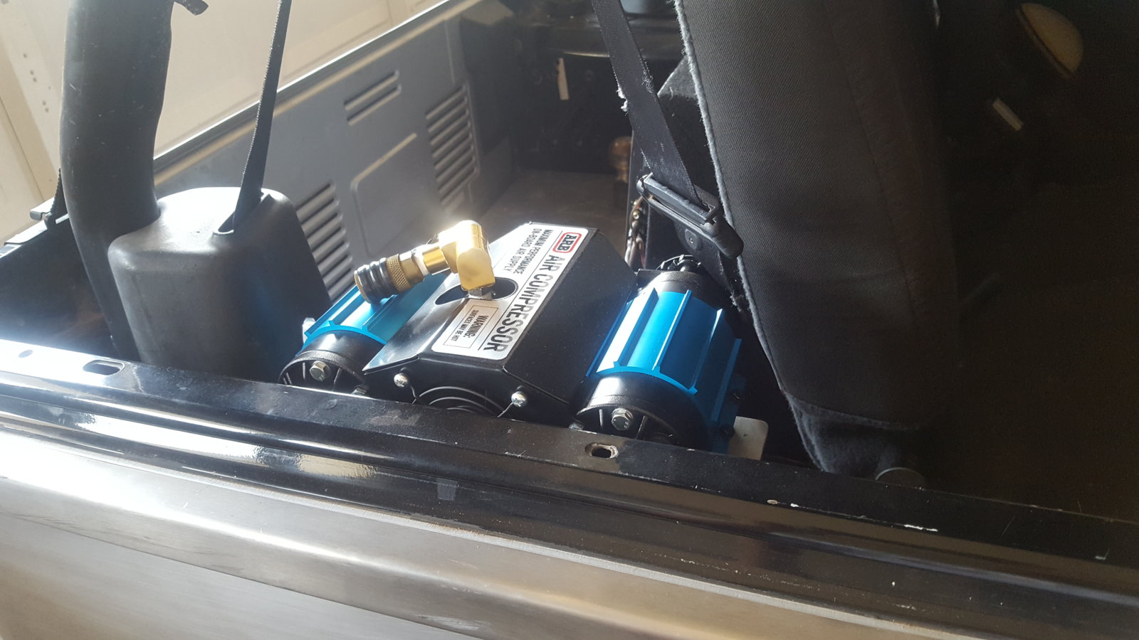

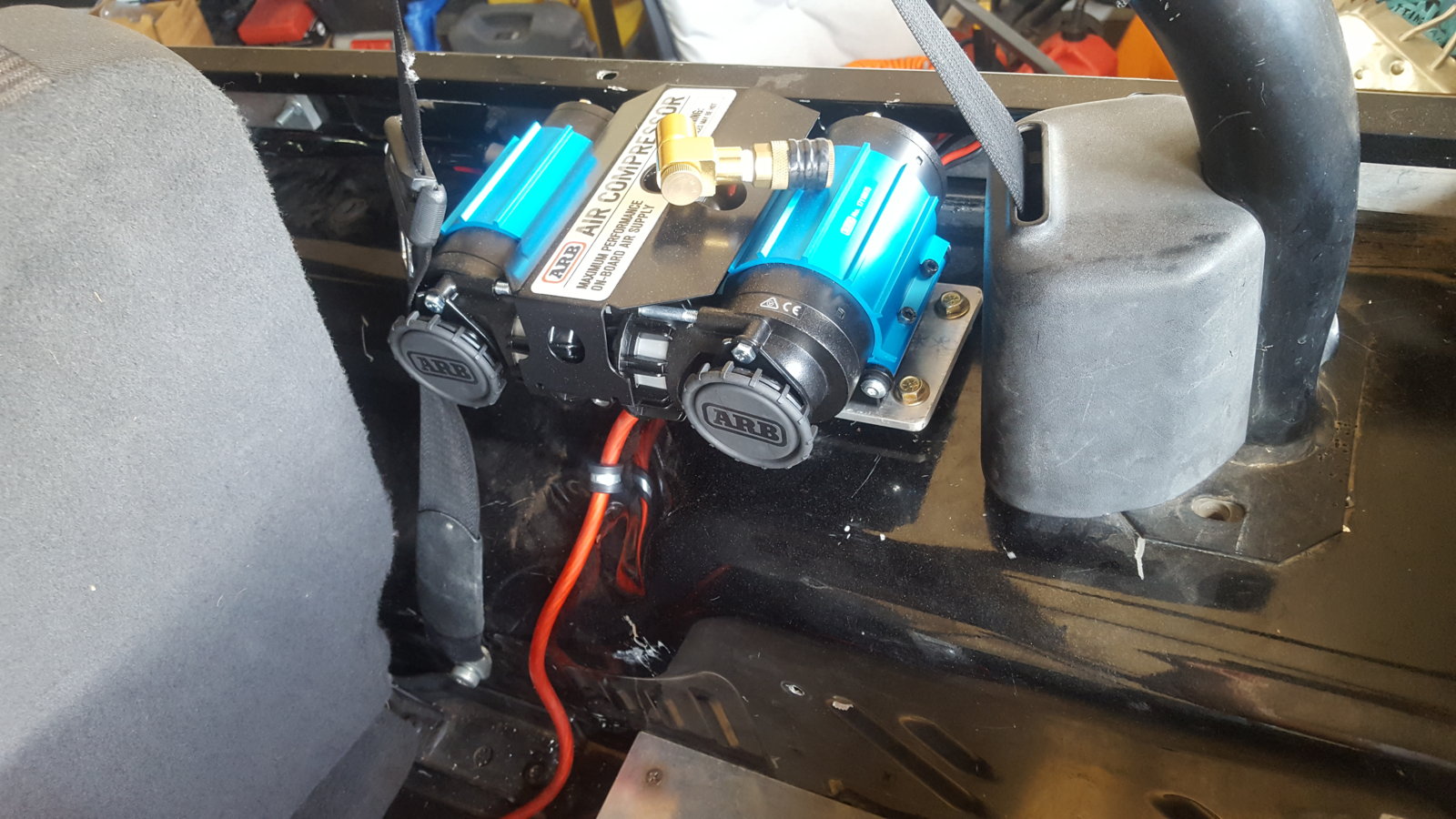

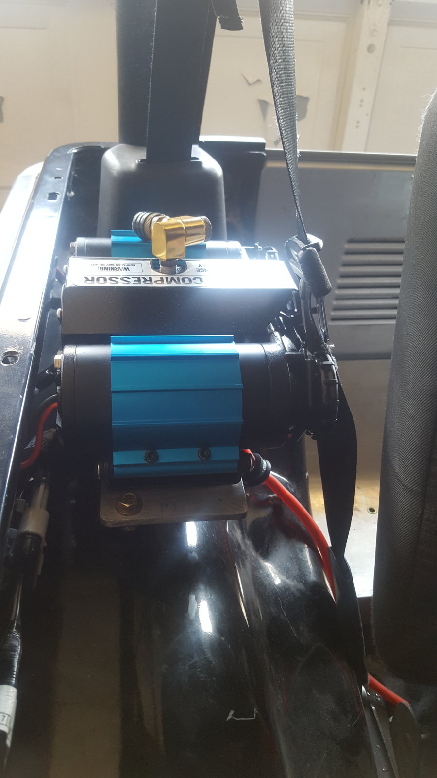

I've tried and had just about every "on-board" air setup there is. Converted AC compressor, 10lb Co2, 20lb Co2, Viair w/5lb tank. I hated all the plumbing associated with the converted ac compressor (separator, oil, tank) . The Co2 tanks were fast but take up too much room and I wheel often so required constant refills (not to mention people who always want to "borrow" some on the trail). The Viair was ok, but slow and tank took up way too much room. I have a dedicated ARB CKSA12 mounted on the firewall solely for air locker duty. I currently run the ARB CKMTA12 for tires and tools. It's 100% duty cycle makes it worth the $$ for me. I typically air down to 6psi on the trail and back up to roughly 20-25psi for the street on 40" tires. It's not as fast as Co2, but I'm usually still putting my gear up before anyone else. (Ignore the big red power wire) :D it goes to my sub amp.
I installed a nice swivel chuck, and can reach all 4 tires with a single coil hose. View attachment 41293 View attachment 41294 View attachment 41295

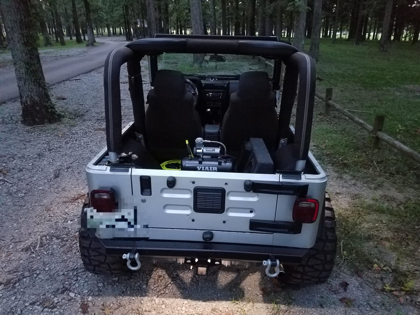

Still using the Viair 88P. But many times I just drive home and use the garage compressor.
