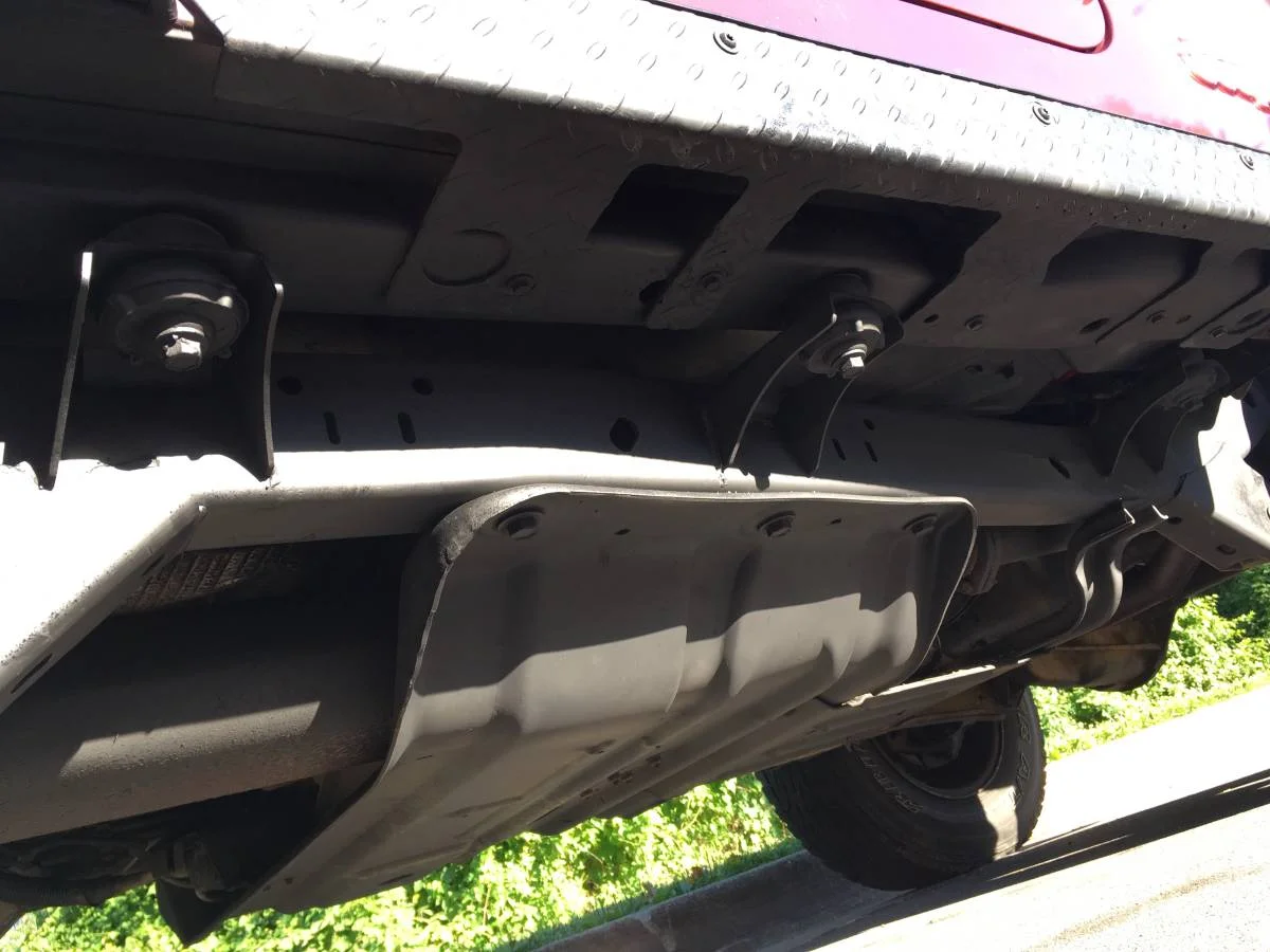

umm lets see what has me worried is that the frame was painted all black so dont get me wrong it looks nice and clean and in perfect condition but d you guys think thats a no go ?
I paint all of my Jeep frames to make them look better and not rust. If it's thick undercoating, that's a different story. Surface rust is no big deal and easy to remove.
Frame looks good to me. They did obviously paint it, but I think to just cover surface rust. If purchased you should look into the threads about creating small drainage holes in the frame, but idk how big of a deal drainage is for SoCali Jeeps
i mean i keep looking at the videos and i also went 2 days in a row to go look at the jeep and man it does not look too bad for being a jeep that came from a snow state .. maybe it was a well maintained car i mean idk
and as far ass drains go i mean i wouldnt mind making some but i do live in socal so idk if is a huge deal
