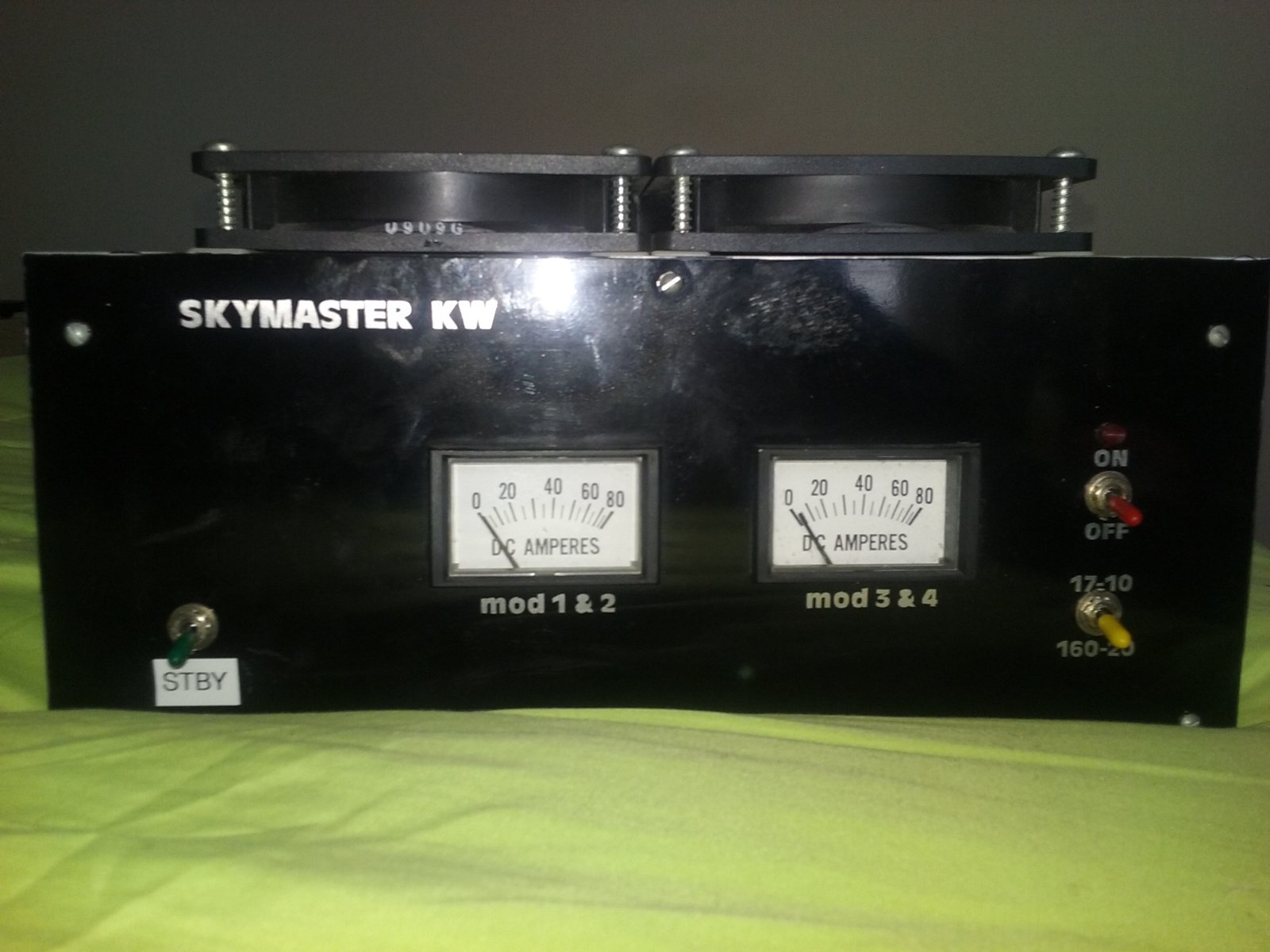

Life's too short for low power...View attachment 54342

Which is strictly illegal.
Running more than 4 watts is not only illegal, it is illegal for a reason. CB channels are very narrow and they are spaced very close together. The more power an AM CB signal is given, the wider its signal becomes. That means more power cause your signal to bleed over into adjacent CB channels which interferes with legal CB users and that really pisses me off when it happens to me. I often have to move 3-10 channels away from some yahoo (asshole) running a high power linear amplifier to boost his CB signal that is splattering across multiple channels just so I can communicate with other Jeepers.
Ham radios are not based on narrow channels, you can run a LOT more power legally because of that and the fact that hams have taken tests to certify that they have more skills that allow them to use more power more intelligently and legally.... as required by international treaties with virtually all countries that govern the use of the radio bands. .
