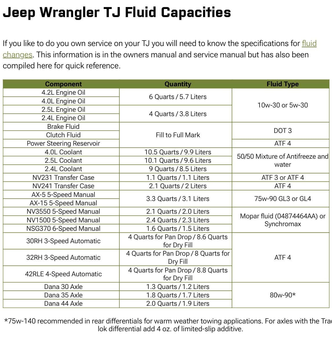

Here’s a list of all the recommended fluids & lubricants for your TJ.

Heres a list of lubricants & coolants for your TJ.
