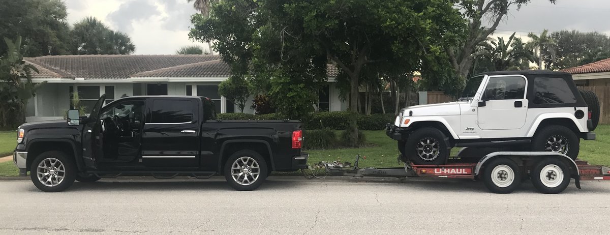

What was your setup like, how was it? Sounds like exactly what @jazngab is planning on doing.

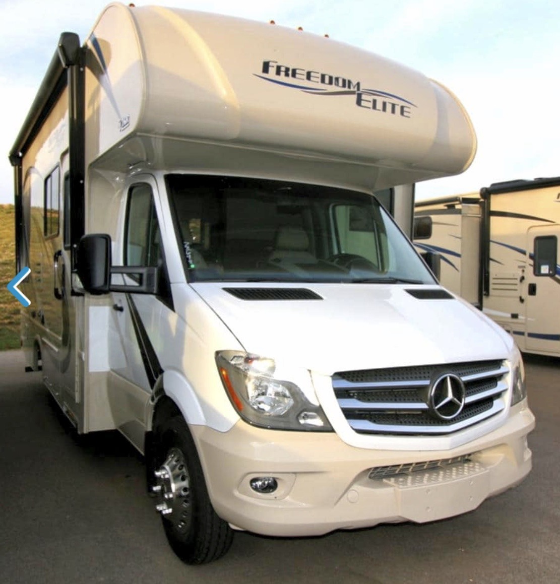

I tow mine 4 down behind my motor home. Sprinter 3.0 V-6

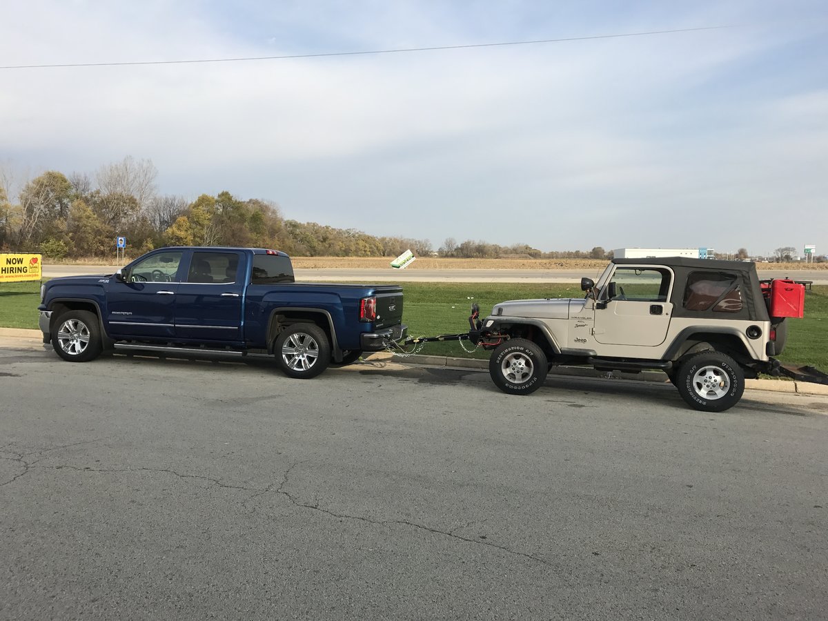

I’ve flat towed my TJ with a GMC Sierra 1500 Crew Cab 4 X 4 without an issue. I am currently looking to add a Brake Buddy next time. Gas mileage dropped down to about 12.5 MPG, from around 19 MPG usually. Barely knew it was back there!View attachment 109342
You have a pretty good height difference on your tow bar. It should be kept to within 3 inches. It looks like yours is close to a foot.
