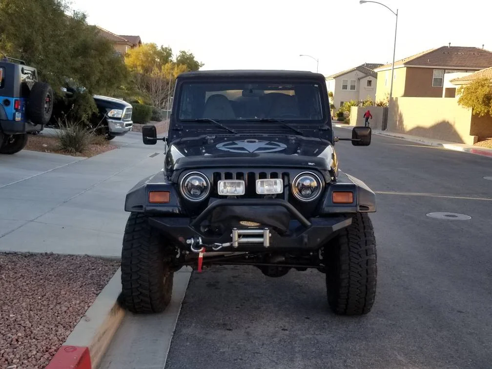

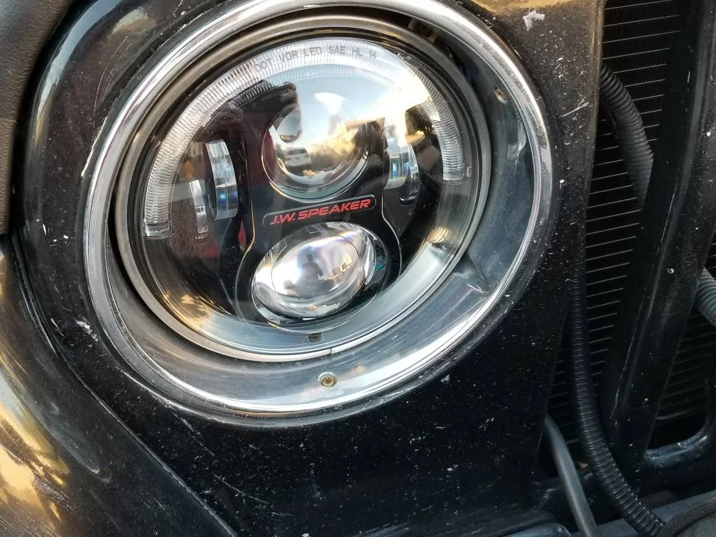

Obviously I'm not Chris but I went the expensive route partially out of stupidity and partially because of warranty and got JW Speaker Evo J2s and love them. I bought the Evo J1s last year for my wife's JK and that's what sold me on them for my TJ. They are insane bright and the low beams and high beams both turn on with high beams on with the J2s so it's like daylight. I got mine for 400 on sale from Northridge 4x4
