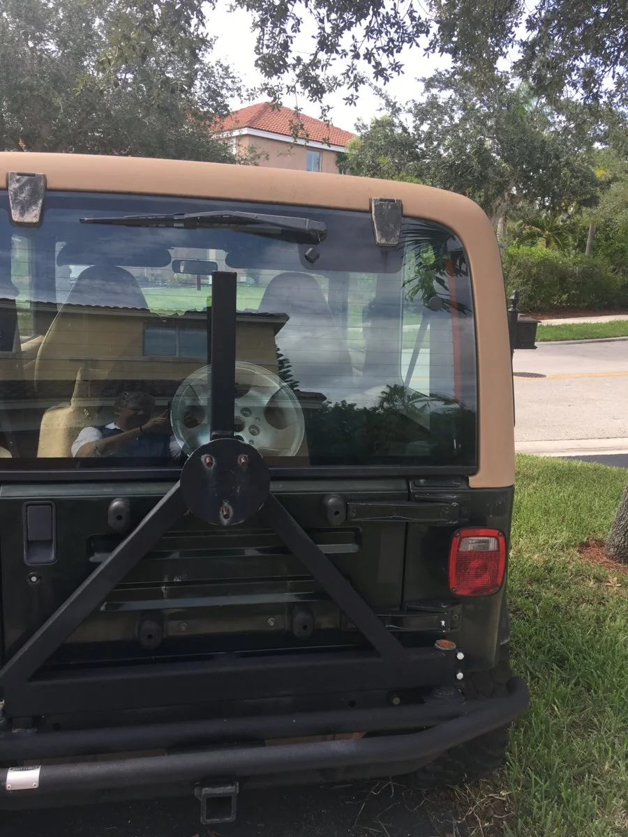

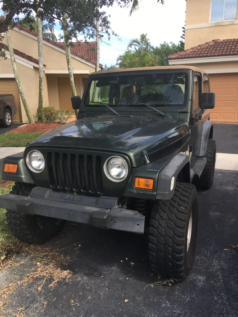

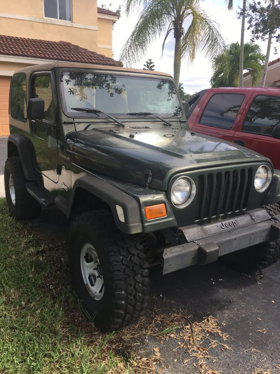

Hello to every Jeep Wrangler tj guru!!
I started checking this site like 2 years ago, on different tips on what to do on a '98 4 cylinder manual transmission ,after a friend of mine, asked me if I can keep his wrangler on my driveway for 2 weeks, while he can clean his garage.At that time ,I had it sitting in my driveway for a year already.My sons were 14 and 12 at the time, and after 3 years with it on my driveway, and seeing it everyday, Is like I want to fix it for my kids.
Now I have the opportunity to buy it for $1200.And I can guess that the main problem was that he installed a lift kit, and 35"s ,and the jeep wasn't performing as expected.It was running when was parked 3 years ago, now I need to invest a little to make it run(battery , fluids, flushing fuel system).
So I'm asking what would you do if I started it and is mechanically sound?I'm a chevy guy, so I don't have all the little mods and tricks planed to do since I was a kid, I'm guessing you were ,give me a direction to go ,please!

For $1200 it's worth it in parts alone. How does the frame and underside look? Lots of rust I assume (for that price I mean)?

First and foremost, make sure the frame is solid as Chris pointed out. Sitting for 3 years...not sure how much fuel was in the tank, but you may need to drain some out and get fresh stuff in there. Likely the poor performance with 35’s and a 4 cylinder has to do with gearing. Maybe trade out the 35’s for some 30’s if it’s for your son’s. If your building an off road vehicle for yourself...read on, the sky is the limit with this forum.

With the 4 cylinder you’re going to need to gear deep for 35’s. You might reconsider all that, not sure how open you are to that, but I wouldn’t go over 33’s with a 4 cylinder.
