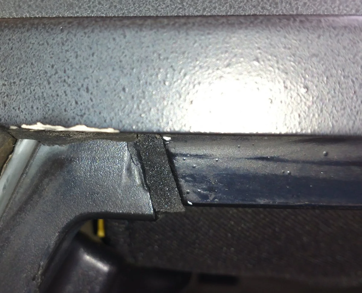

I have been wondering about this for quite a while now. After I bought a '97-'02 style for my '06, I started noticing a persistent water leak.
After searching up and down the door jambs, I noticed this gap. I've filled the space with weatherstripping, but it still leaks. How does the '03-'06 style look in this area?

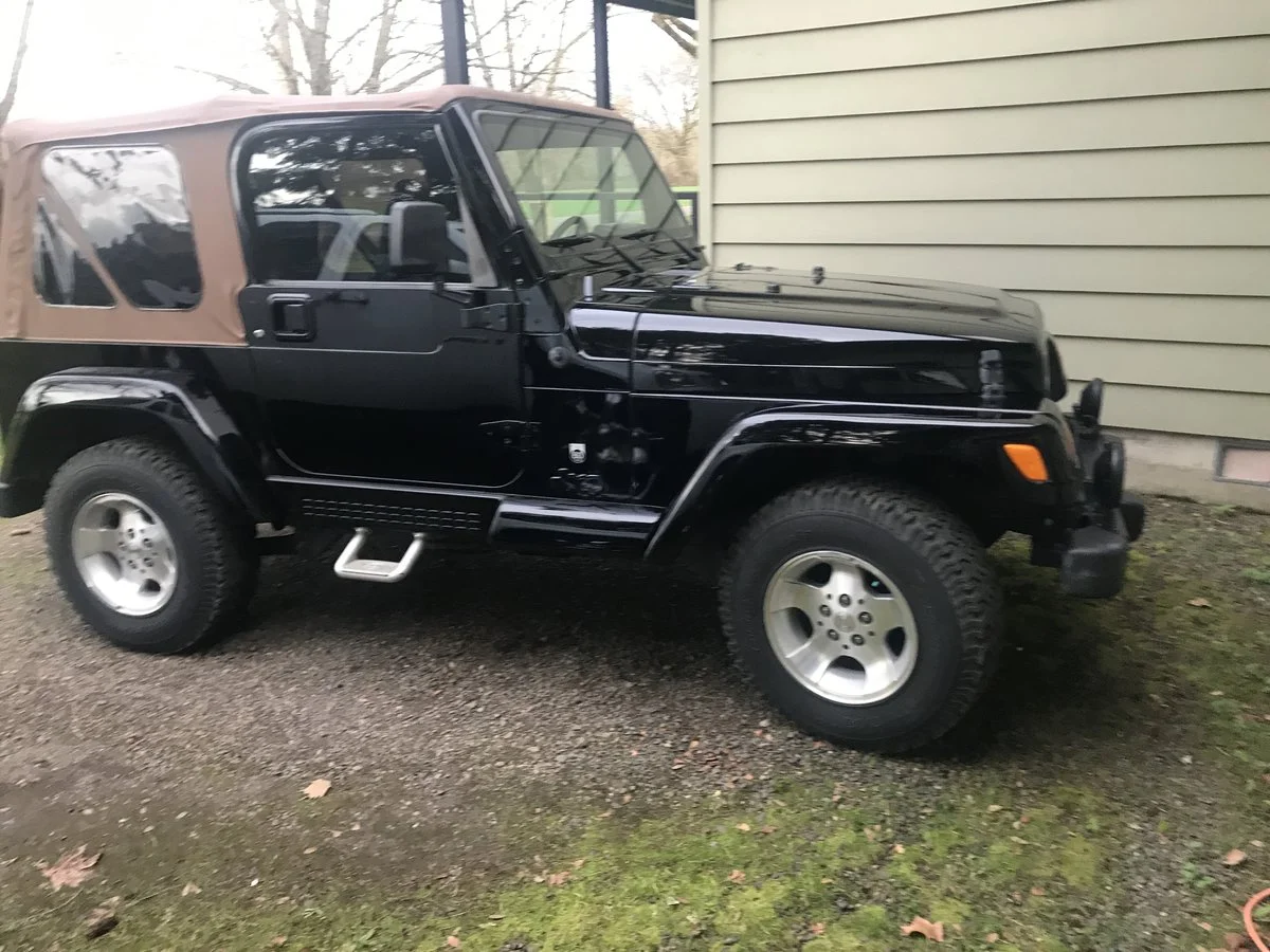

Thanks for trying :) was writing that up on my phone earlier after the test drive and waiting for an opening with my mechanic to do a new car inspection. It is a clean very stock and unmollested 2001 and very limited extras. Things I just thought they all had. It doesn't have cruse control, or the rear wiper or defroster controls. It does have the full doors and the aluminum jeep wheels but other than that it must be the least featured jeep I have ever seen. Not that I expect a lot of extras in a wrangler.
I think I am going to get it. I read about swapping over the cruse control from a doner rig was easy if the wiring harness was available under the hood by the clutch master cylinder and if there was a wiring harness in the steering wheel. While the mechanic was doing his inspection I took the steering wheel part way open to see if there were wires in there but it looks like not.

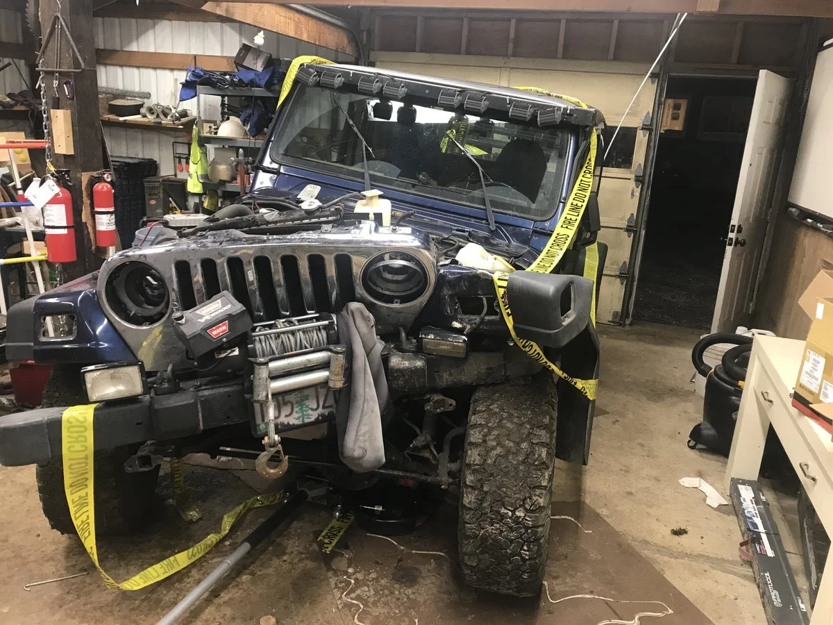

I won't further hijack this thread but If some one does come across if I can harvest and simply run the harness from the doner rig pictured below and tie into the stock harness of the newer 2001 that I am looking at let me Know I will put my results also once I have them.
Doner rig (little sisters break all your best toys. Both her and the tree were ok for the most part)
