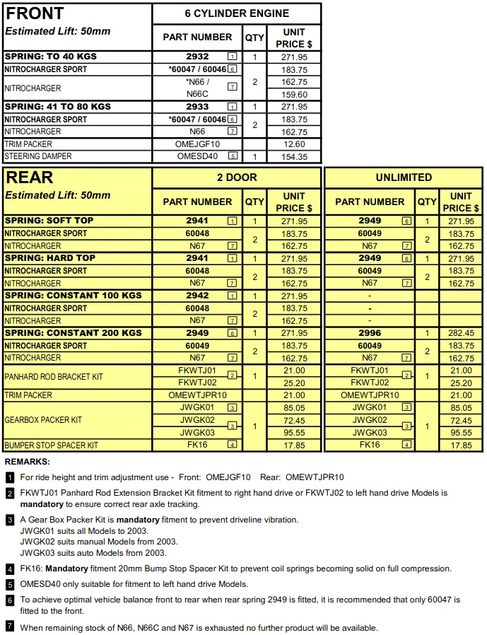

FYI, I believe that the light and medium rear number is 2941. Here's a chart from OME:

FWIW — I'm using Rancho RS5000X Part Numbers RS55239 and RS55241 - those are spec'd to 2-3" lift. The part ## above show as 0" lift.
Have you cycled your suspension with those shocks?
I have the 0-2" Ranchos and when I cycled (K02 31s), the only thing I had to do was put a couple of washers on the front bump stops. I also have minor rubbing on the passenger side at full lock, but that's a result of my Alcoas (5.25" BS).
I have. The RS55239's require at minimum 1.75" of bump stop extension based on my measurements.
