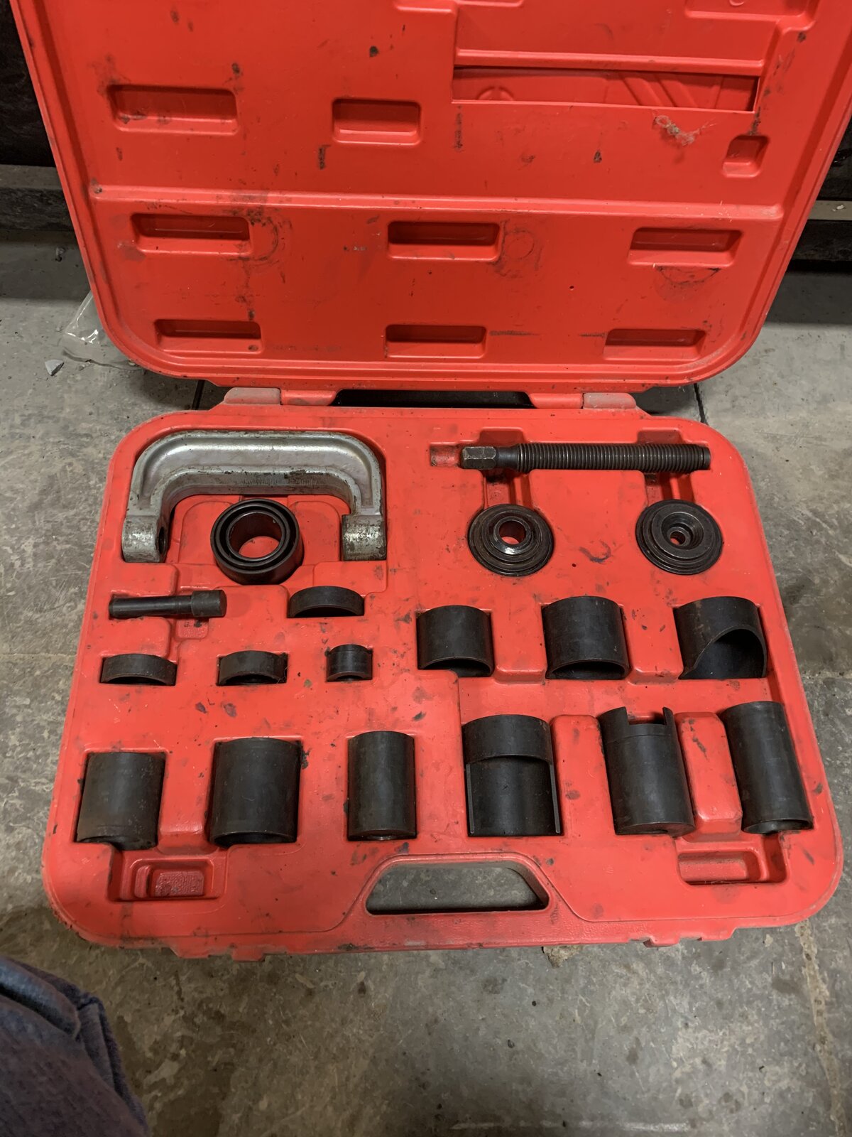

I struggled last time installing a set of Ball Joints, using the rented tool from the parts store. Doing a little reading last night, I came across this set that is supposed to be specifically for the angled Cs on the Dana 30 and 44.
OTC 7894
https://www.amazon.com/gp/huc/view.html?ie=UTF8&newItems=C7e27c5f9-2611-4391-9f9f-2e440fc51bac,1
Off course it has to be used in conjunction with the service kit, which they have shown as OTC 7249
https://www.amazon.com/dp/B0002SRGXY/?tag=wranglerorg-20
Are these correct? Or, is there another preferred set?

I have a Astro 7897.
I been using it for years. Hasn’t let me down yet

I have a US made OTC 7249 and it has been a great setup. It works well on anything from ball joints to pressing in axle studs or u-joints. The correct adapters can definitely make the job easier.
My buddy had a Harbor Freight version and it was a POS.
Definitely won't do HF. I bought one and it bent the first time I used it. You're right about the adapters helping. I rented a kit from Advance Auto last time I did a set. The kit worked, but it was a royal pain getting them in straight without the adapter set!

If you are needing one just for your personal use then a rental or Harbor Freight is fine. The one on Amazon is fine. Unless you are using in a shop where it could be a monthly or weekly use tool then getting a Snap-on or similar doesn't matter.
Definitely for personal use. I tried the HF route and the C bent the first time I used it. Granted, it was a stubborn seized BJ. I then went to Advance and rented one of theirs. It did the job, but I can see where the notched and angled adapters in the OTC 7894 kit would make the job easier. :unsure:

The HF is great for u-joints and light duty car ball joints. Don't even bother with it on a Dana axle, you will just get mad.
The triple throw-down Snap-on tool is the cat's meow for solid axle stuff. BUT it is a brazillion dollars. Luckily my work has one as a shop tool. I'd have to be doing a LOT of flat rate front end work to justify the cost if i'm paying the bill.
The OTC looks like a nice choice for a quality DIY or pro tool.
