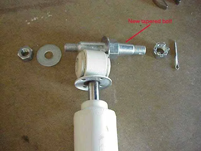

Go with a less costly steering damper/stabilizer (which will be hydraulic) and you'll be fine. Make sure the steering stabilizer kit includes a tapered mounting stud as shown below. The OE tapered mounting stud is a permanent part of the OE steering stabilizer so you'll need a replacement after you have removed the OE steering damper.
