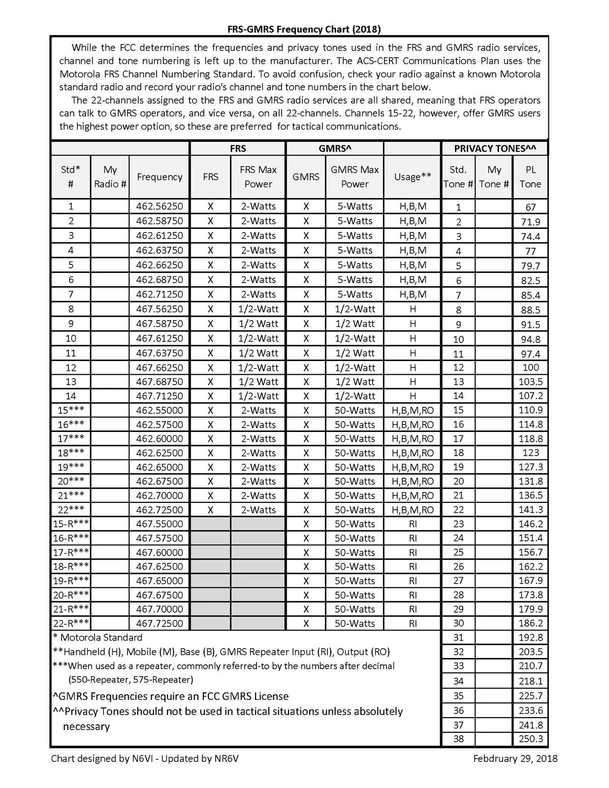

This is a good chart of FRS-GMRS and various allowed watts. A lot of the Baofeng HTs are for the ham bands, but can be programmed (against fcc rules) to the FRS/GMRS frequencies.

but seriously, that chart above with frequencies is why I stuck with basic GMRS... I've seen more than one guy on a trail have issues when the group says "gmrs channel 4" and he can't figure out his frequencies :/
