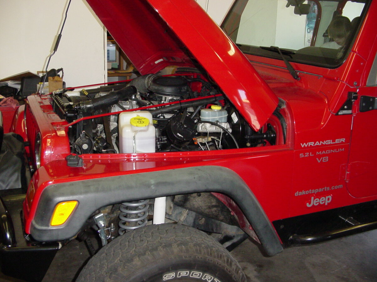

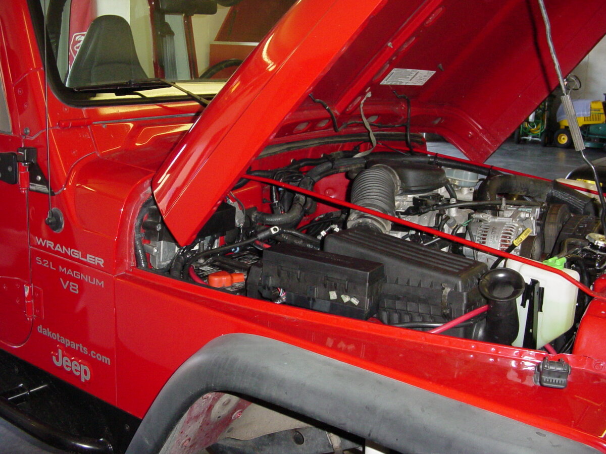

Also a hint: If you are going for a Magnum, the BEST DONOR is another JEEP. Get the 5.2 or 5.9 from a ZJ Grand Cherokee for early TJ. The starter is on the correct side of the engine, the transmission will work and can bolt right up to the Wrangler transfer case and all emissions will be adaptable. A 4.0L fan shroud will work with the 5.2L mechanical fan and look like it came from the factory that way. The power steering will connect right up and have room, look and work just like stock Jeep TJ stuff, Alternator is 100% connected the same with ECM control and uses the battery temp sensor just like your TJ. The connectors and pinouts on the ECM are the same for the same bus ECM's regardless of application on MOPAR products. The same pins are hooked to the same sensors making it a lot easier to build or troubleshoot a wiring harness. You can blend the existing body harness and dash gauges to the donor harness or add wires to the 4-cyl harness. You can integrate the existing fuse blocks and PDC under the hood into the MOPAR swap, something not as easily done on a GM or other swap.
