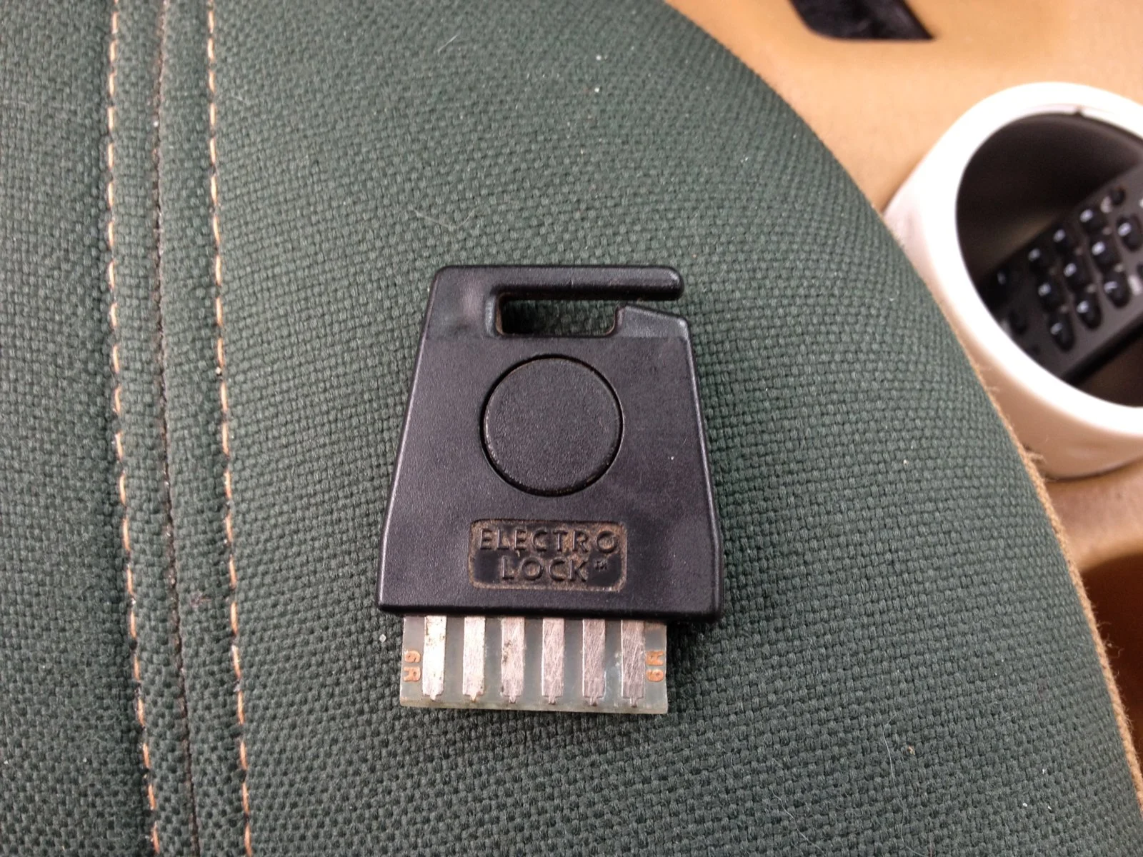

My Rubicon came with this gadget on the left of the photo that plugs into a slot in a device mounted below the dash...all I know is the Jeep will not start or even turn over without this plugged in. It has no name or markings other than Made in USA. Is there a name for this thing? What worries me is I only got one of these when I bought the TJ, and I am hoping not to lose it.
I could leave it in the Jeep all the time, but I tend to take it out to keep anyone from trying to start the Jeep when I'm not around. I either need to remove this device altogether, or find out how to get a second one I can put on my spare key ring.

It's just a fancy kill switch jumper, inside it's nothing more than random jumper wires between different pins to complete the circuit for ignition, starter, fuel pump, or whatever they decided to splice into. You will have to trace the wires from the plug to where they've been spliced in and undo the circuit breaks.
Thanks for the information. I will look for the wiring and undo it. One more observation - after starting the Jeep, you can pull this 'electro lock' and the engine runs fine. You just can't start it without this jumper inserted into the slot. To me that points to it interrupting the starter circuit.
I guess there is always the option of permanently attaching it, then zip tying it up under the dash, but I would prefer to remove it.
Then it's just a "starter kill" and, once the vehicle is started, has no effect. Should be pretty simple to disable.
