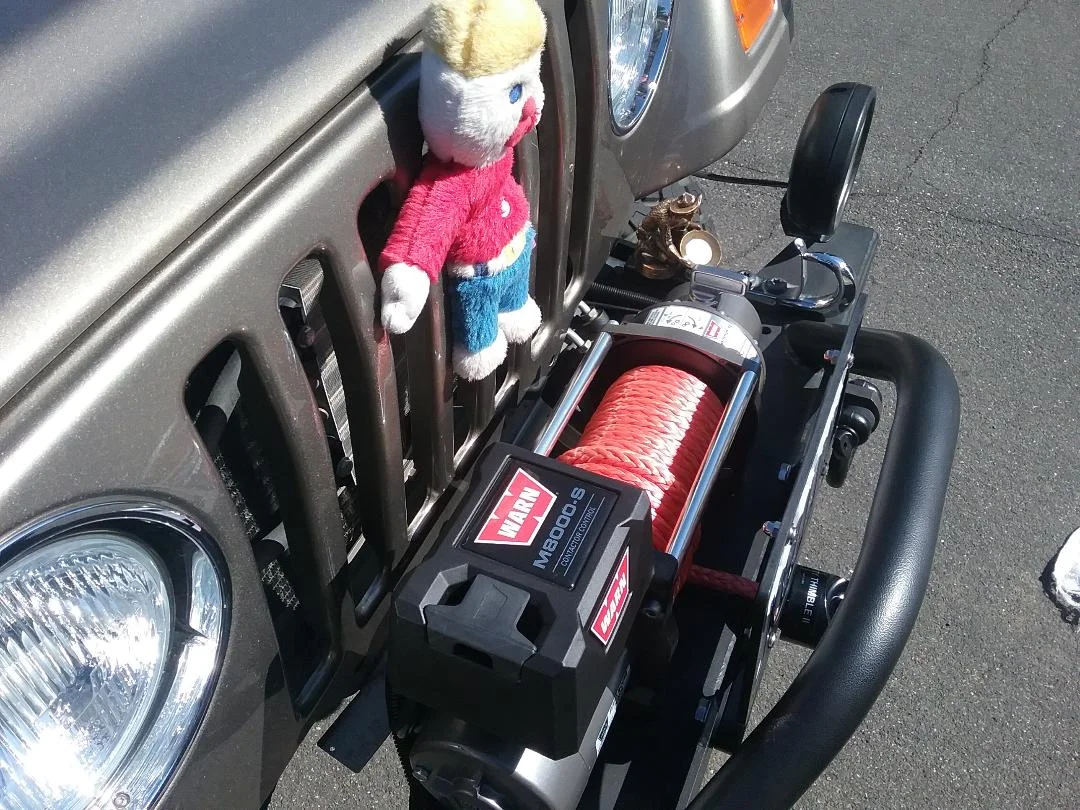

Given my last winch was an M8000, which I stupidly gave to my Son, who then sold the Jeep with it on there, I'm using that as my benchmark. My current EPi9 weighs in at around 80lbs, with synthetic line and a Hawse fairlead. Warn shows the updated M8, with synthetic, weighing in at 55lbs.

I really like the simplicity of this setup. I'm assuming this is 3/8" line, so how much line do you have on there?
85'. 100' is too much, especially if one is doing a side pull and the line is bunching on one side. Better to use a winch line extension when a really long line is necessary than too much line on the drum.

This is why I asked. Warn says they ship with 100", but everything I read says install 85'. I'm guessing due to line bunching up on the supporting rods?
