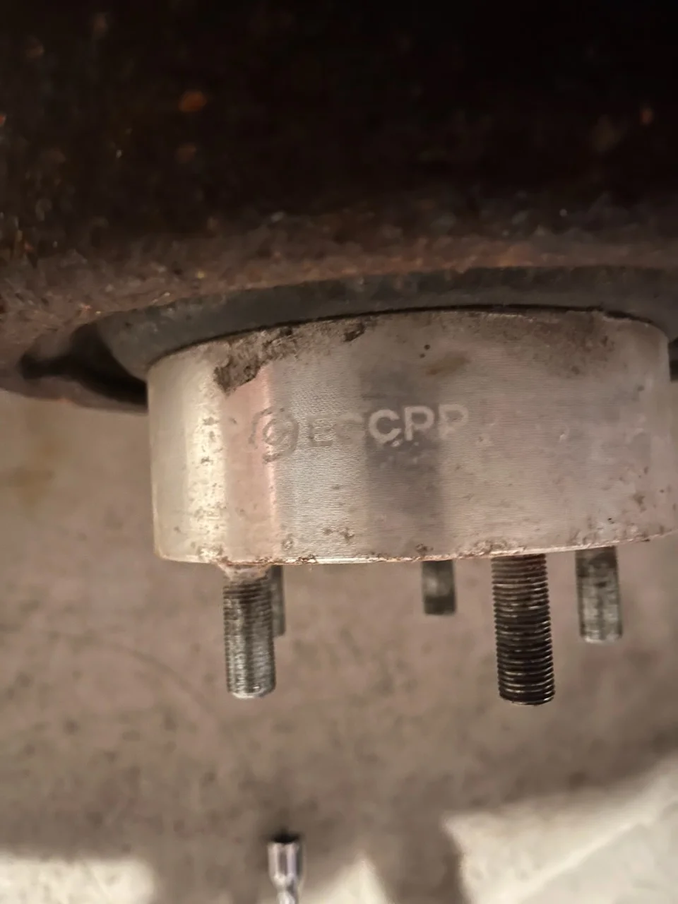

So much to my surprise when I bought some new rims and tires I found what I believe to be 2” wheel spacers
A few questions, these look aftermarket.
Are they needed to prevent rubbing? Besides the wider stance for improved handling/more aggressive look. Any harm in leaving them on?
The tires I bought are 30x9.5 and the new rims are 15x7 with a -10mm offset.

Those spacers are definitely not needed for your 30x9.50 tires, throw them in the trash. They don't help and they actually increase the 'scrub radius' of the front tires which means they swing through an arc during a turn instead of pivoting about a point when you turn the steering wheel.
When you had the new tires installed did they check your front-end's toe-in angle to make sure it's correct? If it's not, which is easily checked and corrected at home with nothing but a tape measure, wrench, and pliers. An incorrect toe-in can cause accelerated tire wear and conceivably increased tire noise.
This is how you can do your own toe-in. Done with just a modicum of care it will produce a toe-in angle every bit as accurate as a good alignment shop can produce. Really. https://wranglertjforum.com/threads/how-to-align-your-jeep-wrangler-tj.85/

Thanks jerry
Yeah I bought the new rims and tires from tire rack. And then took it into a shop for an alignment. I’m assuming I can just remove, no realignment necessary?
Correct.

Yes you can remove the spacers without it needing to be realigned. They wouldn't be causing the hum, it's probably just from the new tires. Offroad oriented tires like all terrains and mud terrains usually generate a little (to a lot) more noise than conventional street tires do.
