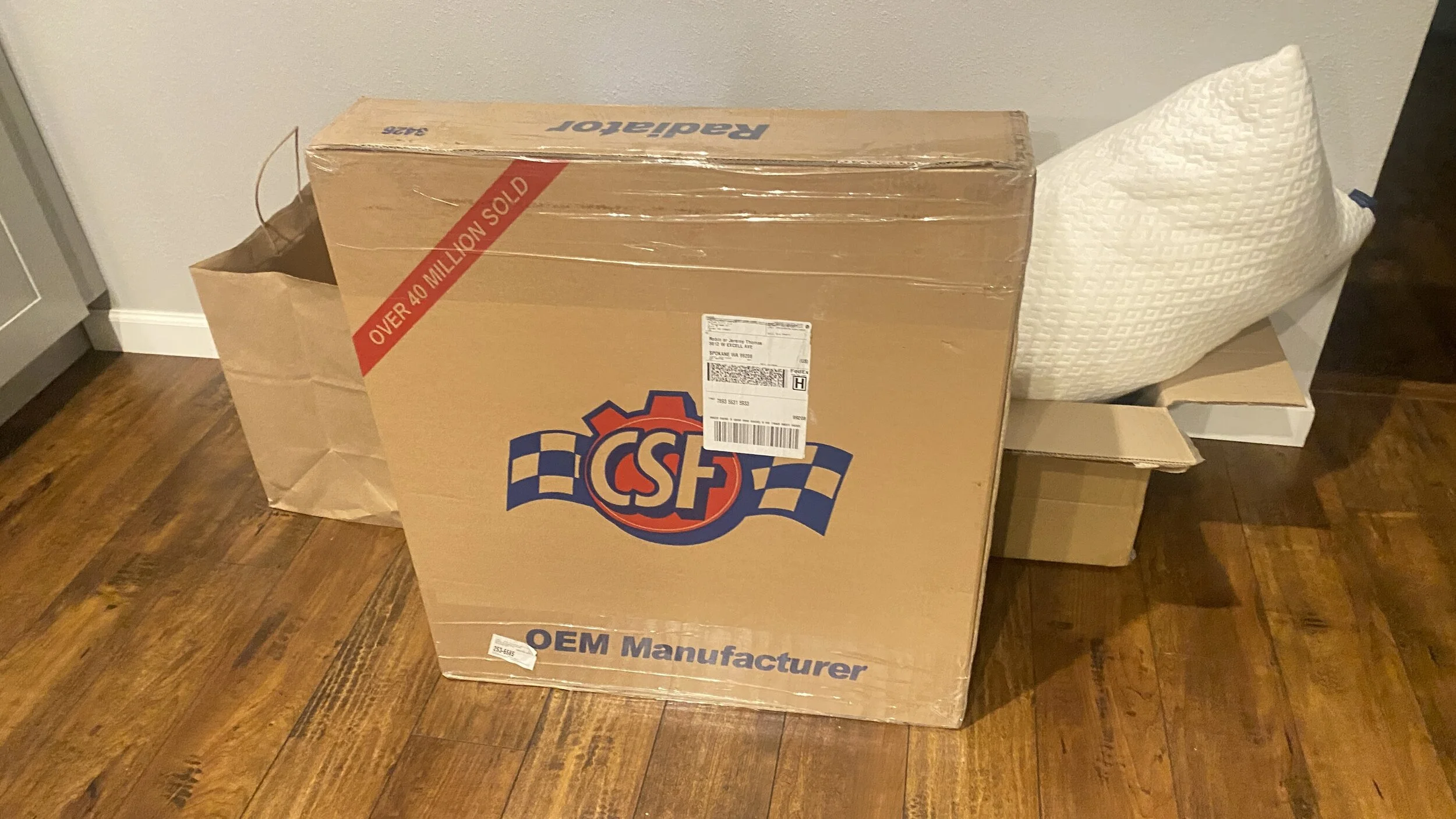

I went with a CSF, back when that was the consensus. Ask me again in 20 years.
I walked in the living room this afternoon and this was sitting there. My wife said it must have been in the cart when she clicked 'buy'. If it lasts 20 years I'll be happy.
I will say after I installed my CSF radiator the bolt holes lined up fine, mounting to the car and shroud with the only issue is a different bolt for the shroud which wasnt a big deal as I had some extras
