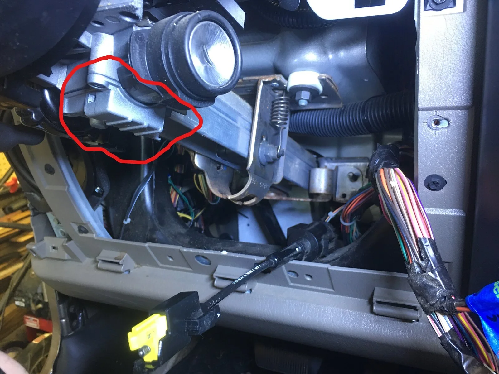

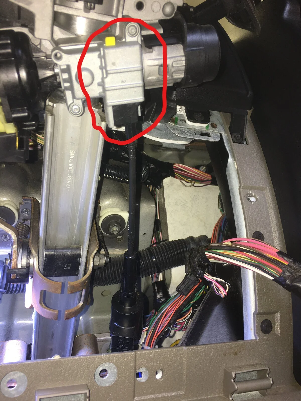

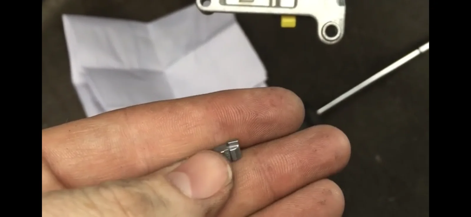

You need the ignition switch from an auto without the release lever to remove the key that the manual has. If you get one, make sure you get the little pellet that is used to make it all work. It is about 3/8" tall x 1/8" thick x 1/4" wide and is not available anywhere I have tried to find one.

Not sure but probably. I've got a couple that are useless without that pellet.

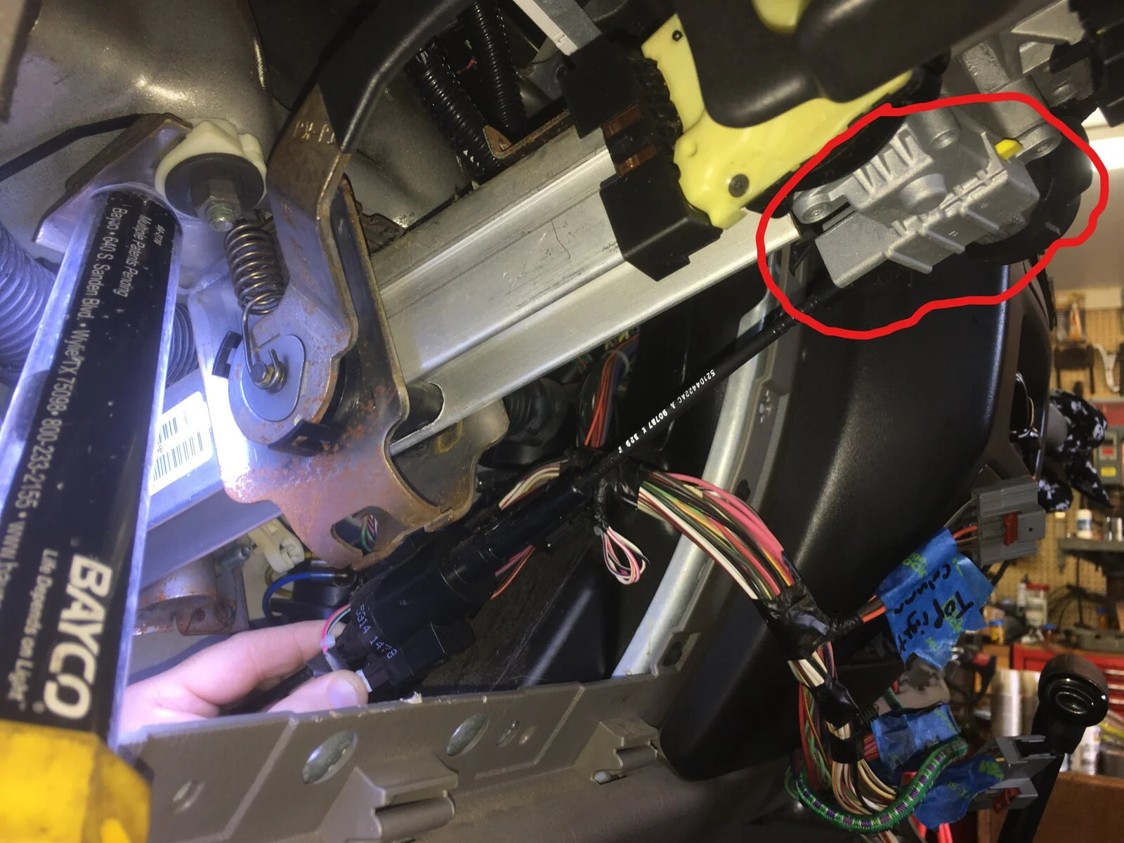

You only need the lower part of the ignition switch. See Mountaineer Tom's first picture. Pull the lock cylinder to remove / install the switch. And don't loose the pellet!

If you don't get the pellet, the switch is useless. You don't need the column but the pellet falls out which renders it useless. If you get the switch and the pellet, you're golden.

I saw that Liberty video too when I was looking at how to change my actuator. Glad I did because I could see myself letting that little pellet get lost accidentally.
I’m no machinist, but it seems like it would be easy to reproduce if you had one to get all the measurements from. I’m sure there’s not a big demand for them unless you happen to be someone who needs one.
