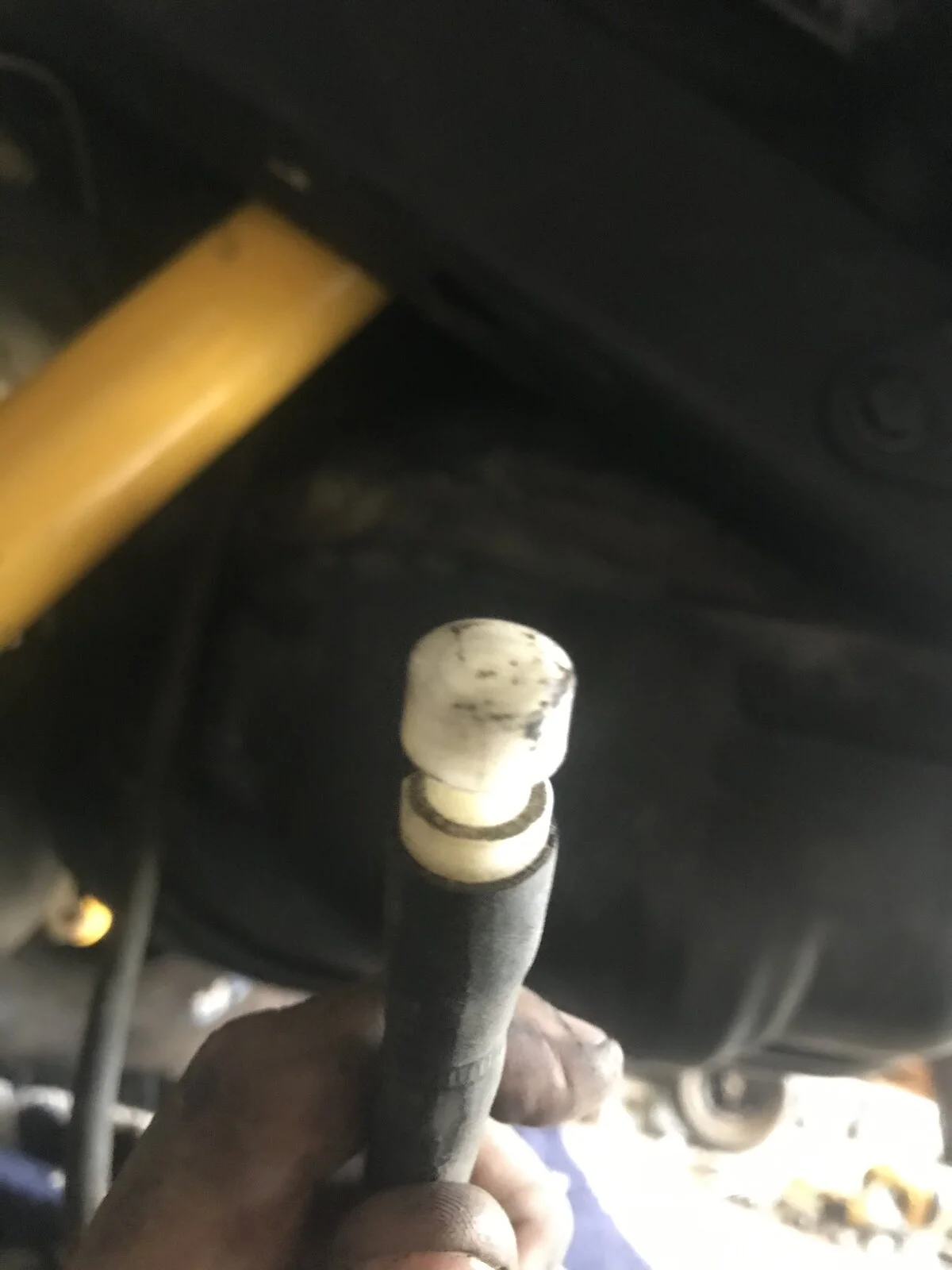

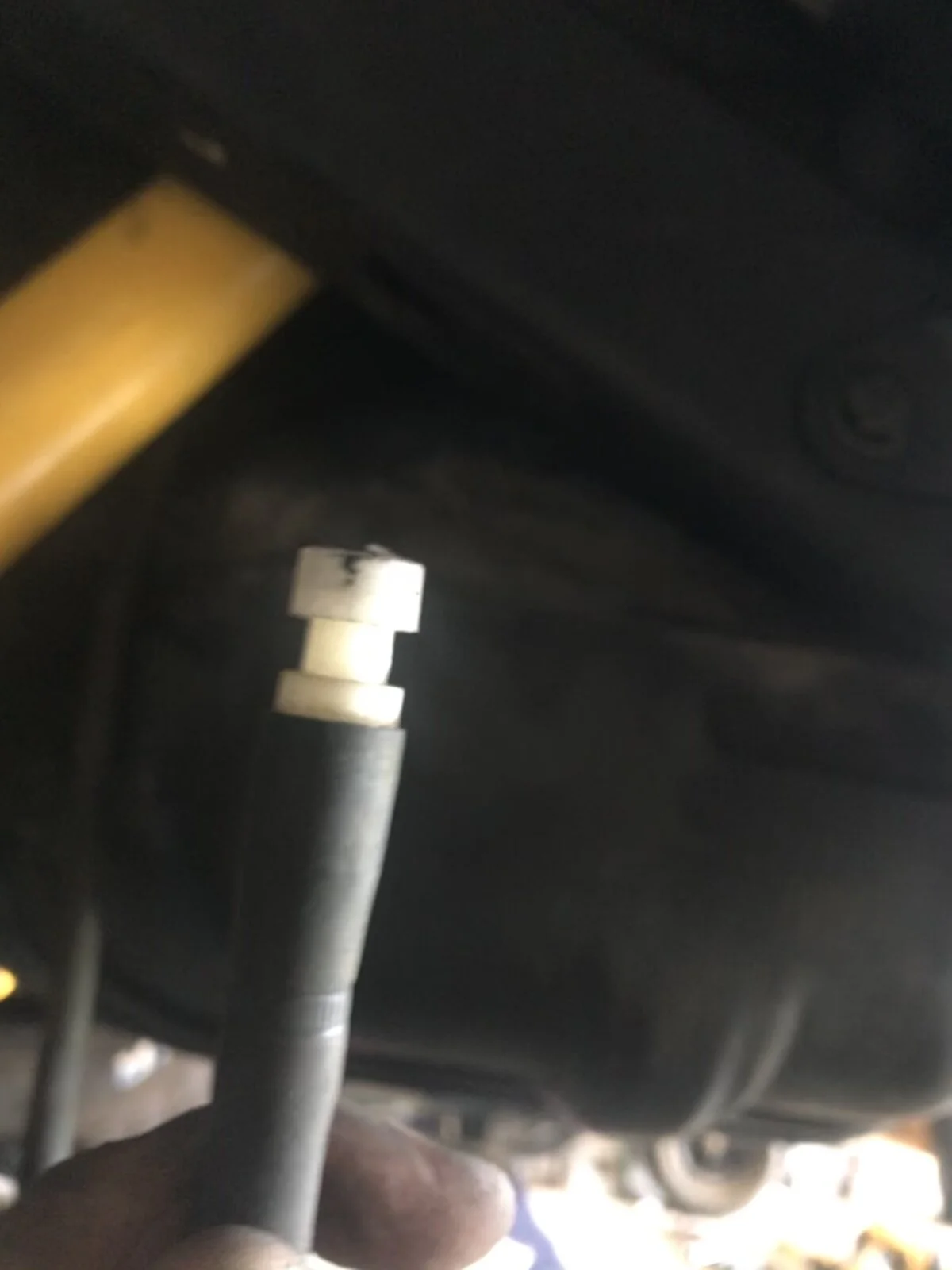

I had to drop the fuel tank today and I can’t figure out where this hose goes. Looks like a vent on the end. I’m guessing it should be zip tied to the fuel fill hose. Anyone know?
Should be attached up inside the driver side wheelhouse back by the tail lamp
On my '06, it follows the fuel filler tube and is zip tied up high there.
I was told that it is zip tied to the filler hose line. I guess you can attach it anywhere as long as water does not get in there.
Awesome! Thanks for all the knowledge. I thought that’s what it was, but wanted to be sure.
