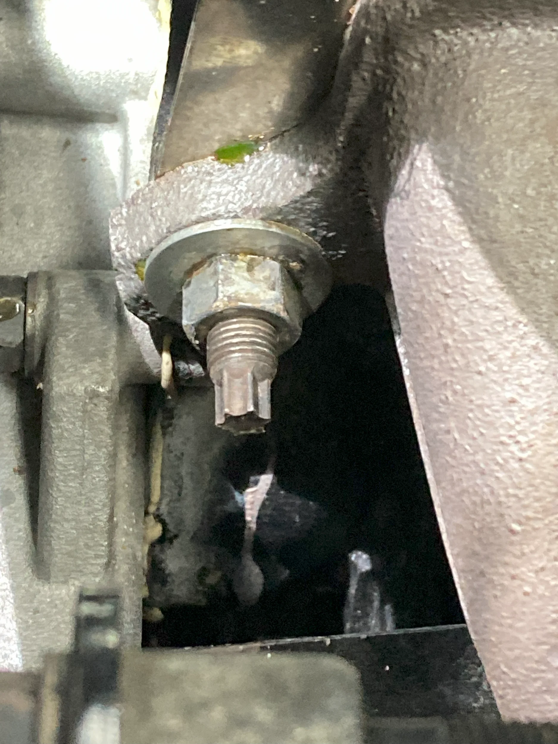

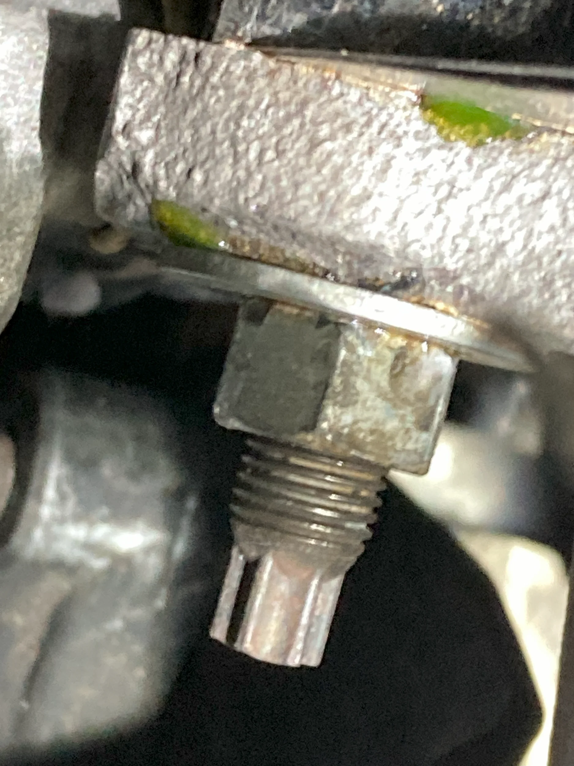

Where is this coolant leak coming from?
Probably, the reduced torque is to prevent the sealant being squeezed out from in between the threads. Seems like 100 ft# is the proper torque wrench setting.
Reactions: JMT
Ok, to do this, don't take hoses off the steering pump to drain any fluid. Just release the stop cock and take a quart or so out. If you do it another way you will have coolant everywhere, and I mean everywhere. Like the entire garage floor the size of the Jeep. NO.
