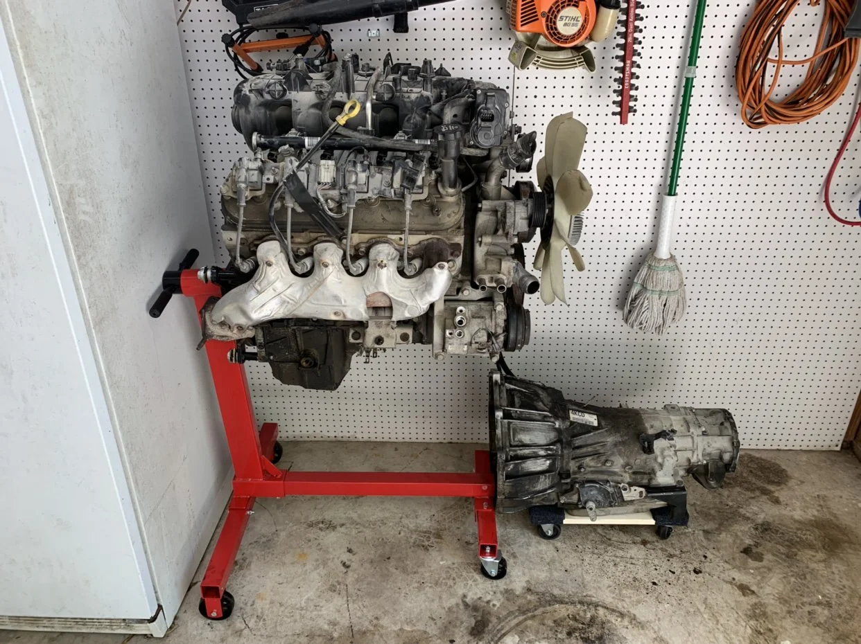

Best solution is an engine stand. Harbor freight sells a cheap one for $60.
Makes your life easier because it's now on wheels.

I'd put it on an engine stand and separate the transmission and engine. It's not that hard to do, and I'd want to separate them anyways to inspect and replace anything (i.e. rear main seal, which you'd be stupid not to do while it's already out).

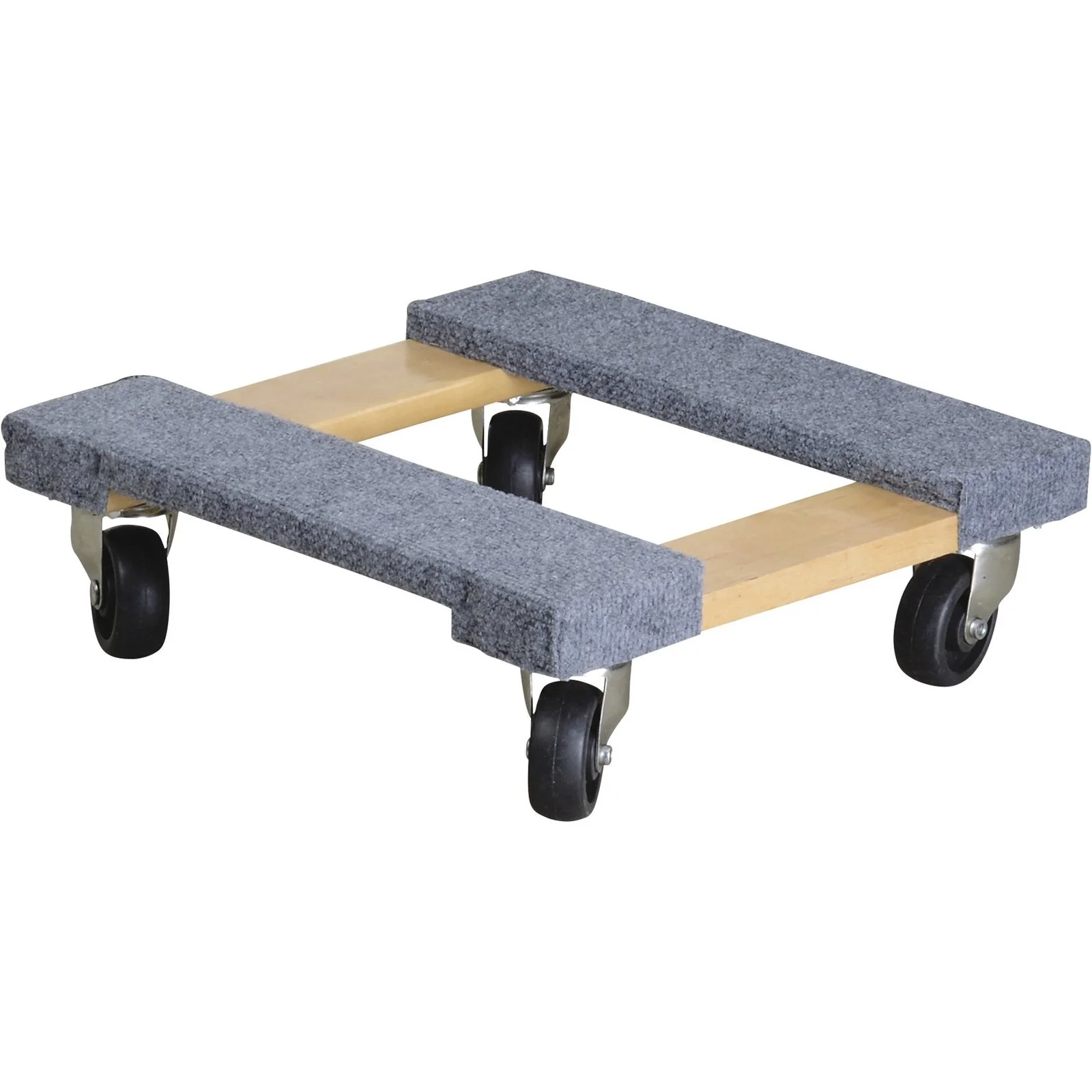

Pick up a couple of these:
https://www.harborfreight.com/mater...n-1000-lbs-capacity-hardwood-dolly-63098.html
For the engine screw, screw thru the dolly into a couple of 2x whatevers set on edge. Space this lumber wide enough to contact the oil pan rails where they screw into the block. Add some braces as required. The width of the 2x’s only has to raise the engine enough clear the oil pan sump. Center the engine as necessary and secure it with a ratchet strap or two.
For the trans, just screw a piece of plywood to the dolly and let it rest on the pan, (if it’s an automatic). It sounds as if this is only for temporary storage.
You’ll thank yourself for the casters that let you move the pieces around the garage. As an added bonus, after you sell the power train, you can remove the added lumber and you still have the moving dollies.

Buy some furniture trolleys/dollies from Harbor Freight. I've used them for V8/automatic tranny combos for years. Works fine. Get true hardwood ones, or "plastic". They're stronger.
