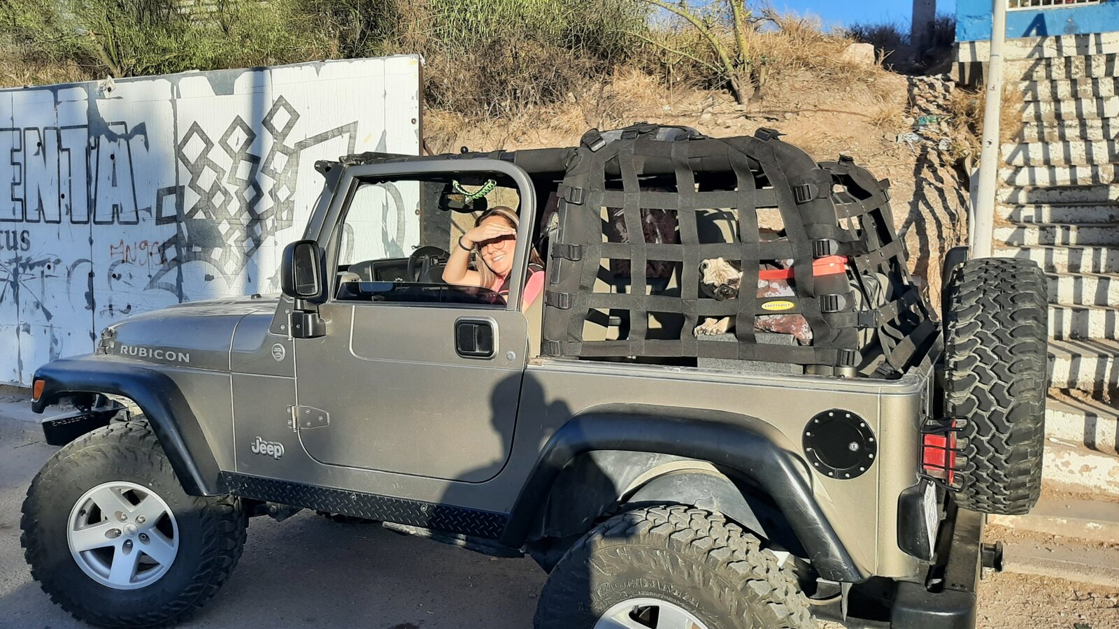

What brand of cargo webbing do you have?
Smittybilt CRES Cargo, which right now is INCREADIBLY cheap on amazon, only 70 bucks and it is great because you dont need to remove it if you put your hardtop back again... I have only but good things to say about it...

I like the looks of it. Good for the dogs. How long have you had it?
about 3 years now.. I only have my hardtop off like 3 months per year tho... but for storage stuff between the cargo net and the window is very functional.. I never remove it... and wash it once per year with soapy water and a brush...
I got it installed. Took me awhile. It does great to contain the dogs.
