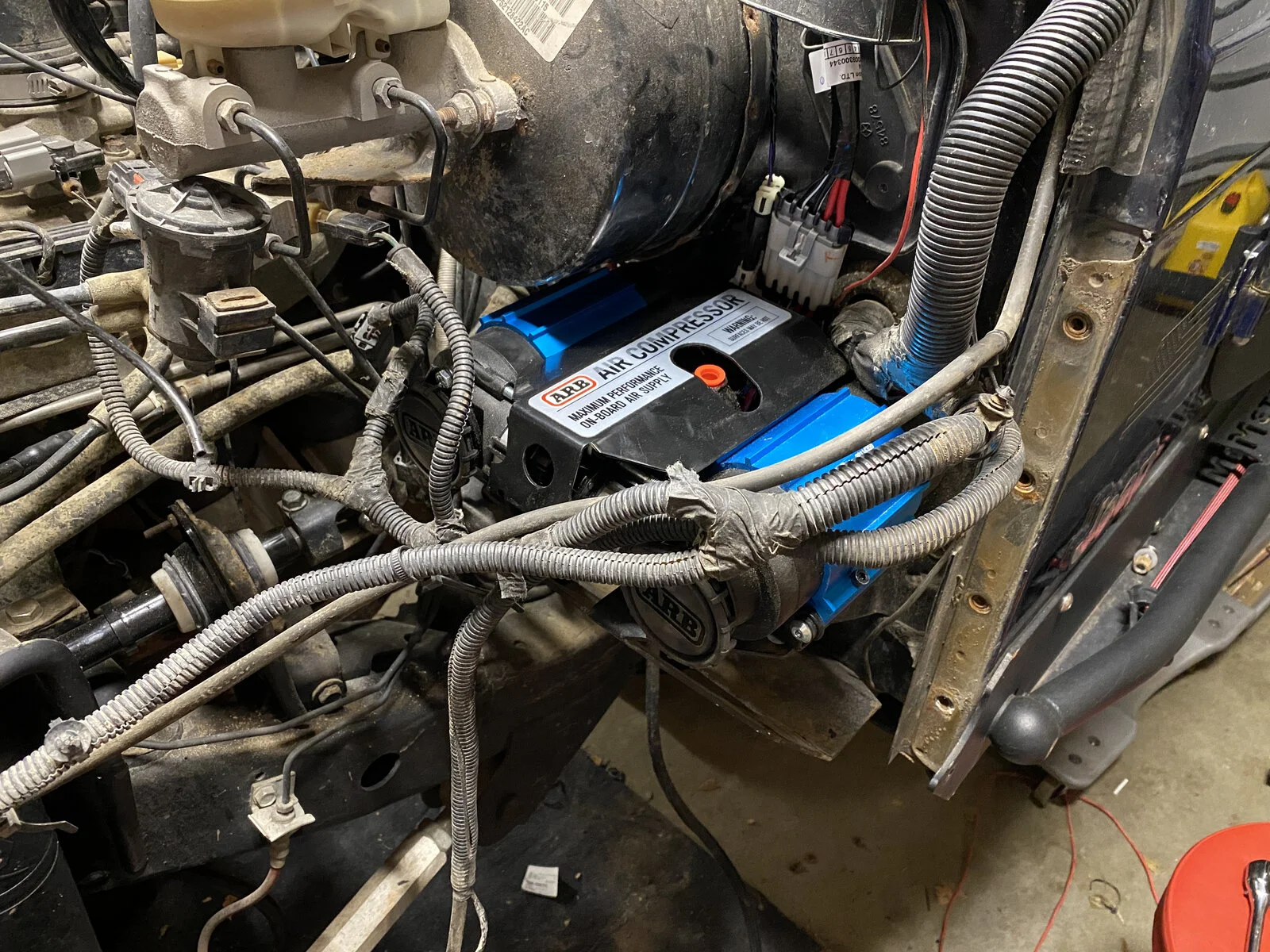

X2 on the tray under the brake booster, that's where I have my ARB compressor, it wasn't easy putting it because you barley have any room to work with, but that's where a lot of people put them.

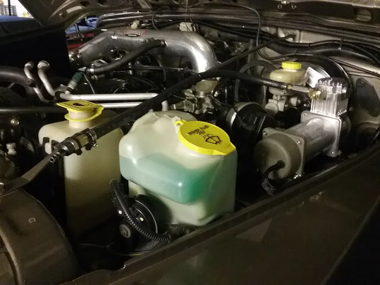

If you have a later model TJ with the evap canister in the back, you could mount the compressor like this.

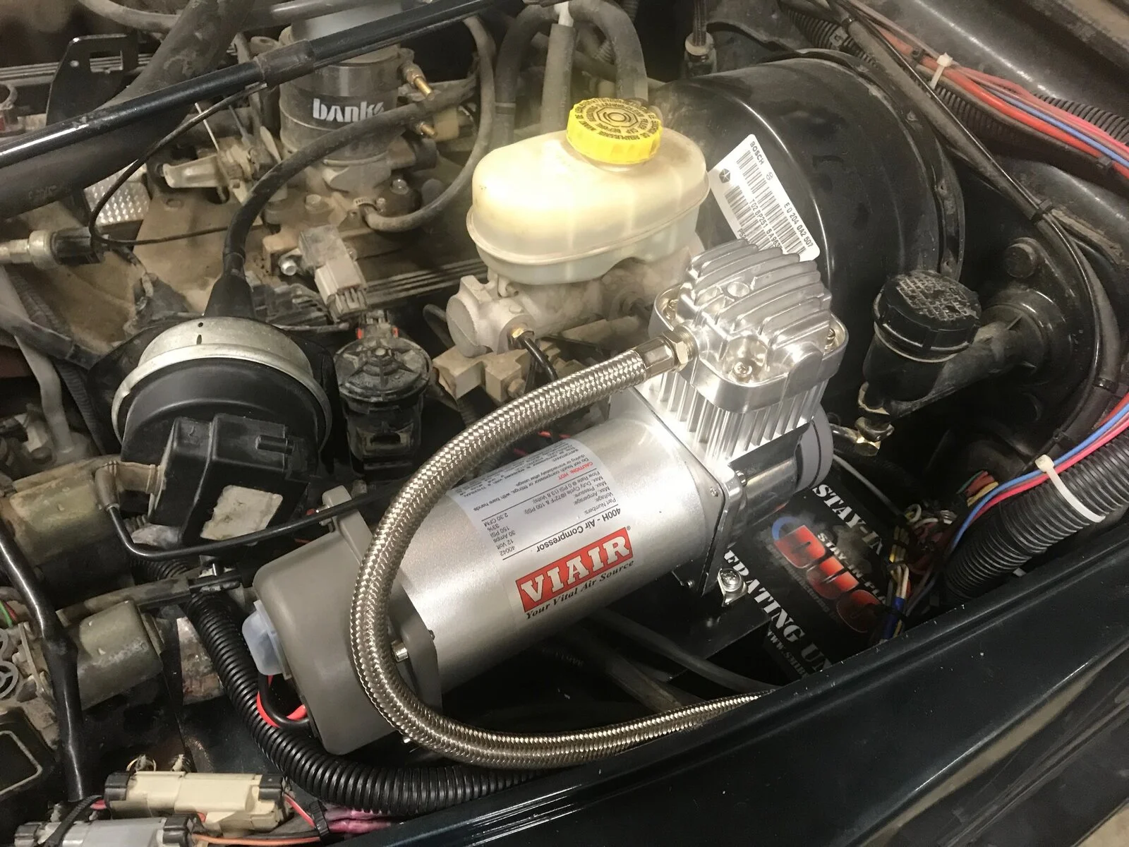

My Viair is on that tray now 480C for size comparison. Tomorrow my dual ARB arrives so it will be swapped out soon.
Does the dual ARB fit on the tray below the brake booster or just the single?

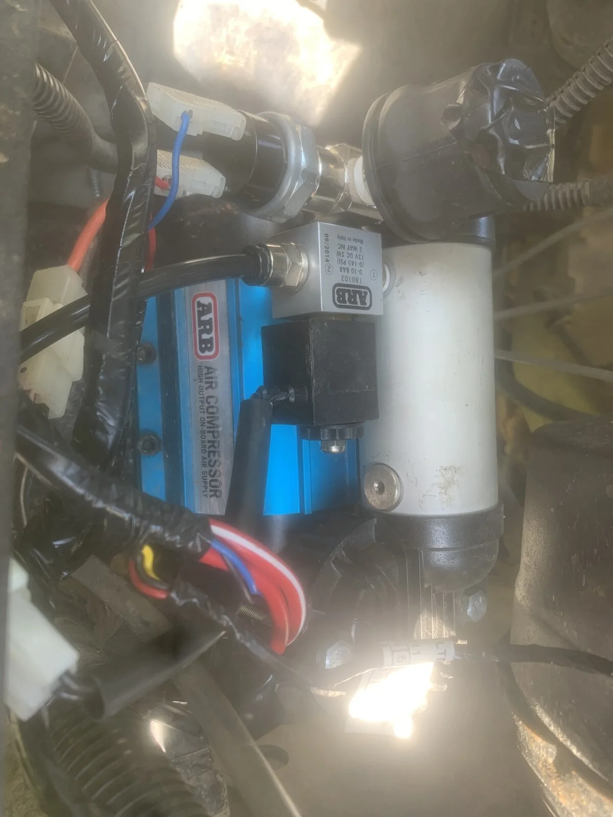

Here’s what my setup looks like with the air chuck attachment and the solenoid for the arb in the rear.
