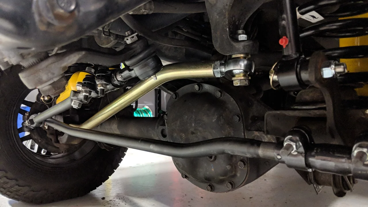

I'm planning on finally getting an adjustable front track bar, and I'm looking for thoughts on which to get. I have 3" of lift in the front.
These are what I'm looking at as they are in my price range (around $180 Canadian).
Rock Krawler RK05194
Rubicon Express RE1600
Rough Country 7572
Rough country track bar, don’t trust their brand too much anymore other than that, its not anything flashy but it’s very solid and joints seem good
One thing I like about theirs is that they use a Moog Problem Solver TRE which is cheap and easy to find.
Reactions: Nicholas
I recently went with a MetalCloak track bar with my OME HD lift. No issues so far.
Reactions: derekmac
Ok, I think I'll go with the JKS. It's more than I want to spend, but as they say, buy once cry once, lol.
