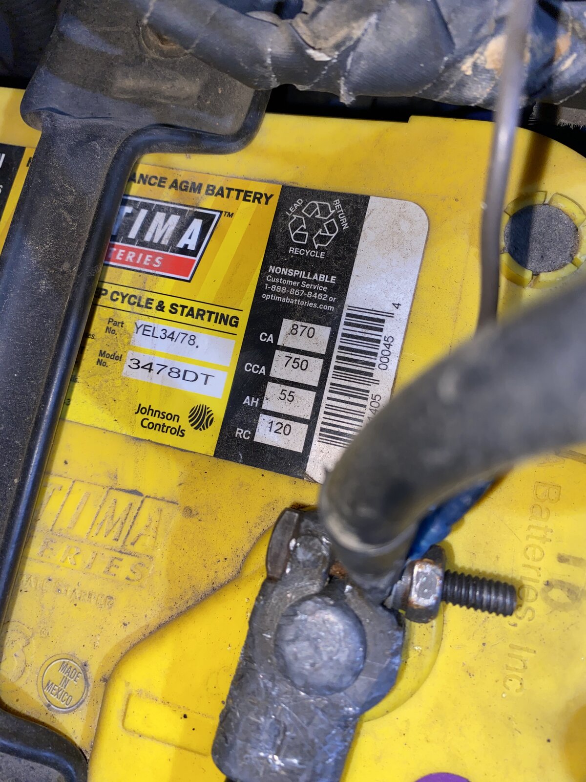

This Optma yellow top was made 7-15. I installed it new 03/24/16.
It’s beginning to start slow but starts every time. Thinking it may be time for a change.
Would like your opinions.
Is this a long time for a battery to last ?
What battery should I try this time.
Thanks !

If this battery is finally knocking on deaths’ door after 7+ years, why would you replace it with something else?
I just bought a yellow top for my JK, and when this TJ battery goes, it will get one as well.

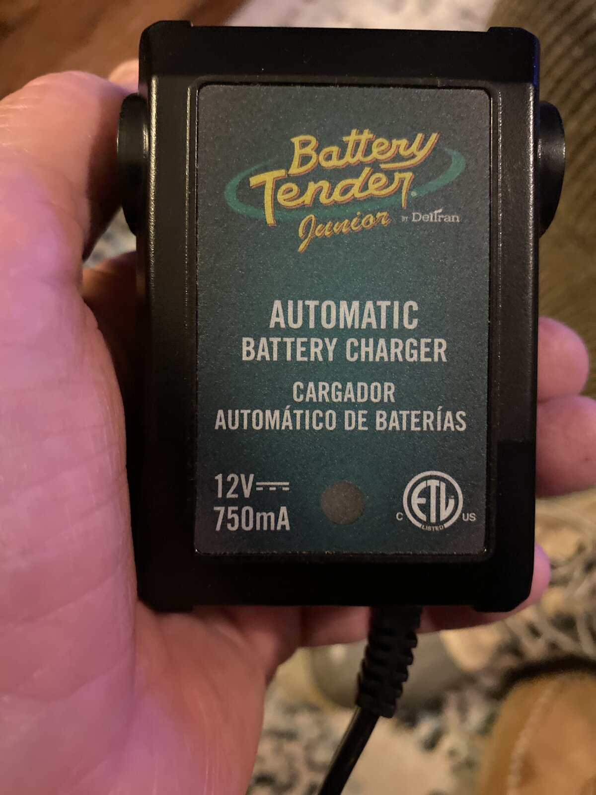

On the subject of battery maintainers, I have one of these Costco-only Deltran Battery Tenders on the starting batteries of each vehicle I own that isn't driven weekly. They work as expected.
Here is the pigtail to connect to the battery of my jeep, which tucks out of sight when not in use. I would rather have the charger sit out where I can see the indicator lights from a distance, and I wanted to be able to easily move the charger to another vehicle, so I did not permanently mount the charger under the hood.
