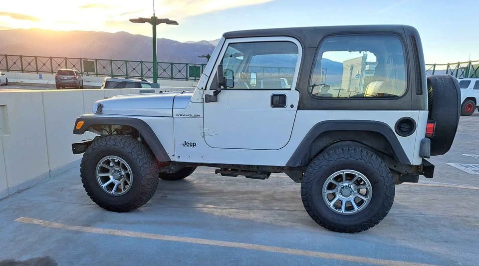

Option 1: $6500-2002 Apex Edition. 135k miles.
Description: 2002 Jeep Wrangler Silver APEX Edition, 4.0L I6, 4 Speed Automatic w/ Overdrive 135k miles. Lifted, Hardtop, Pioneer Bluetooth/AUX radio, Soundbar, APEX edition hood and leather seats, Nilight LED Front Bumper Off-Road Lights. Still Good Tread - 33’s - BFGoodrich All-Terrain T/A KO2 All-Season LT285/75R16 tires on Vision 353 Turbine Wheels. Minor interior and exterior blemishes/rust, perfect glass. Known issues: Small radiator leak, oil leak, and power steering leak. Overall in good/fair condition. Presale mechanic inspection from Christian Brothers Automotive was done 11/13.

Of the two rigs I would choose option 1 due to lower mileage, no cheap fenders, and no fish on the hood. I would verify the frame is not rotten. Expect to replace the radiator, rear main seal, and regear to match the tire size. The 42rle transmission wasn't available in 2002 so the owner either swapped in the 42rle or the rig actually has a 3-speed auto, which I'm my opinion is a better transmission.
Option 1 does have visible rust on the frame shown in the pics... you need to get your fingers in all the holes in the frame to feel for major rust. A camera, such as a borescope, in the frame would be good to look deep in the holes for issues would be beneficial/required.

I like the first one. Like others said get a really solid understanding of the rust you are dealing with. In addition to the Frame inspect the torque boxes (channels welded to underside of body where the body mounts bolt to). If they are rusted out they are not fun to replace and/or expensive to hire out the work.

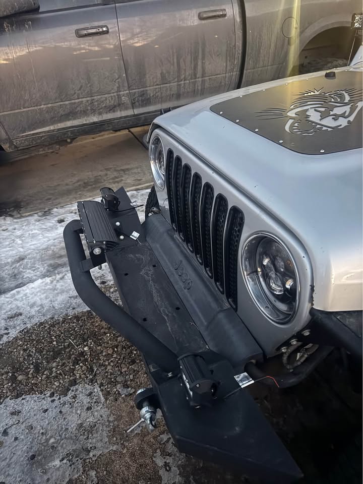

The fenders and hood on the second are a big red flag to me. Is that a hood vent with no ventilation holes cut??:ROFLMAO:

Of those two options, I'd go look at #1. #2 looks like #2. Nothing but junk catalog "mods". Likely owned by a teen or early twenty-something so maintenance history would be questionable at best.

The Apex edition was made 02-03'. Maybe you got the years or transmissions mixed up. I'd take that one either way. Offer them $5,500 so you can buy a radiator and fix the leaks. The second one is a NO-GO just because of the Fishbone Offroad hood louver. :rolleyes:

as mentioned above the rust is a big issue to check for, that goes for all TJs. Jeep #1 obviously spent a lot/most of its life pre skid plate drop because it has the telltale rot between it & the rails. While it may be 'surface' it's very possible if not likely that it's worse inside. After doing the recommended probing & viewing inside with a camera I'd pull that skid off & make sure the bolts come out. If not it can be fixed, but that's just one more headache. It looks pretty good from the outside but I wouldn't end the probe at the skid, I'd check every inch of the interior of that frame, just to know what you'd be getting yourself into.
