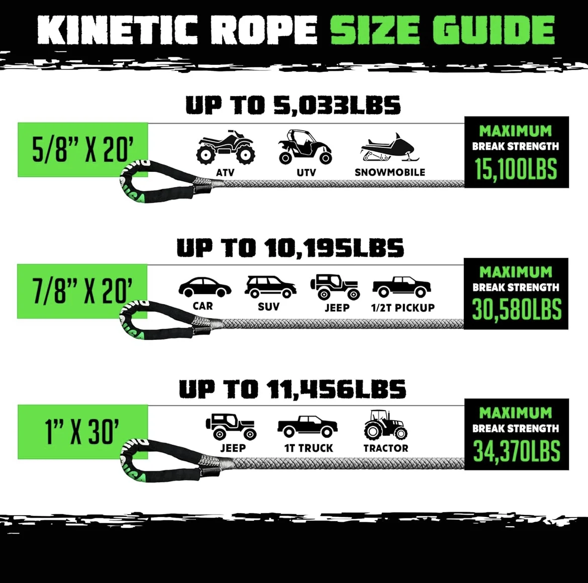

Winter is once again here and after getting hit with a bunch of snow over the weekend I decided I really need to order a kinetic rope to keep in the TJ.
I don’t do any real wheeling so since it’s only going to see very occasional use I’m gonna go with Rhino USA (which I know is not made in USA).
Question is… what size would you guys recommend going with?
Rhino recommends the 7/8” for Jeeps but according to the weights I should really go with the 5/8”.
Since this is a chinesium rope should I go with the 7/8”? Or am I safer having the rope be the weak point?
I’ve never actually weighed my TJ yet, heaviest add-ons would be the 33x10.5 tires with steel wheels, steel rear bumper, and the MORryde kit. I do plan on getting a steel front bumper yet.
Also, going to be ordering a Rhino soft shackle with it. 1/2” or 3/8”?
1/2” - 15,000lb WLL/46,000lb min break
3/8” - 10,400lb WLL/31,400lb min break
PS: Getting a Crosby bow shackle as a backup
Get the 1" and never worry if you bought enough. and get a 3/4" shackle or soft shackle.

3/4” is the proper diameter for a TJ. 30’ is desirable.

I'd do 7/8". I'd say a 7/8" Rhino not USA is equivalent to a 3/4".
