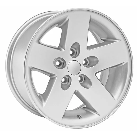

The best option depends on your goals and the tire size you would like to run. You can run OEM TJ Moabs (or reps) in 16x8, reps in 15x8, or JK Moabs in 17x7.5 with appropriate adapters. Pick your tire size and go from there.

All TJ Rubicons came with a 16x8" Moab wheel. It was a very good looking wheel in a dumb size. 17s are the future. Use JK 17" Moabs!
