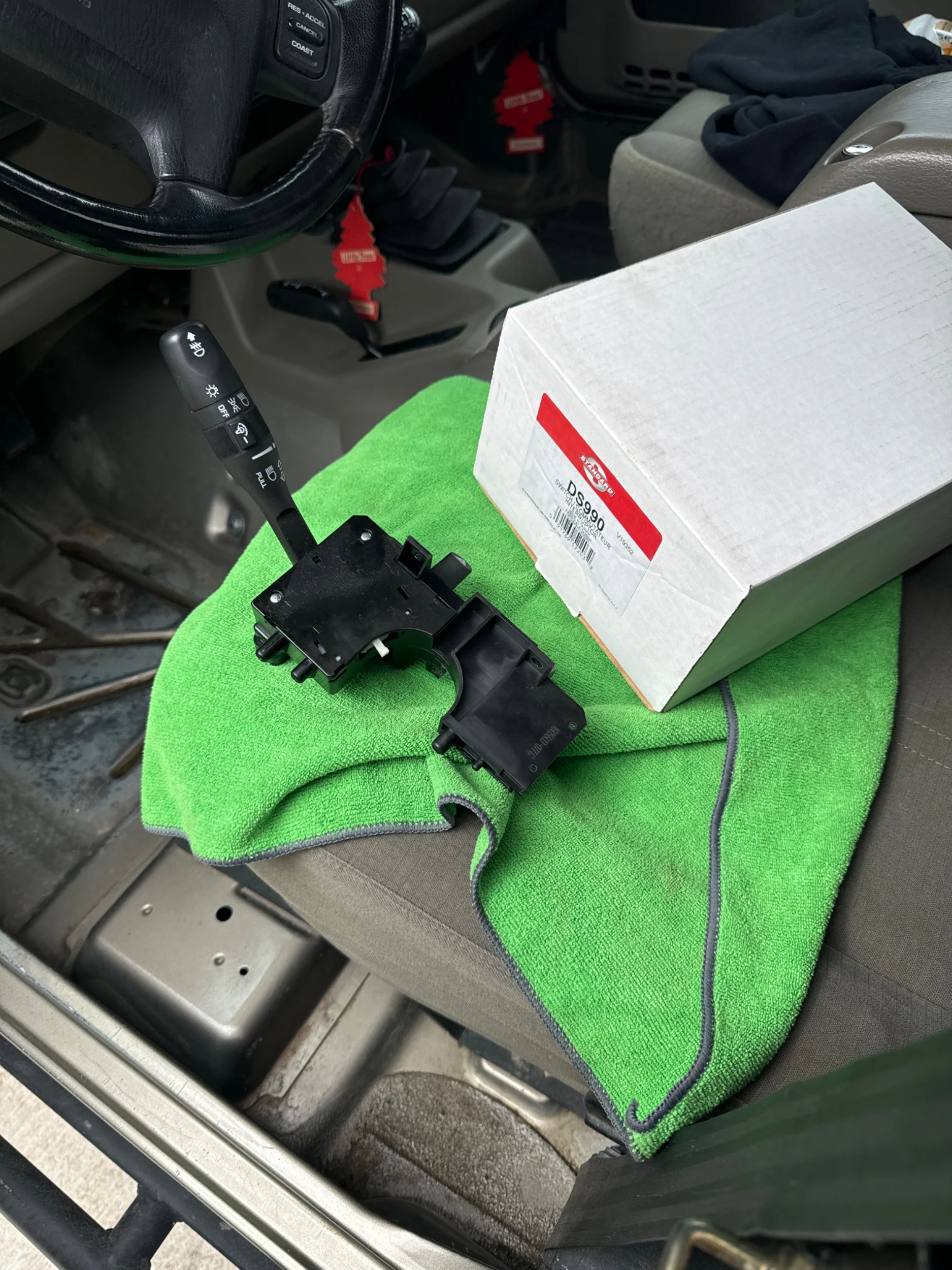

2004 rubicon Fog lights came on and killed the battery .. its been fixed 3 times following the repair here .. I just wanna replace it with new... I know somewhere along the year it went from different peices to a single assembly and when looking on line I'm seeing different ones ... can someone link to my specific jeep part ... thanks in advance .. used search it didn't reveal very much

Thanks .. will order tomorrow ... need to pull it to look at the plug before ordering

Mine is an 04 and I just put this one in a few months ago. It’s been good so far. I got it from Rock Auto.

10 year no hassle warranty here.
https://www.am-autoparts.com/produc...es-and-levers/AM-1577363625.html?m=454&y=2005
