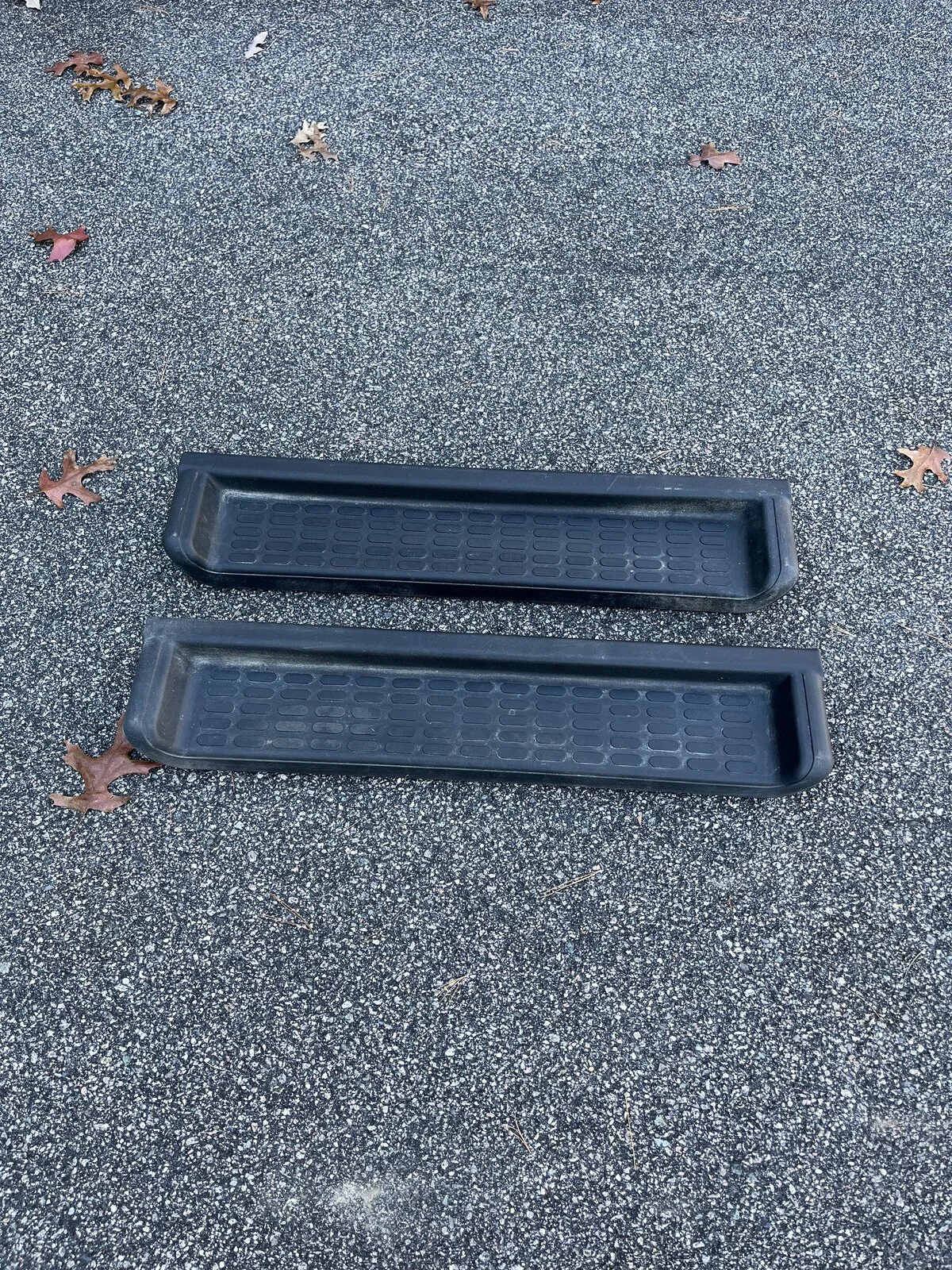

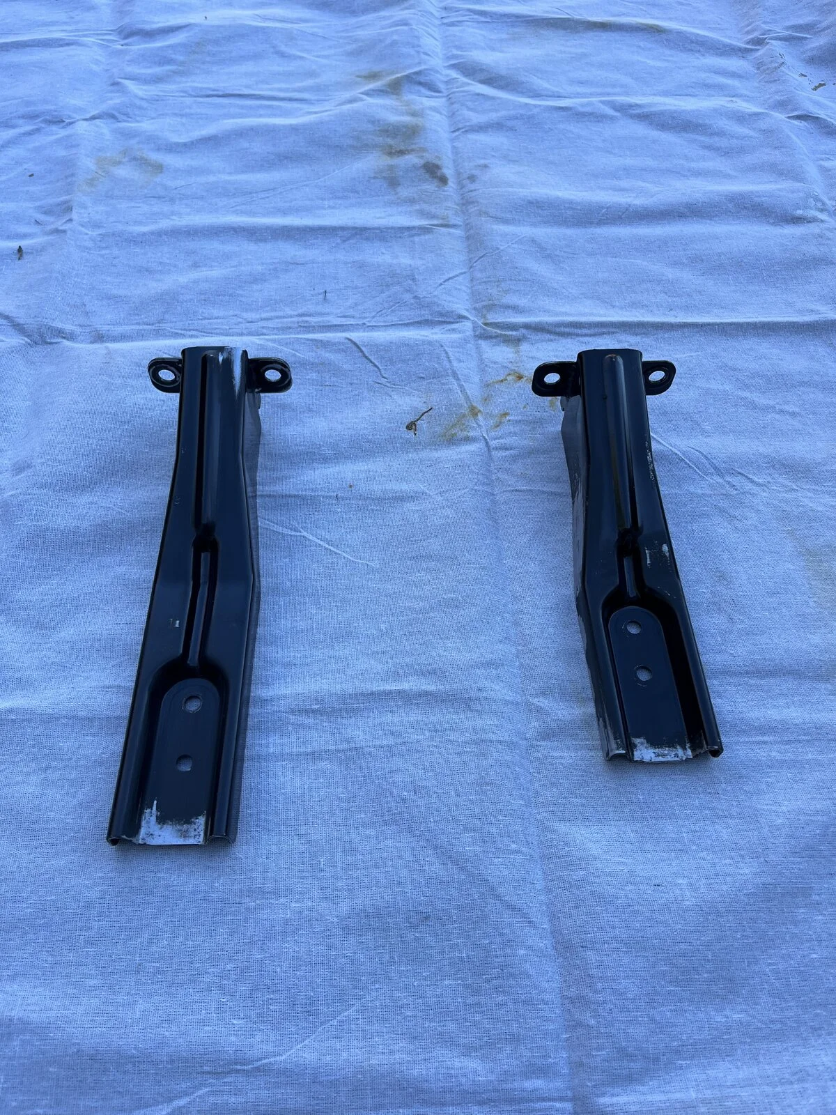

1. Install OEM side steps — already grabbed a set in awesome condition from FB marketplace. They’ve got a tiny bit of flash rust on the brackets but I’m going to hit it with a wire brush and slap on a coat of Rustoleum before putting them on. Other than that, they look brand new. Guy pulled them from his ‘04 a year after he got it and they sat in his attic since.

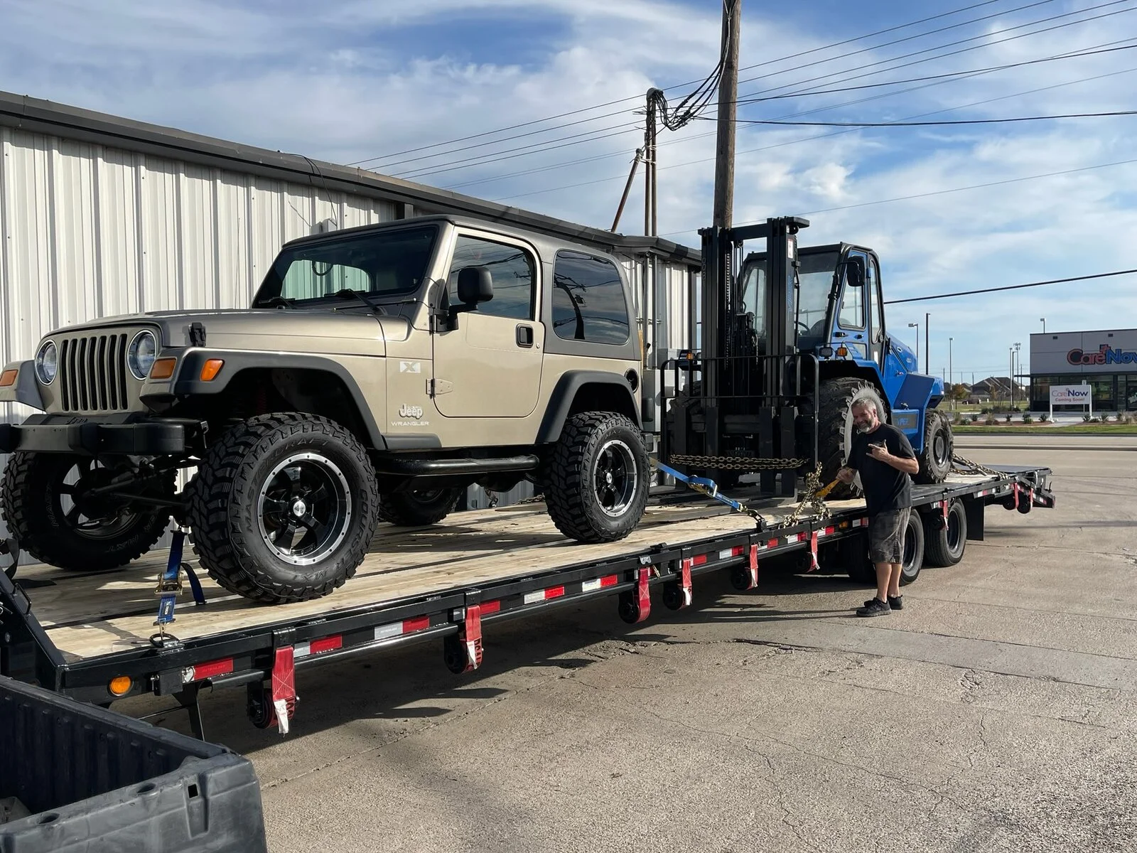

Hahaha okay okay okay, fair enough. It arrives tomorrow, but here’s a shot of getting loaded up:
Also finished a spruce of the OEM side steps I picked up on FB marketplace. Guy took them off his ‘04 a year after he got it and they sat in his attic. Had some flash rust and needed a good pressure wash, but they look brand new again. Wire brushed, Dremmel sanded, and hand sanded the brackets then hit them with a couple coat of satin Rustoleum. Soaked the bolts in vinegar then wire brushed those too. Steps got a thorough pressure wash to remove 17 years of dirt and dust.
The guy also sent me the mounting hardware but I’m not positive if it’s everything. I may post up a pic and see if anyone can confirm.

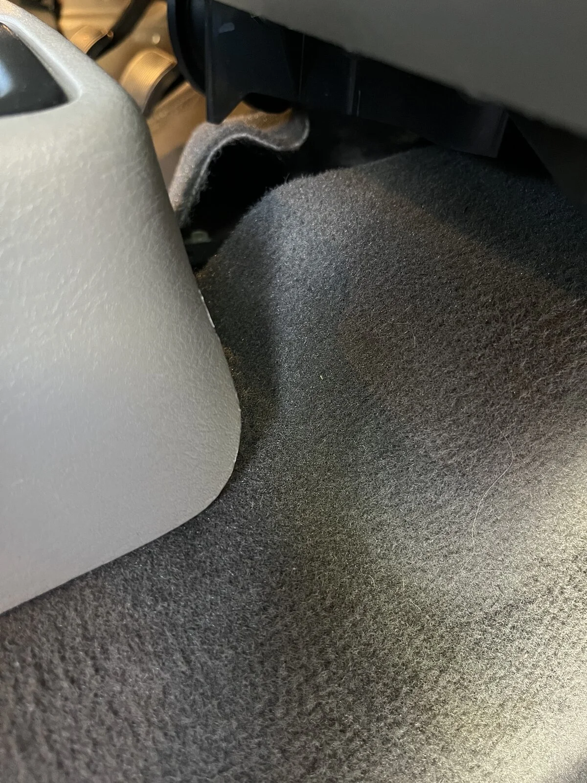

- CARPET NEAR FRONT OF FLOOR CONSOLE: So this is kind of a weird one. I was sitting in the driver’s seat and it caught my eye; the carpet doesn’t quite come together so you can see some metal/parts underneath. I honestly don’t recall what this area looked like on mine — I don’t remember the carpet being two pieces coming together in that section. I thought it was one piece that kinda formed a box to cover that section. I’m not quite sure how to fix this and would love some input here. Would also like to see this area on someone else’s TJ. I kinda half-assed tried to yank it over so they’d meet but it didn’t seem to want to stay. I can confirm the carpet is original from the factory and it’s in great shape. Pics below. How would you suggest fixing this weird carpet coverage issue?

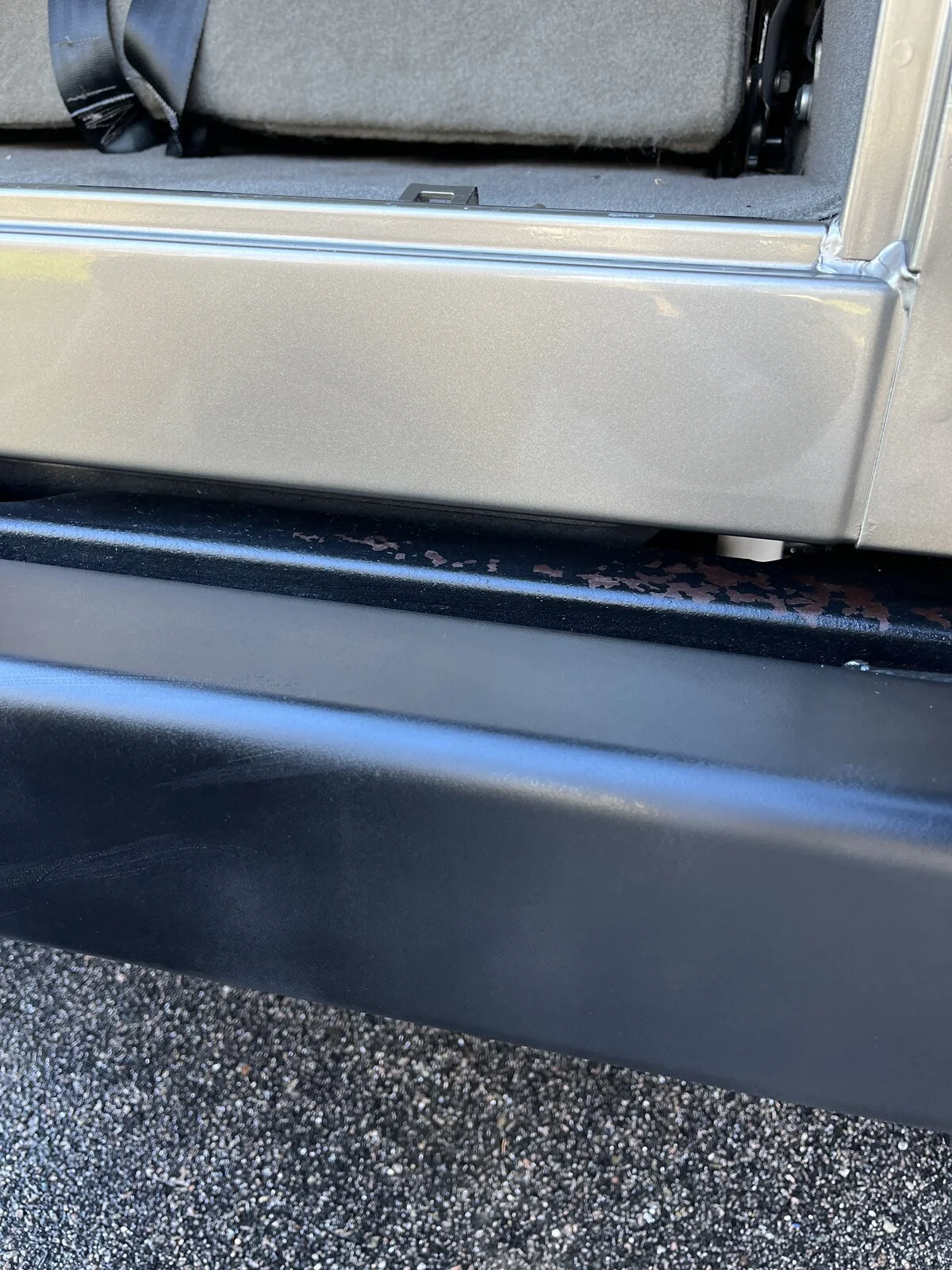

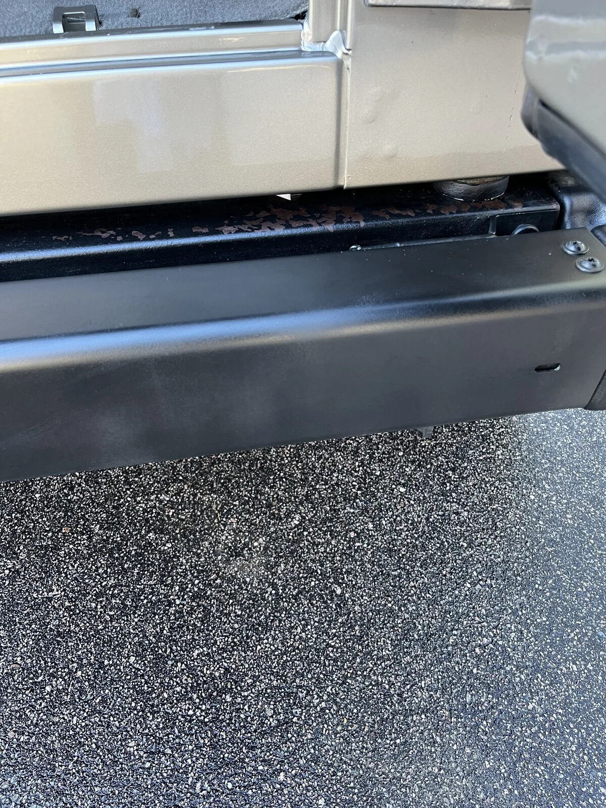

- REAR BUMPER SURFACE RUST: Just underneath the tub on what I think is some portion of the rear bumper, there’s some surface rust where paint came off. Actually, I’m not even sure this is the bumper — it almost looks like a bracket that goes over the frame. So my first question is: What is this part and can I access it or would I need the help of my Jeep shop? My second question is: If I can access it, can I replace it or should I sand that section then paint it? Pics below.

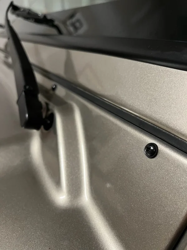

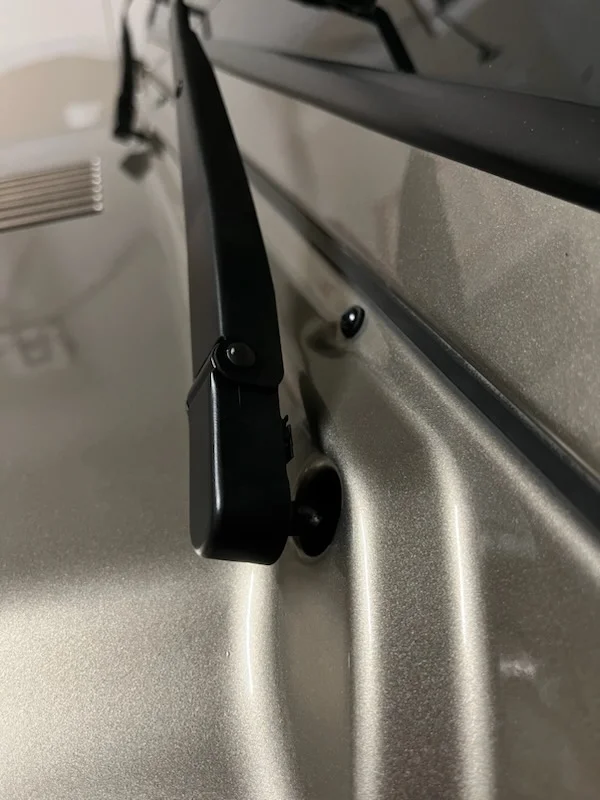

Got a couple minor things done today. Replaced the 4 trim screws that sit under the windshield, painted the wiper arm posts, mounted new wiper arms with blades, and fixed a weird texture issue I had on the steering wheel airbag cover.
The trim screws were tricky to track down without a built in washer on them, but ended up finding a #8 stainless screw with the head painted black at Ace Hardware. Paired it with a black rubber washer and it looks great. Seems stupid, but even 4 brand new screws make a world of difference compared to the old oxidized rusty ones.
Those wiper arm posts were oxidized and showing their age, so I hit them with the same satin Rustoleum I used on the sidestep brackets. Removed the old wiper arms, taped off around the hole, and did it with a small paint brush. Looks much cleaner.
Wiper arms were also super faded and showing their age so they had to go. Installing the new ones required them to be bent a bit so they’d sit just right. I also didn’t realize that once you close the clamp on the arm base, the entire arm kinda clamps down to the window. I spent way too long messing with the bend to get them to sit right but didn’t want to clamp them so that I could keep making adjustments, only to realize they’d snug themselves up once I locked them in. Learning curve to wiper arms. Who knew!
