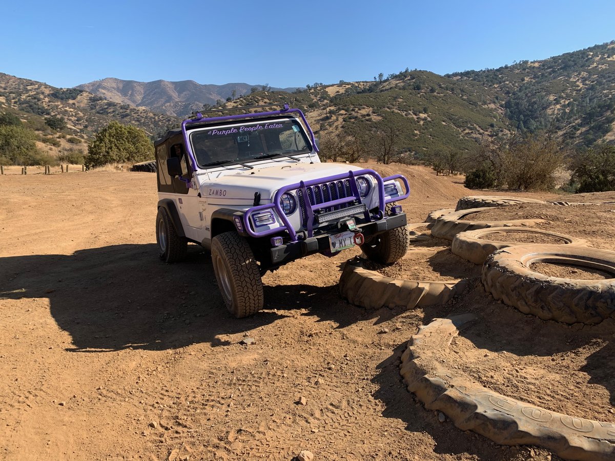

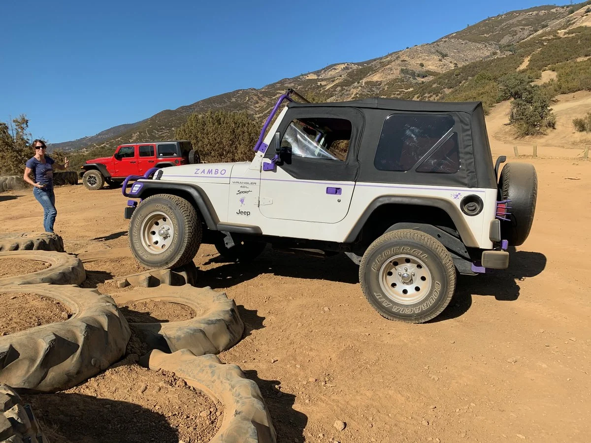

Running 31's here. They are good for moderate wheeling and no issues at all on the road. It all's comes down to building it out to what you will actually use it for. No use in doing a 33 build and all the extra expense if you don't plan on hitting the harder trails on a frequent basis. You can skimp on cheaper components but ultimately you get what you pay for. If you build it out...build it right. Save now with lower quality....pay a lot more later. I'm on the road more than the trails....but you can still have a lot of fun with 31s and a 2" lift on the trail.
