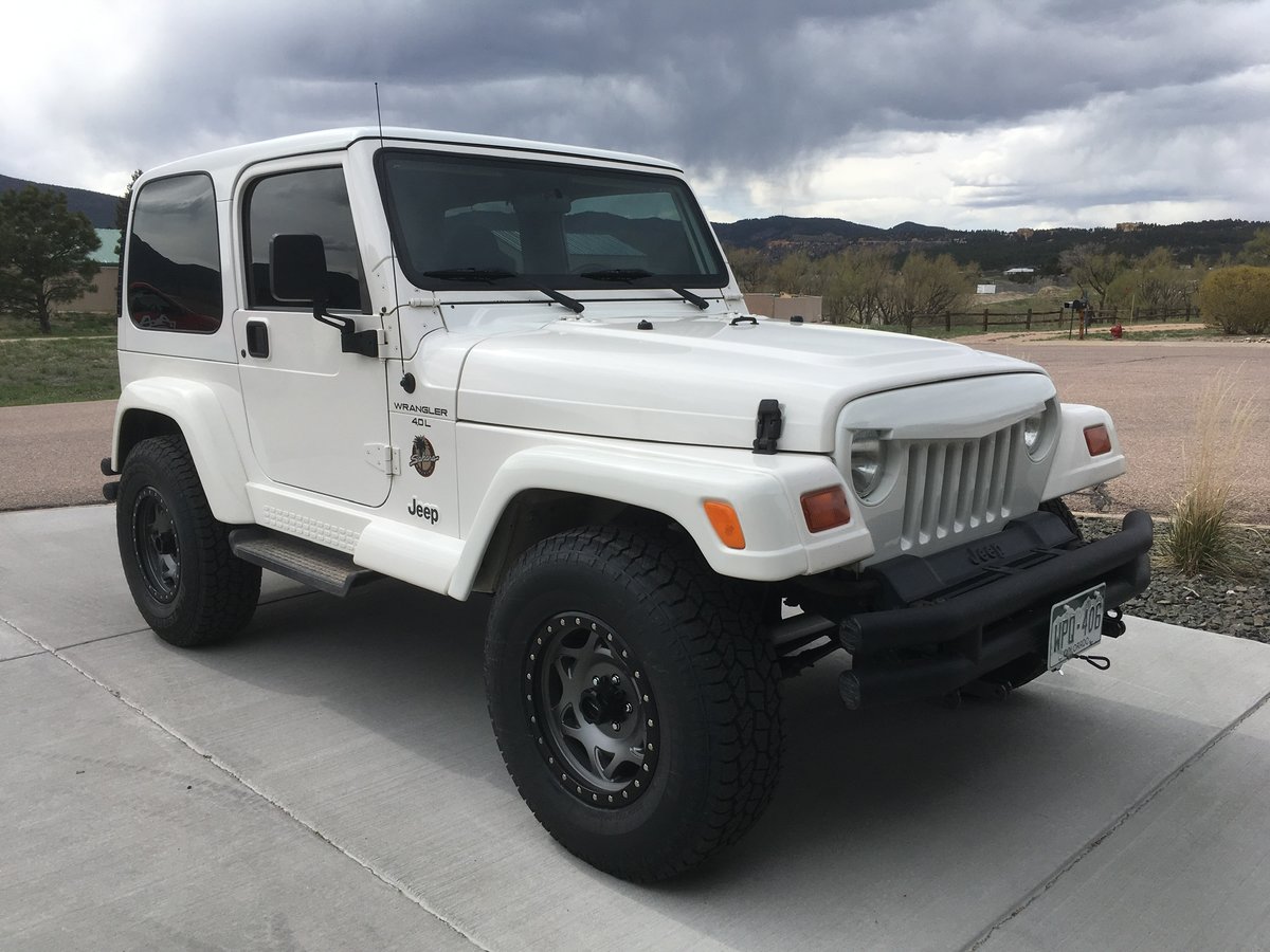

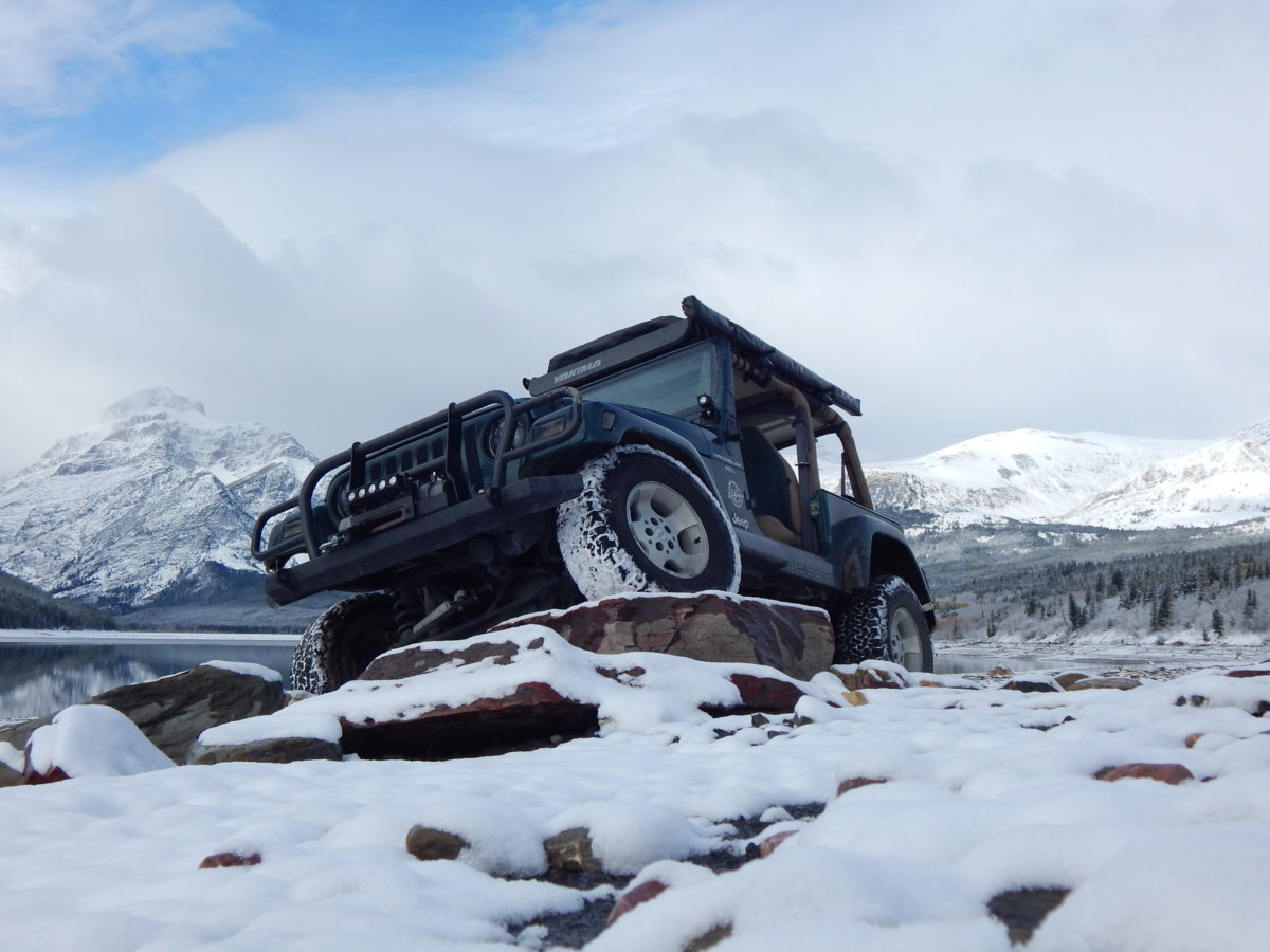

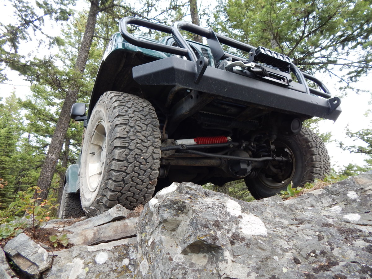

Oh I absolutely love my 31's.
Don't get me wrong I love bigger tires too, but I love the look of a stock-ish TJ with 31's. Obviously your limited to the type of obstacles you can take on but that goes with out saying. I get out all the time on all types of trails and terrain and every time I go out exploring with my Jeep I am consistently impressed with its capability.

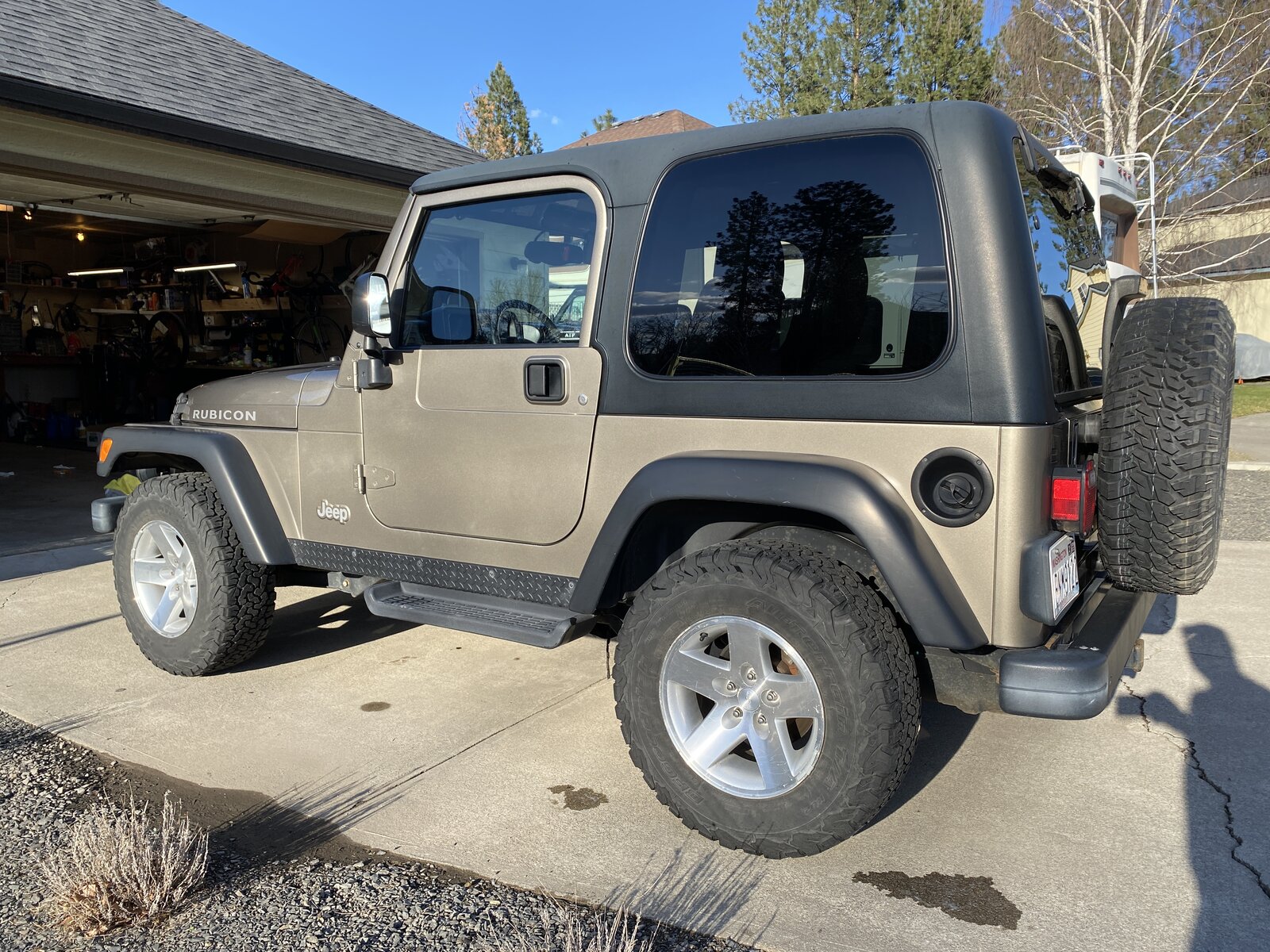

I think the best budge build is a Rubicon manual on 32’s with 2.5” OME and a small tuck. Take you many, many places.
That’s what I have and it gets me everywhere I want to go. No re-gear needed, goes as fast as I want and handles well or as well as a jeep can be. I don’t feel the need to impress anyone with it. If you don’t want to wheel with me because I don’t have 33s or larger and a 4” lift I can live with that. Clubs have too many rules and my wheeling buddies just want to go out and have fun.
