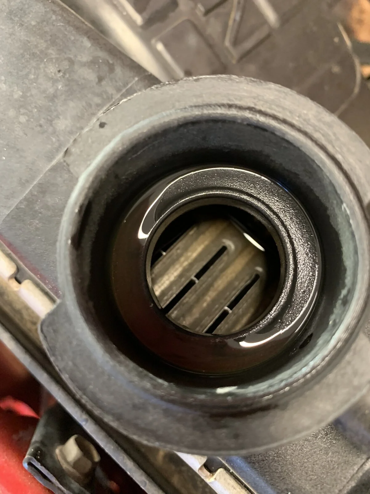

This a pic inside the radiator. When I drained and flushed the whole system, including the engine block, a few rust pieces came out but overall not much came out out and coolant was clean.
If it’s not the radiator, I’m not sure what could be causing the hwy temps to increase into the mid 220s (per OBD reader) but no issues driving around town or off-roading
