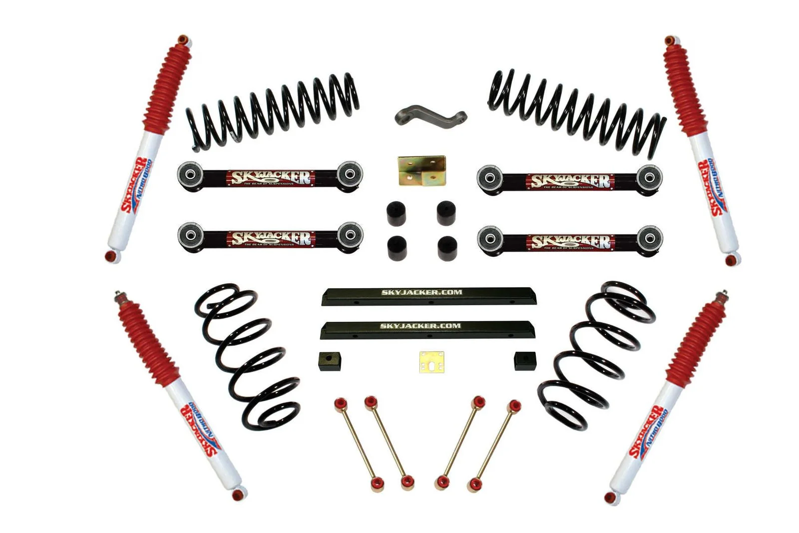

Here is the Skyjacker 4" economy kit. $631
https://www.quadratec.com/p/skyjack...4Zi1QwKTXywDrJdcp6Kvlm2XStR1-4axoCJWcQAvD_BwE
Here is the Zone 4.25" Combo Kit. $557
https://www.extremeterrain.com/zone...ge&gclid=CKGP9_G2kd0CFa6XxQIdJx8Azw&gclsrc=ds
There are three areas of design that need to be discussed and compared between these two kits.
-SJs inclusion of a dropped pitman arm.
-How does Zone create 4.25" of lift without lowering the transfer case?
-Why did Jeep use a stamped steel control arm?
Discuss!
That dropped pitman arm on the Skyjacker lift just shows that it's a poorly designed kit.
I'm unsure of how Zone can sell a 4.25" lift without including a transfer case drop. Better yet, I know how much I had to drop the transfer case with just 2.5" of lift, so with 4.25" of lift I have to assume your transfer case is hanging really, really low!
Those Skyjacker control arms look like they might not have as much misalignment as the factory control arms. Maybe I'm wrong?

That dropped pitman arm on the Skyjacker lift just shows that it's a poorly designed kit. ....
But why? What do you know that SJ hasn't figured out since the Clinton administration? :)
Did you have a motor mount lift? Was this on a Rubicon?
Not wrong. Why are the factory arms able to misalign further than SJ arms?
I think zone gets away with no tc drop by using a mml.
Correct. What does the MML do? How else do they minimize the rear drive shaft angles, while still creating similar tire clearances as SJ's 4" spring lift?
I wonder if you could eliminate the mml by raising the tranny a bit by stacking a couple washers like @Ranger_b0b did, between the skid and the bottom of the tranny...don't know but it would work theoretically. :)
That would raise the wrong end of the drivetrain. I suspect that Ranger_b0b stacked washers between the skid and frame. This is a transfer case drop. However, the clever design here is that the drop is only as much as is necessary to eliminate vibes.

Unless you're dropping the track bar along with it, you shouldn't need to drop the pitman arm either. Dropping the pitman arm would only make sense if you had one of those track bar drop brackets installed along with it, as you'd then be changing the geometry of everything.
Of course there's other situations as well, like let's say that someone was installing an 8" lift of something. Of course at that point, you'd probably be running full width axles, hydro assist, and you'd be well beyond where most of us are in terms of builds.

No, I didn't have a MML, and it was on a Rubicon. Maybe I'm not the best example.
The factory control arms may be stamped steel, but they have that u-shaped channel which allows the arm to flex and twist to some degree, allowing the axle to articulate / flex more, without adding additional stress on the control arm mounting brackets.
This is my understanding of it at least. I'd rather run fixed length stock control arms than those fixed length Skyjacker arms. You'd probably be more likely to rip a control arm mounting bracket off with one of those things. Not saying it would happen the first time you flexed, but I suspect if you repeatedly did it, it could cause a weak point over time.
No, @KCsTJ had it right. I raised my Transmission in relation to the skid. However, I was chasing a very specific problem so I wouldn't recommend it as a general fix for vibrations. I was experimenting a bit. I had installed a 1" MML with my 2" spring lift and 1.25" BL. I was getting driveline vibs at 60-65 mph. When I measured my angles, There was a difference between the T-case and Yoke (as I knew there would be) I figured with the Rubicon and its longer DS I could get away with running the Tcase and yoke at the same angle, so I put the washers in there to try it out. It works. However, while I was under there, I also found that one of my U-joints was on its way out...so I replaced that as well. Not sure which "fixed" the issue, tho I suspect it was the U-joint. I may pull the washers back out just to see what happens.

Here is what we have determined...
Skyjacker's inclusion of a dropped pitman arm, by itself, will disrupt the steering geometry creating bump steer. Skyjacker has been screwing up people's steering for 2 decades. The internet forums have been fixing their lazy stupidity for nearly that long.
Zone divides the lift between spring and body. This minimizes the rear drive shaft angle. Additionally, Zone uses a motor mount lift to further reduce the rear drive shaft angle. This multi part solution to creating clearance reduces the likelihood of needing a transmission drop. If one is needed, it will be less than the SJ dropped transmission bracket.
The factory control arms use a bonded rubber bushing compared to Skyjacker's split rubber bushing. I'm less familiar with the meaningful differences between the two. While I don't believe this to be the case, let's assume the two have the same amount of misalignment capability.
When the axle flexes and the rubber bushing reaches the end of it's misalignment capability, the Skyjacker design reaches bind. Now that force is transferred to the rigid arm, which is then transferred to the rigid control arm mounts. If the force is great enough, something will fail.
The factory arms are designed to twist, which means that the flexing axle can misalign both the rubber bushing and twist the arm to a far greater degree before something reaches bind. Understanding this ability to twist is why Zone does not include replacement arms in this budget minded kit.
The Zone kit also includes a raised rear track bar bracket. This will mostly center the rear axle. And it raises the roll center of the Jeep, which will minimize a small amount a body roll through better geometry.
These are all reasons why the less expensive Zone 4.25" Combo kit is a very thoughtfully designed budget kit.
Another hidden benefit to the Zone kit is that it is a great starting point for a larger, more comprehensive build. The addition of adjustable track bars and control arms does not have you replacing parts of the kit. The body lift and motor mount lift are a set up for a tummy tuck.
So far, there has been no comparing of shocks between the two kits. I have not used either, so I can't comment.
The bottom line is that for less money than other budget kits, Zone provides better results and creates a solid platform for an even better build without having to start over to the degree that other cheap kits often require.
If I were to give a reason for why I dislike Skyjacker, it is because they understand marketing more than they understand suspension.
