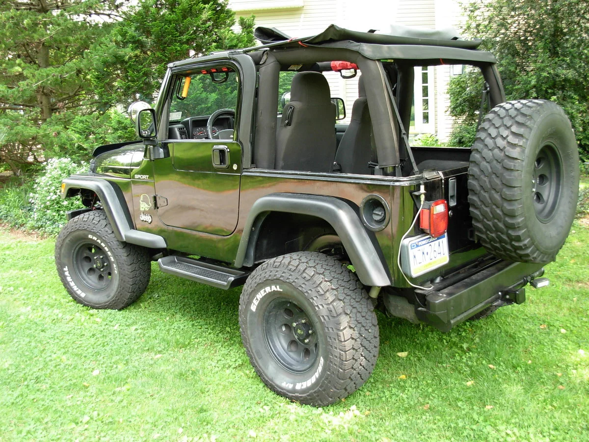

This flies in the face of all convention but I have no vibration issues. 2004 TJ manual with 4" of lift, 1" body lift, 1" trans. case drop, original drive shaft, no SYE. Bought it from PO like that.
They're all different but your tcase drop is why you're not having vibes.
