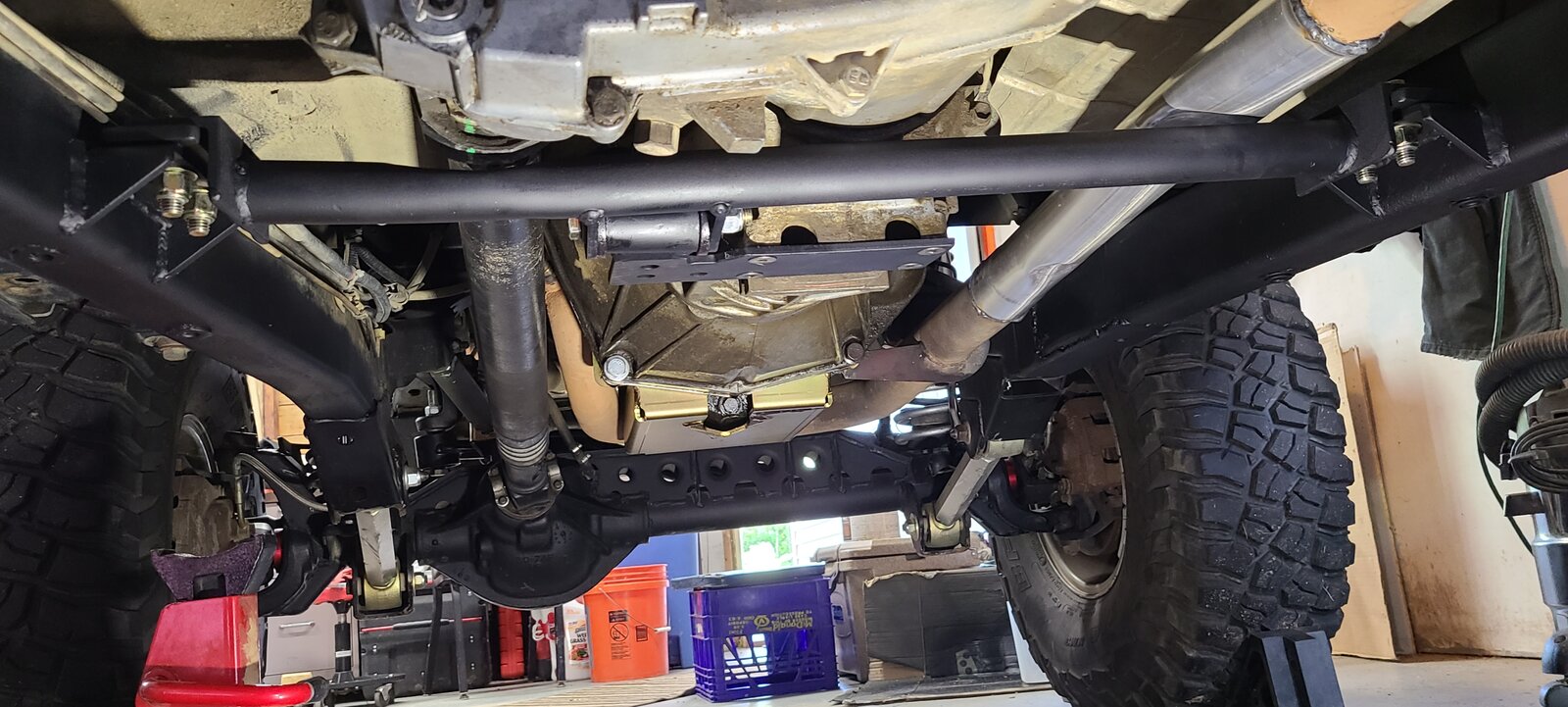

It does until you get sick of that supporting the trans and Tcase and build a stand alone mount so you can drop the skid for access and maintenance without supporting them. Man I wish I had done it years ago now that I have done it.
I made my own as well. I modeled it after the old 33 Engineering crossmember and skid plate. I love being able to drop the skid plate and work on it without having to jack up the drive train.
Looks exposed.
Ever worry about getting bonks and stonks on your TC?

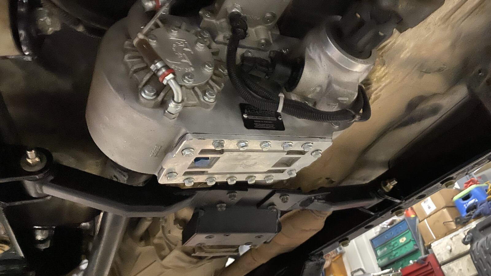

TurboTJ
Jan 5, 2019
1,018
Walnut Creek, CA
Nope, that's my own creation. Inspired by many around this community.
Your mount appears to allow no rotation of the power train around the torque axis. I would think that after awhile the metal plate that bolts to the TC might fatigue and fail due to this.
