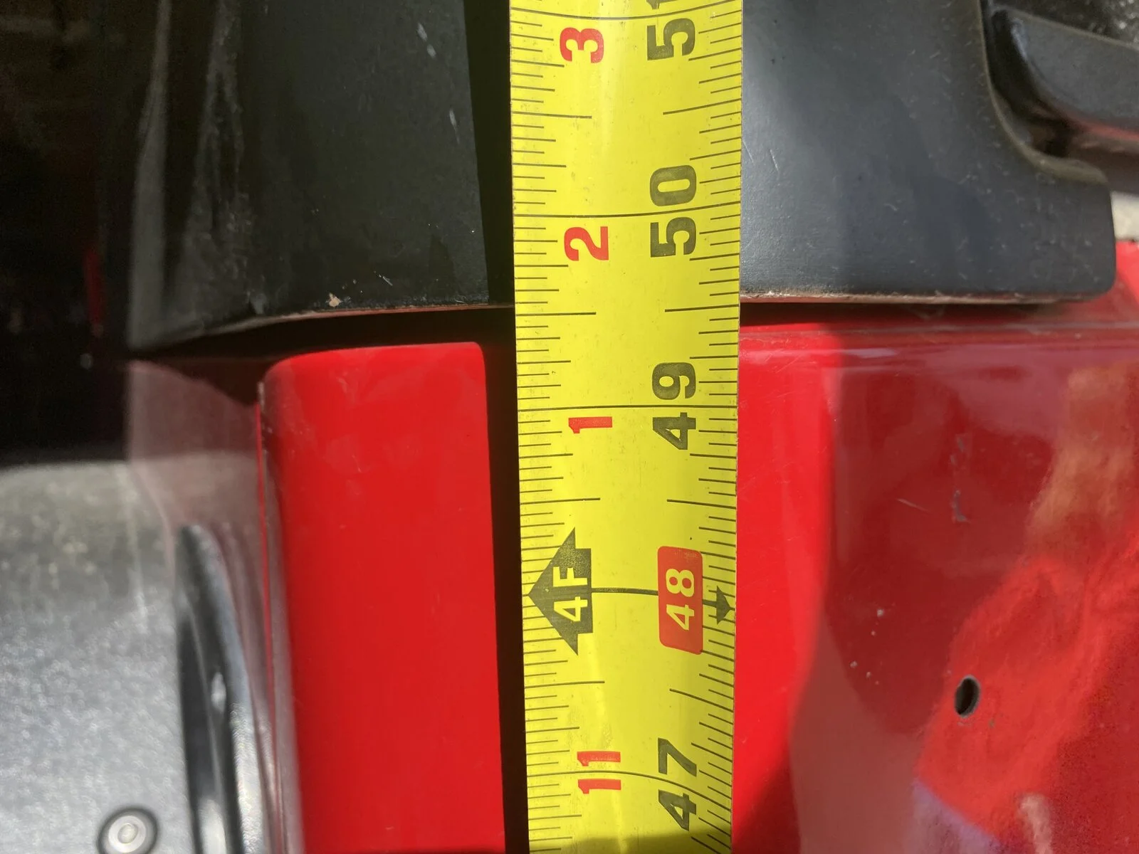

I've noticed that the TJ leans a little on the passenger side for a while. Before I had some recent suspension work done. It wasn't until recently when I had the tire carrier open that I noticed it to the extreme.
I measured it with everything in its place. Tire carrier closed. 3/4 tank full. My wife not in the passenger seat. 😕 It dips about an inch on the passenger side. New shocks. New control arms. Newer front end. Same old RE springs.

I'd love to know what's going on. I've crawled around and looked at everything several times. I have no idea.
Driver
Passenger
