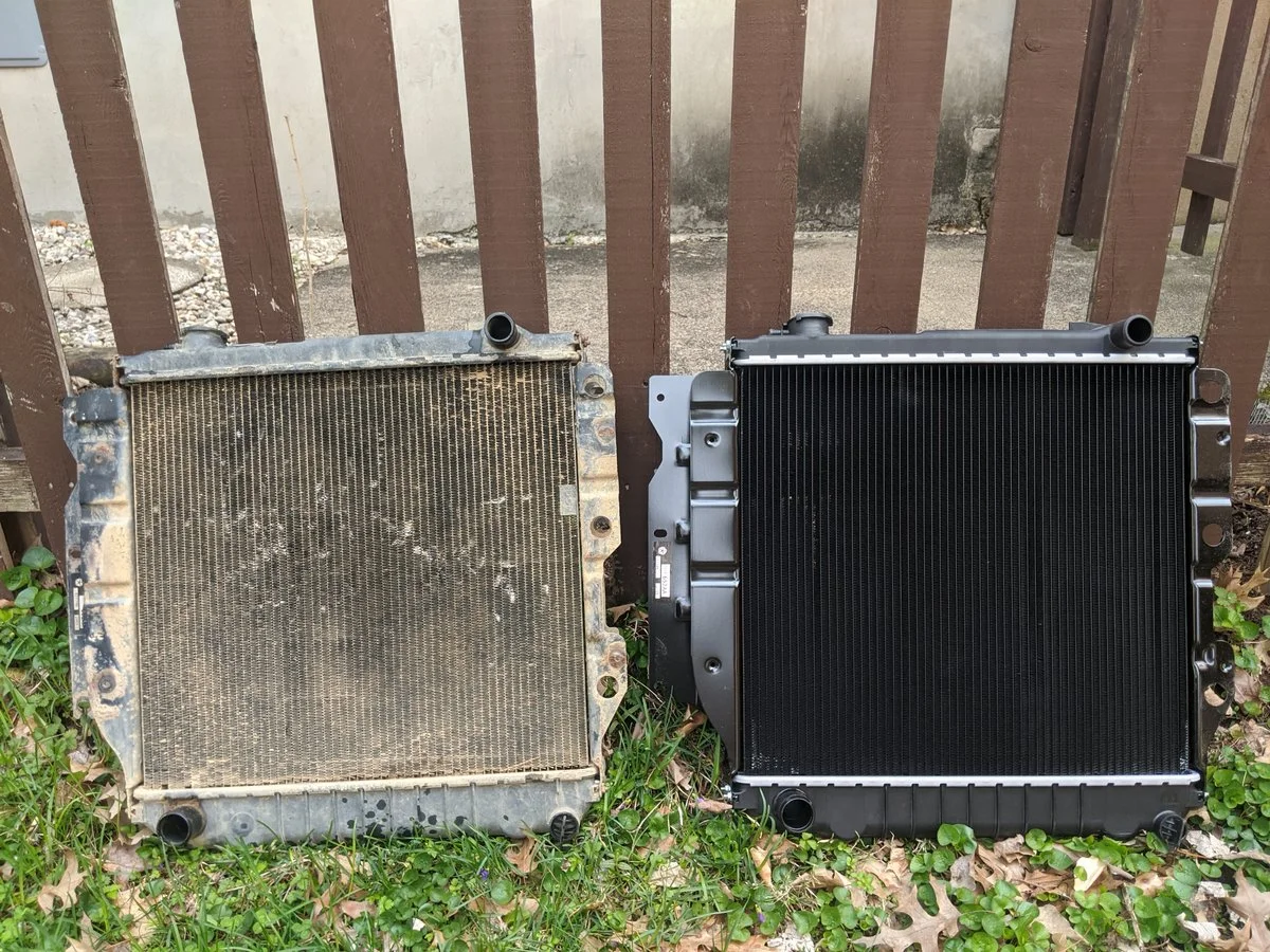

Following the helpful advice of some forum members, I checked the radiator. It was NOT a Mopar. So I ordered a Mopar radiator and swapped them out.

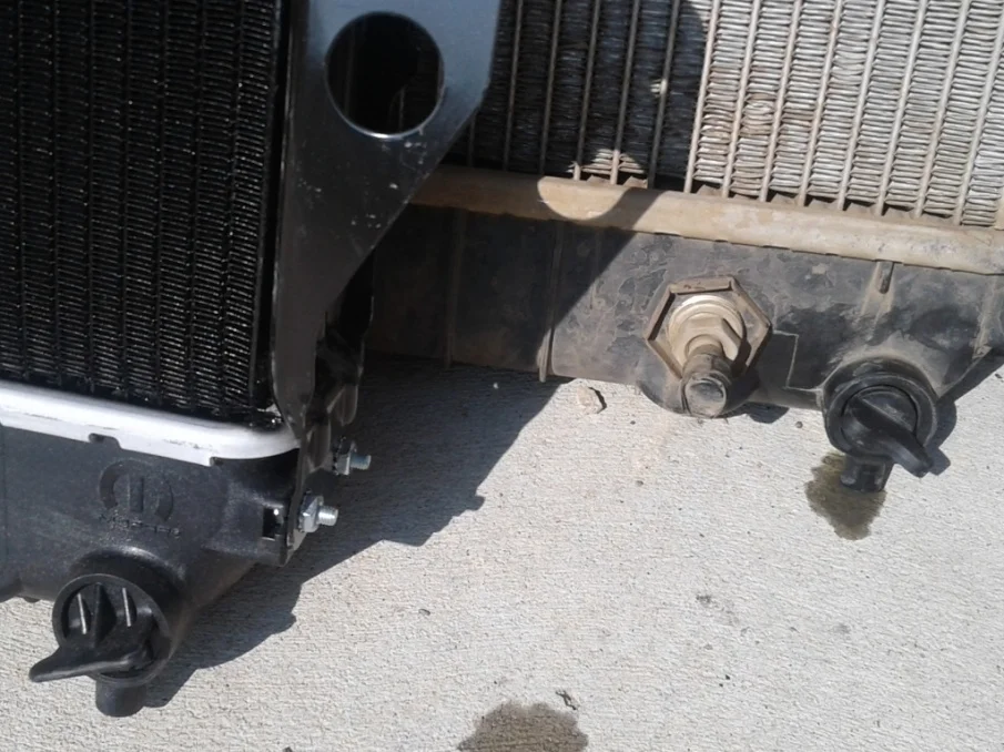

You can tell a Mopar by the embosed logo on the back side of the lower tank, above the drain valve.
The first thing you'll notice is that the new Mopar unit is black and the aftermarket is bare aluminum. If it's the common black coating used in the air heat exchanger industry, it's usually referred to as "e-coat", which most simply might be described as underwater powder coating. It has negligible effect on heat transfer but it does extend the life of the heat exchanger by preventing corrosion.

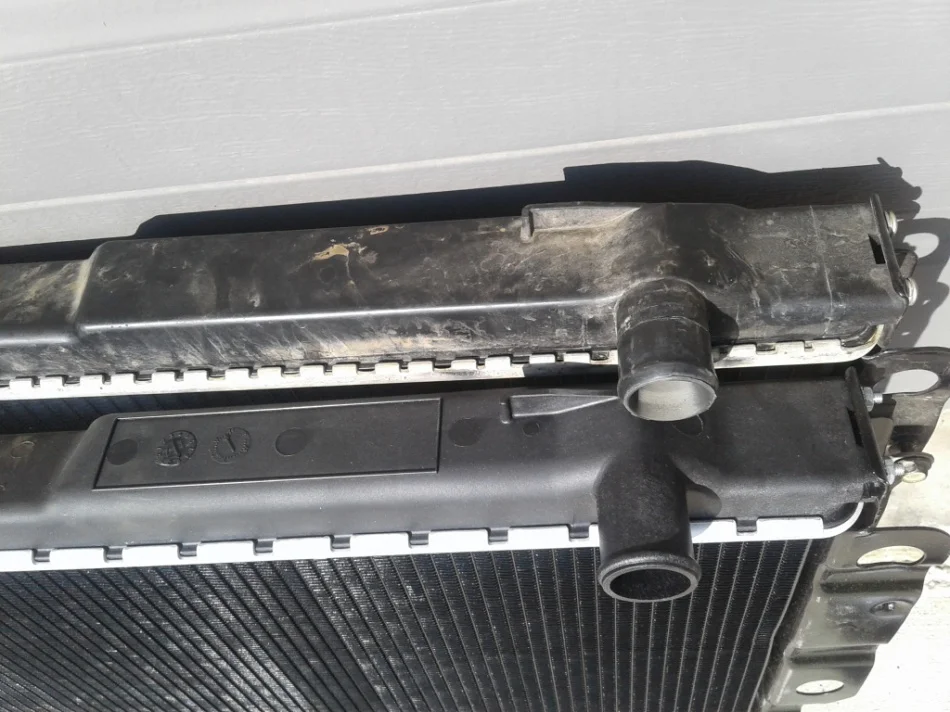

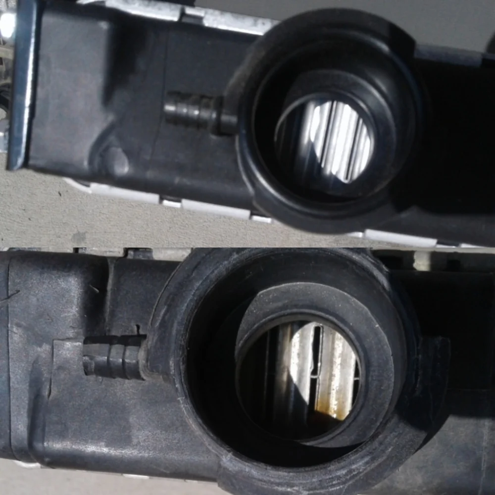

The top shows that the upper tank/header is similarly shaped but definitely a different mold as the joint lines are in different places and the radii of the curves are different. I'm curious what the feature is next to the inlet connection that appears to be a stiffening rib or something?
