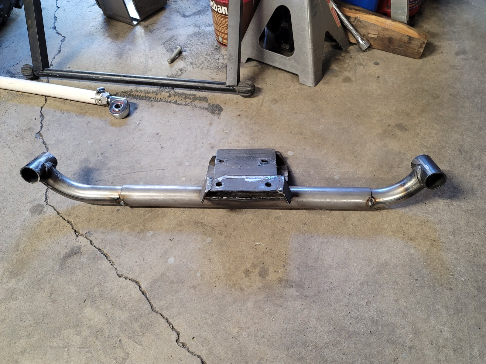

OK I found out part of my issue with the rear axle. The spot weld on one side of the truss broke loose.
So I need to pull the axle and fix that. Then I can go from there.
I pulled the transmission crossmember to weld it also.
