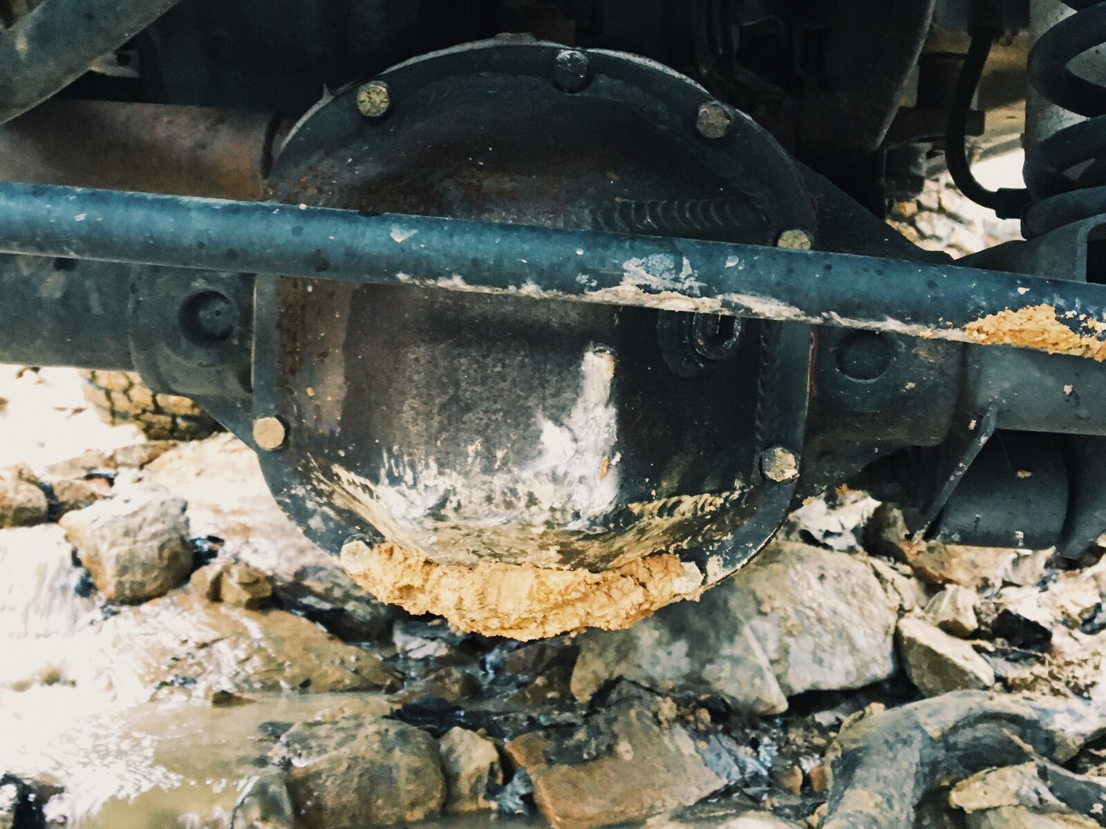

This is why people advise against those. If I had a press I could probably put another bend in the track bar to clear, but I don't so I had to settle for an extra 2" of bump stops
I've never seen anyone advise against them so guess I learned something else. I haven't had a stock Dana 30 in mine for a long long time. And the cover I took off my Dana 44 was a lot bigger than what you are showing. I went to one from Ruff Stuff because it had more room.
This is the 3/8" Dana 30 cover from RuffStuff. I'm willing to sacrifice the up travel for the protection until I get a press. I came down hard on it a while back and it took the beating like a champ.
I'll let JMT post up a picture of my old Dana 44 cover. The thing was HUGE but has great protection and with my old steering wasn't a issue but with my new setup I'm pushing for every inch.

I'm likely going to have to bite the bullet and get one of these for the TJ, when they're back in stock. Even my Alloy cover kisses the Currie track bar at full stuff. Making bigger parts designed for a 4" lift work on a low lift build and 31" tires is more challenging than one might think. On the positive side, I can put the Alloy cover on the new LJ!
