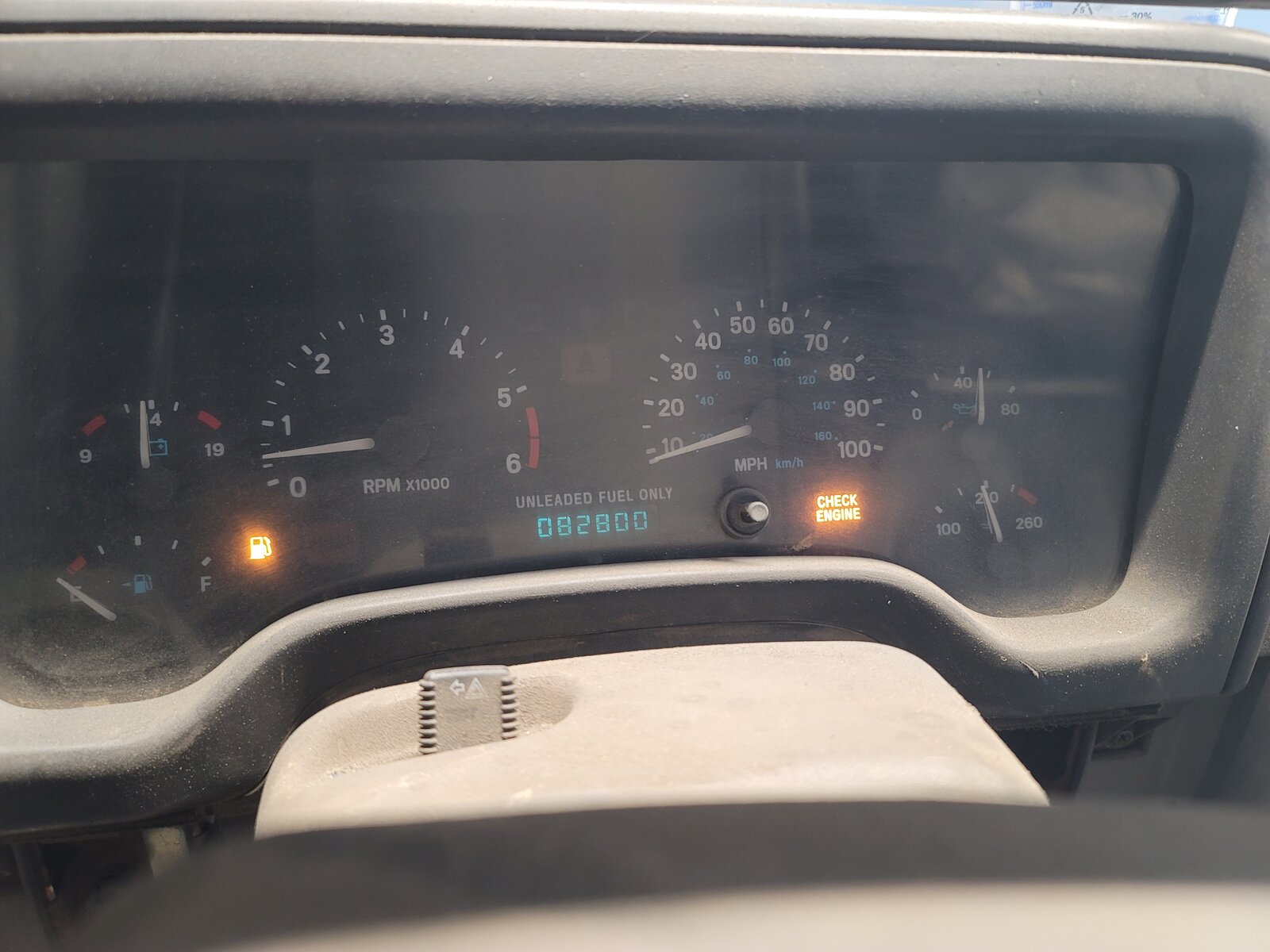

Just a short video of the dash while running. And yes I've still got the Check Engine light due to the transmission throwing a code. I need to run it thru the gears & then check my fluid levels to see if the transmission is possibly low.

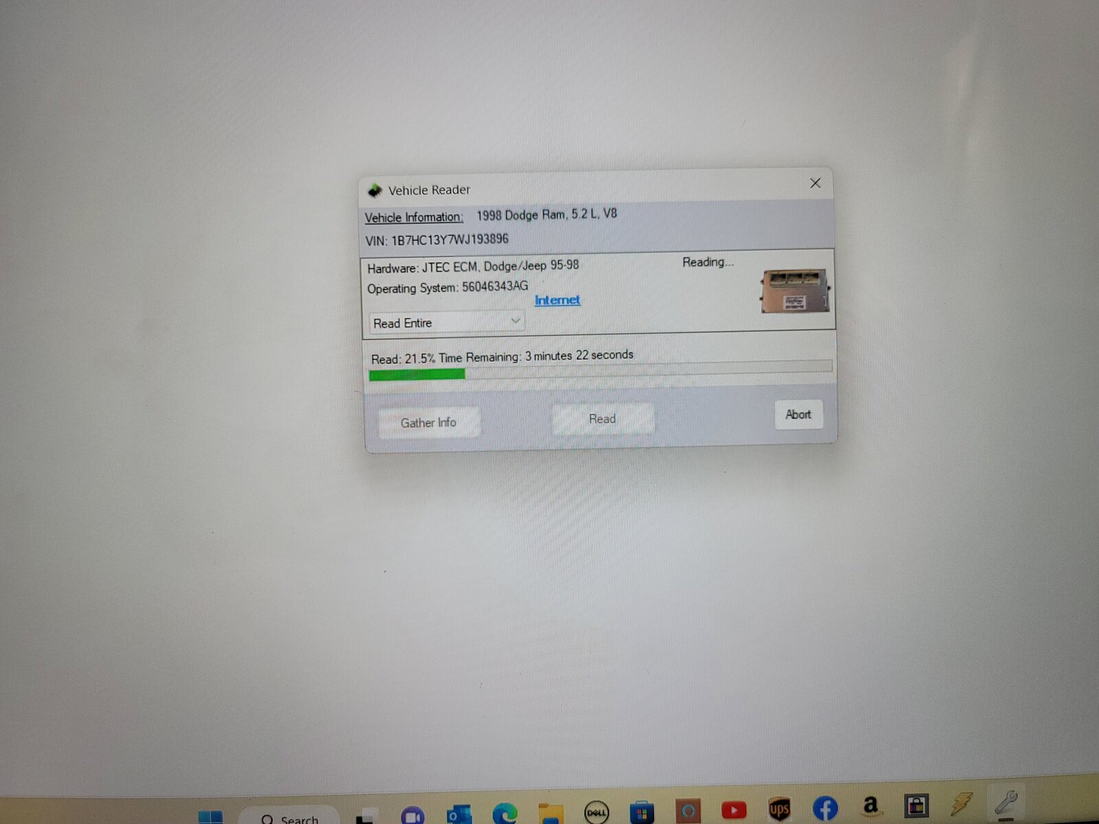

Started figuring out the HPTuners software and got the PCM downloaded so I can send it to Ryan @ FRP. This is a totally different deal than what I'm used to.
I now send this file to Ryan & he will write me a tune for my engine. Then I go thru a process of downloading the file he sends back to me & that gets installed onto the PCM in the Jeep.
Dash while it's running.

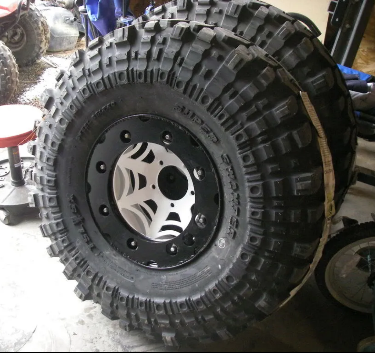

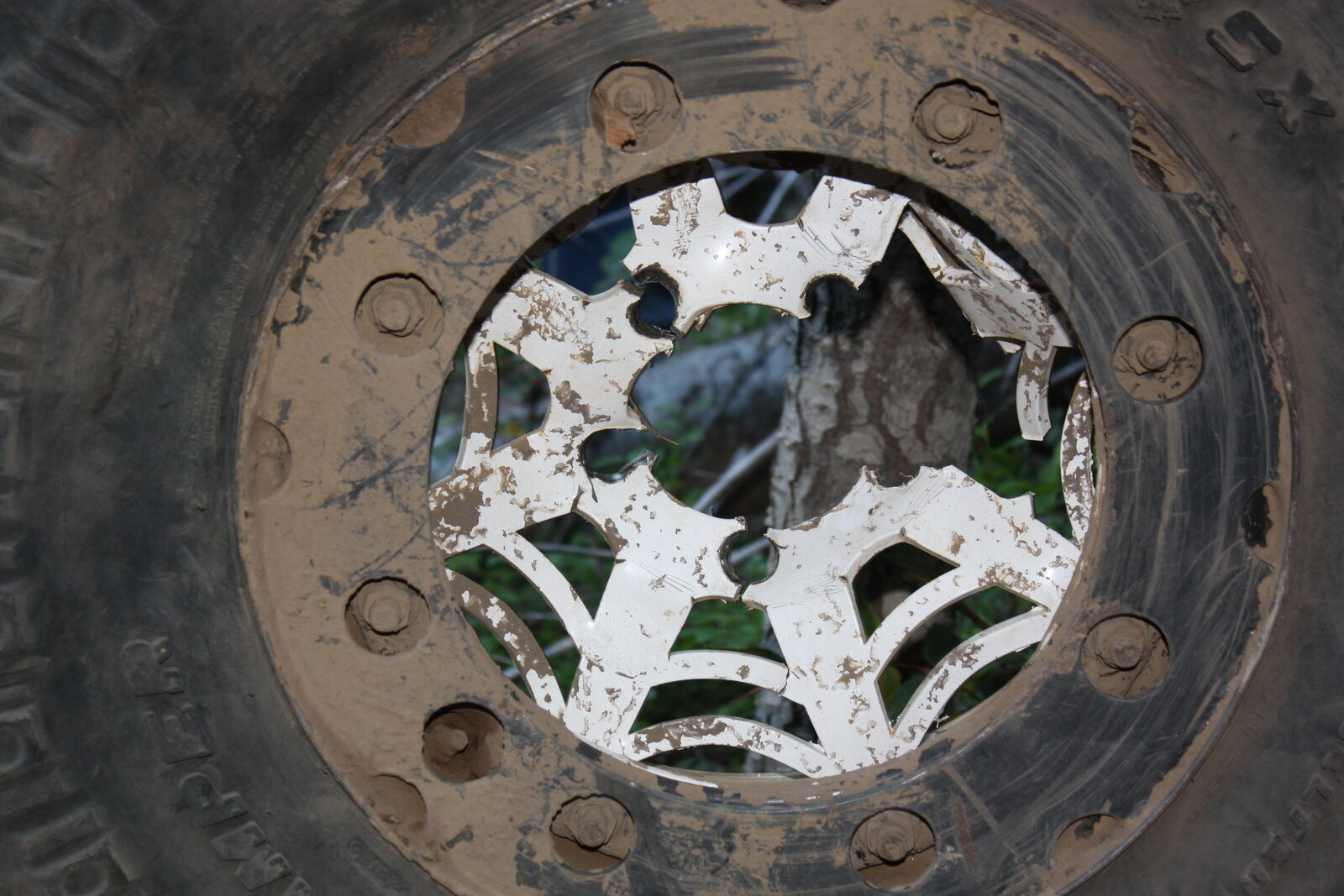

I had those same tire on my Toyota with some re-centered H1s from Trailworthy Fab. The tires worked great!
Which tire? When I went to recentered H1's was when I went from 35x13.5x15 Toyo M/T's on single beadlocks to 38x12.5x16.5 TSL SX but I had 8 bolt H1's that I'd recentered myself.
But then this happened

I fell in LOVE with the TSL SX tire when I saw my first oines on a guys Jeep in W VA on a 4 day wheeling trip. It's when I got my nickname "wildman". I had a 1986.5 Nissan Hardbody pu back them riunning Q78 GroundHawgs.
They even work OK aired down in the snow.
