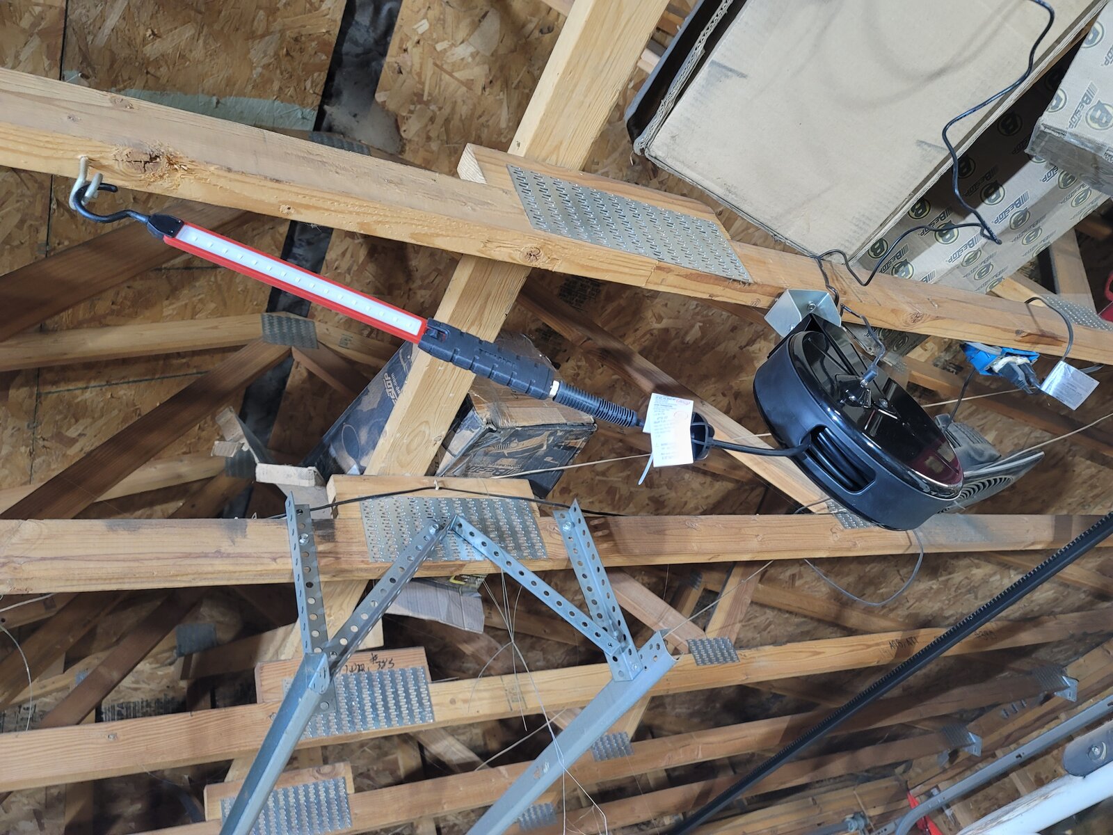

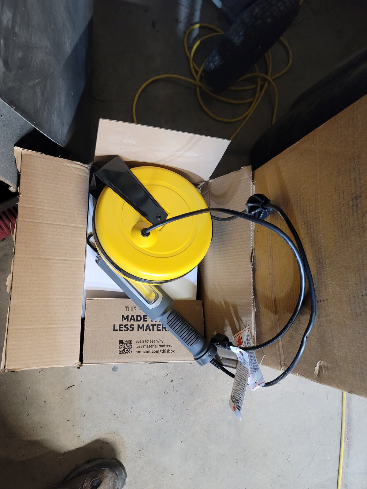

While I was watching the paint dry I swapped out drop lights. The one I'd installed last month started smoking and making a buzzing sound. So it was unplugged and I ordered a new one.
This is the old one. I'll contact the vendor about it and see what they say.
New one installed.

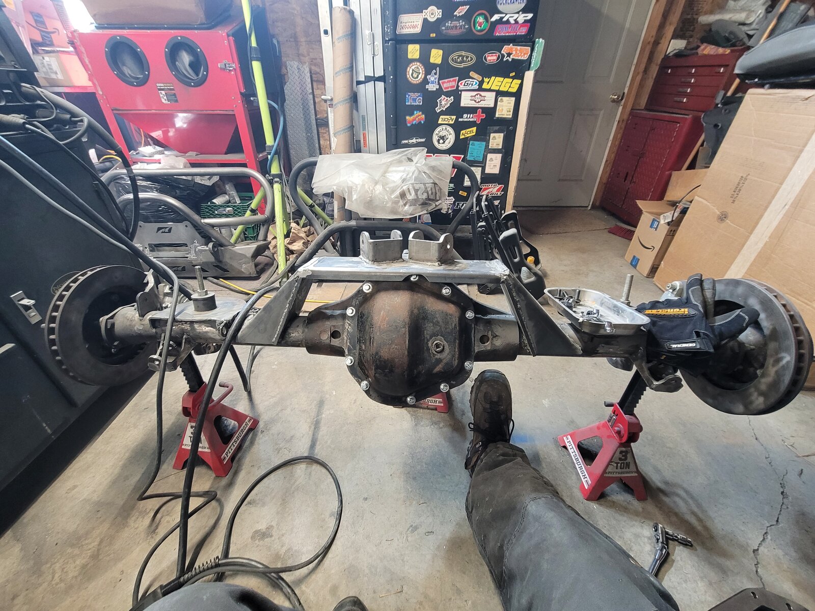

Next is getting the rear axle ready to be installed.

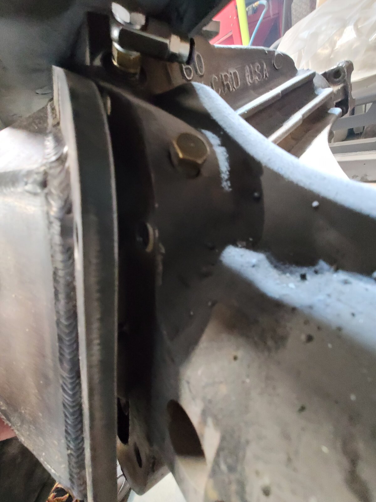

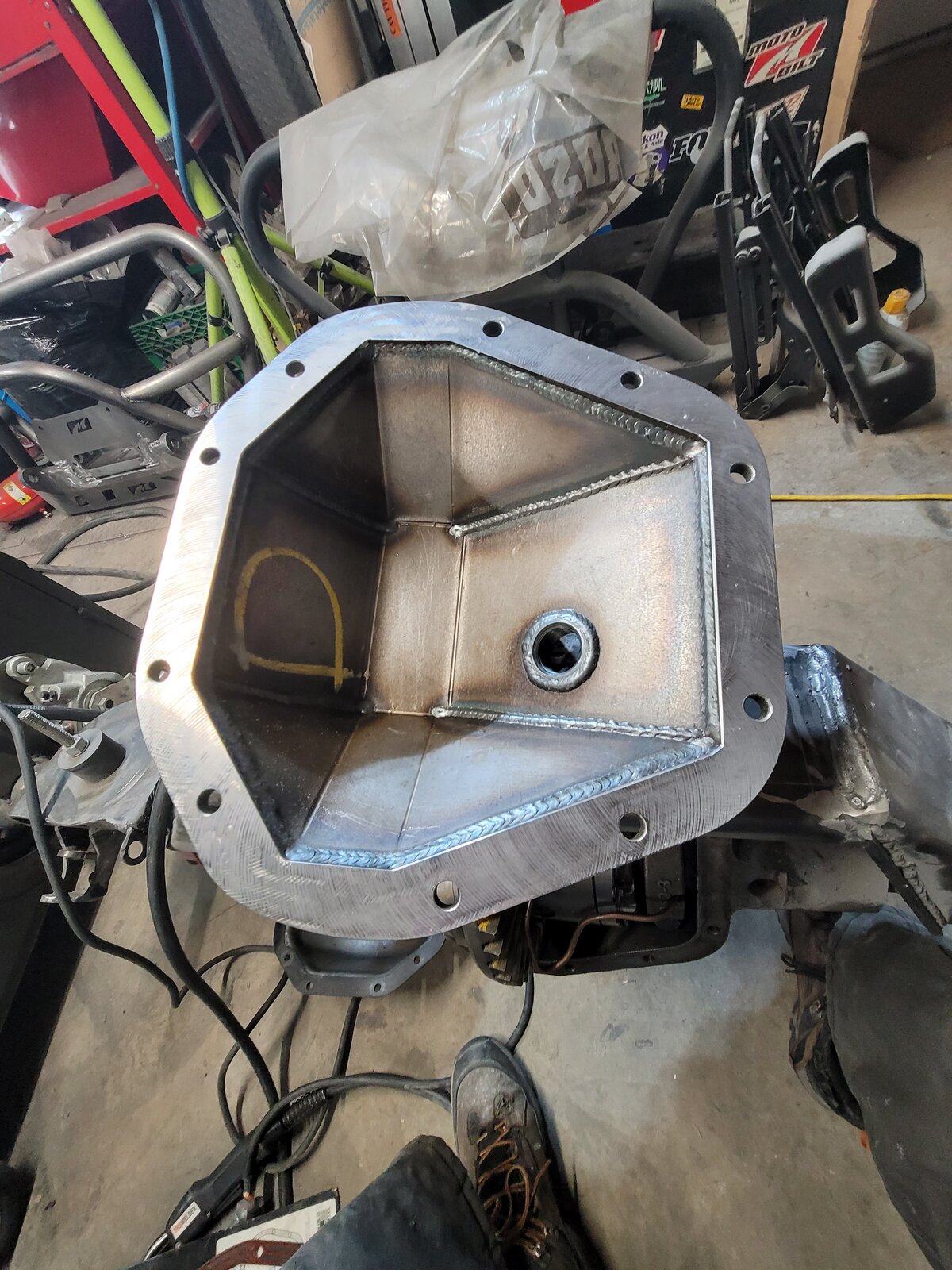

Huston we have a problem!
I'd ordered a RuffStuff diff cover for the rear axle. I'd wanted to use the heavier cover as a possible help for the housing flex. Right or wrong my thoughts were it might help.
Well I'm not sure if it's the Super60 ring gear or? But it doesn't fit.
So I'm just going to install the stock cover for now and will contact RuffStuff about it and see what they say.
Not a show stopper but still a bummer.

I talked to RuffStuff about it and they asked me to take some pictures of it. And then put grease on the ring gear & the bearing caps. So come to find out it isn't the ring gear that is the issue but the copper line for the ARB. I'm going to send them the pictures to see what they say. Might not be a solution but I appreciate that they are willing to look.
