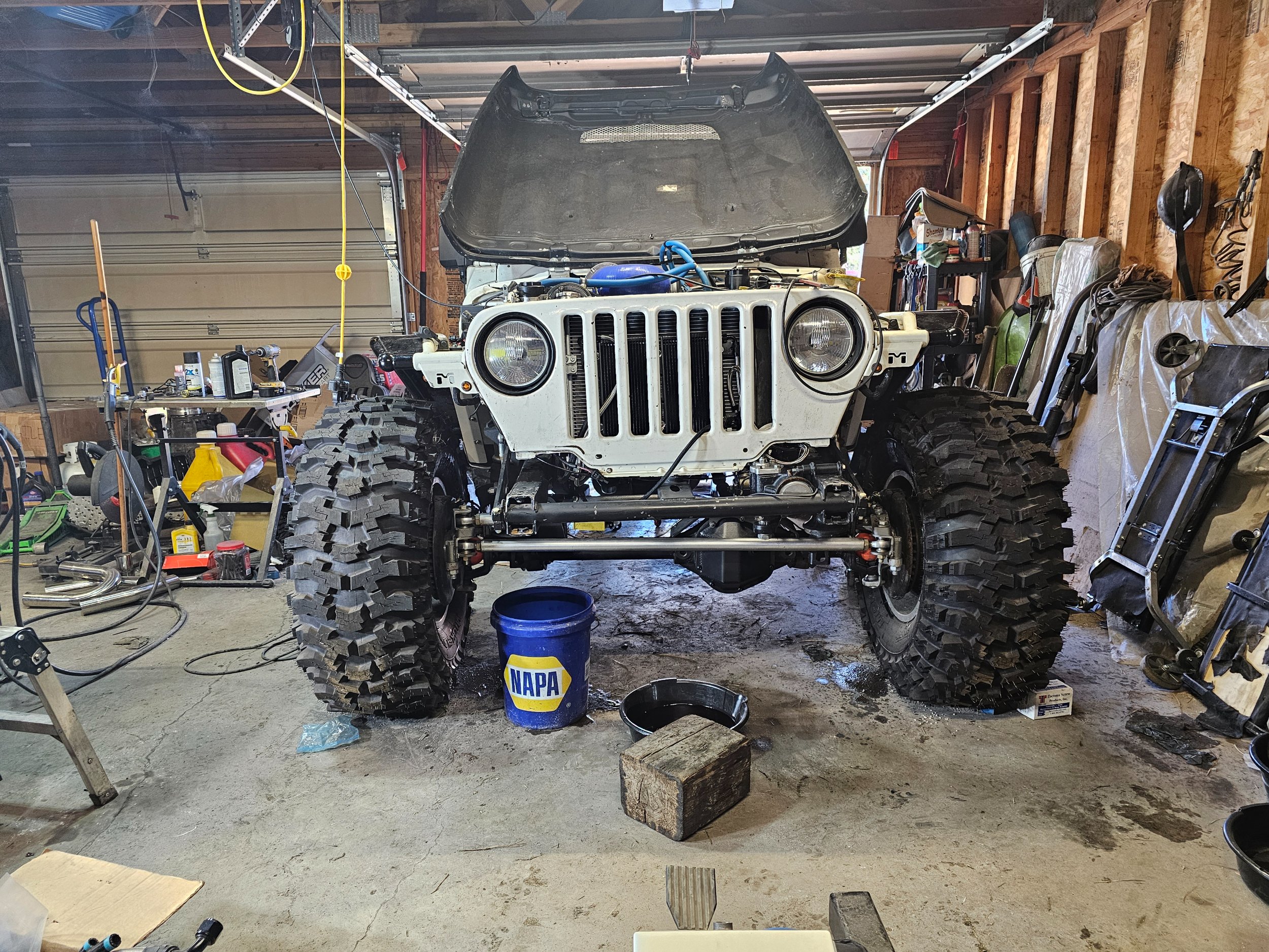

Wildman's TJ is getting a face lift

Made it to the end of the driveway...
Then brought it back up to the garage 🙄.
Swept the floor before bringing it inside... guess it didn't like the clean floor.
Found the problem after just a little looking.
About the same time that hose let go this one blew out also.......
I think that hose isn't rated for 150 PSI? Or I'm pushing it at 150 PSI. It's bypassed for now.
I'll make a new line for the Hydro-Vac return and start over again.
New Hydro-Vac return line made. Ran this one over the top of the reservoir bracket. The previous line had a sharp bend in it when I had it running under the bracket. Which is why I think it blew.
Got to relook at the brakes. They're still softer than I'd like.
Edit: I was mistaken, it wasn't the return line but the pressure line from the pump to the Hydro-Vac that blew.

That's odd a return line blew. Various pickups I've had with hydroboost used a hose clamp to keep them on.
I've had trouble with that style of fitting you're using on tractors. I kept fiddling around until they hold for some reason?
