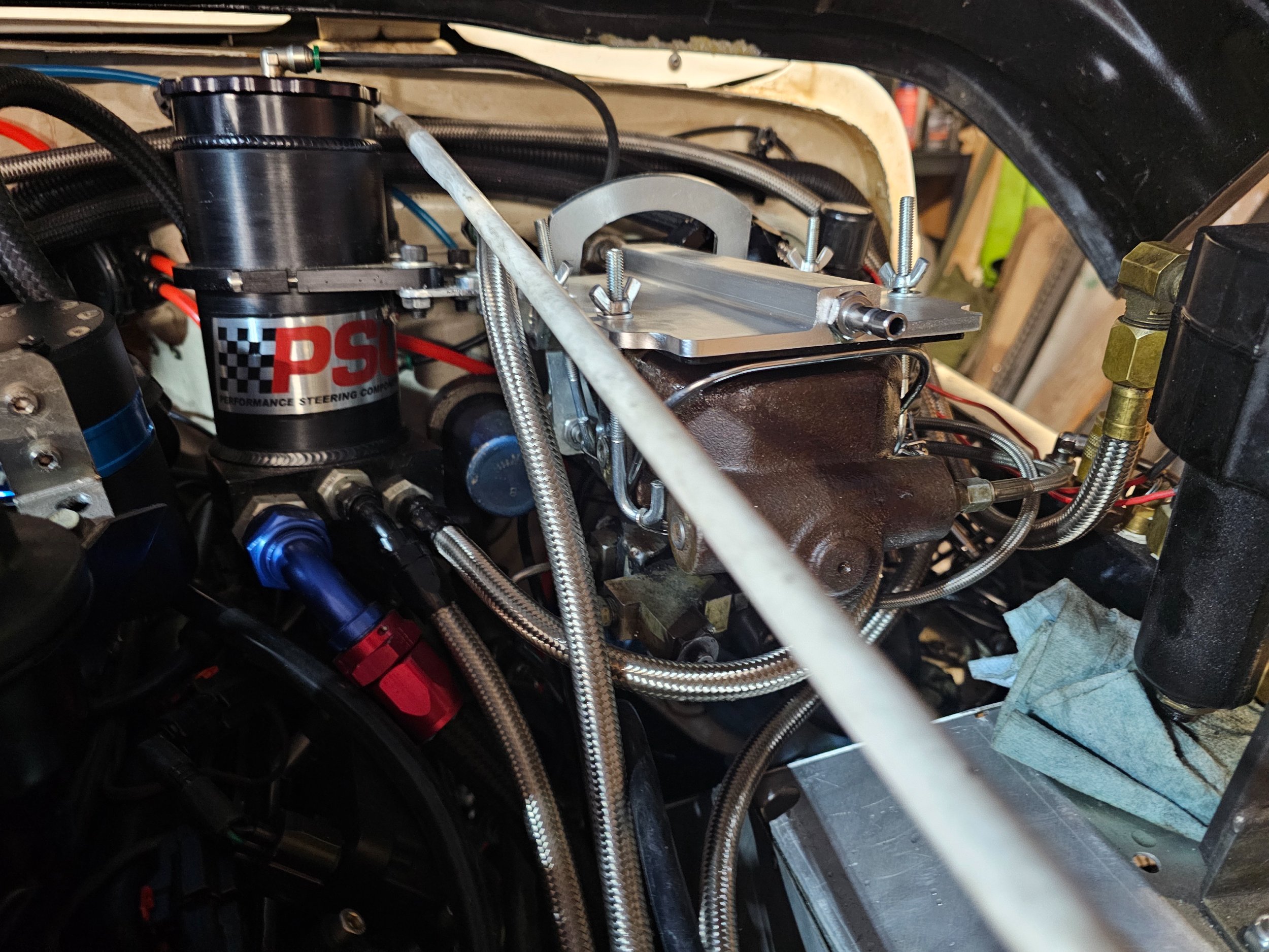

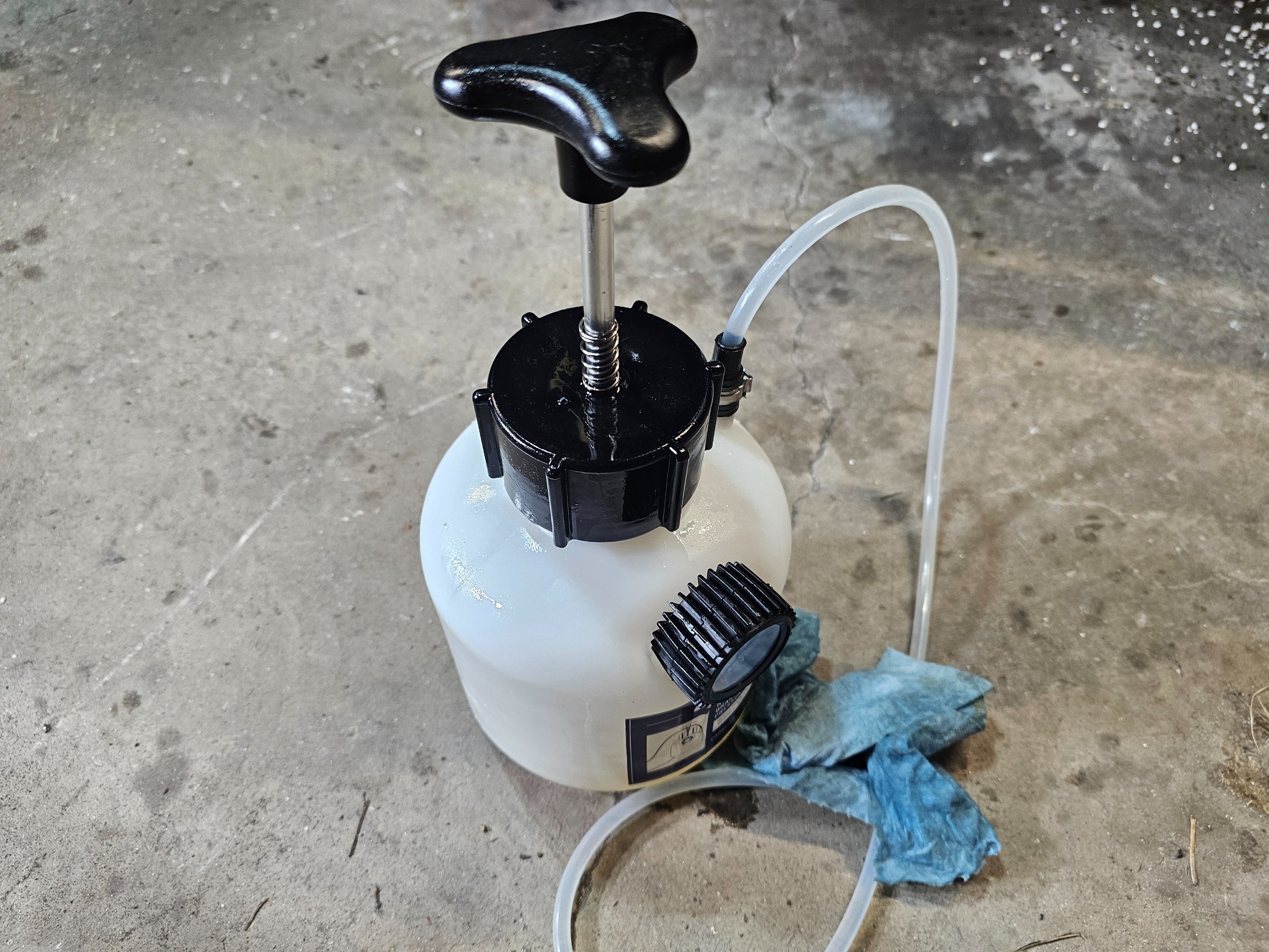

Well DAMN IT that pressurized brake bleeder was a major FAIL 😳.
The pump on the bottle leaks.
And I'll be damned if I can get the master cylinder cover to seal properly.
Wasted 2 quarts of fluid at this point.

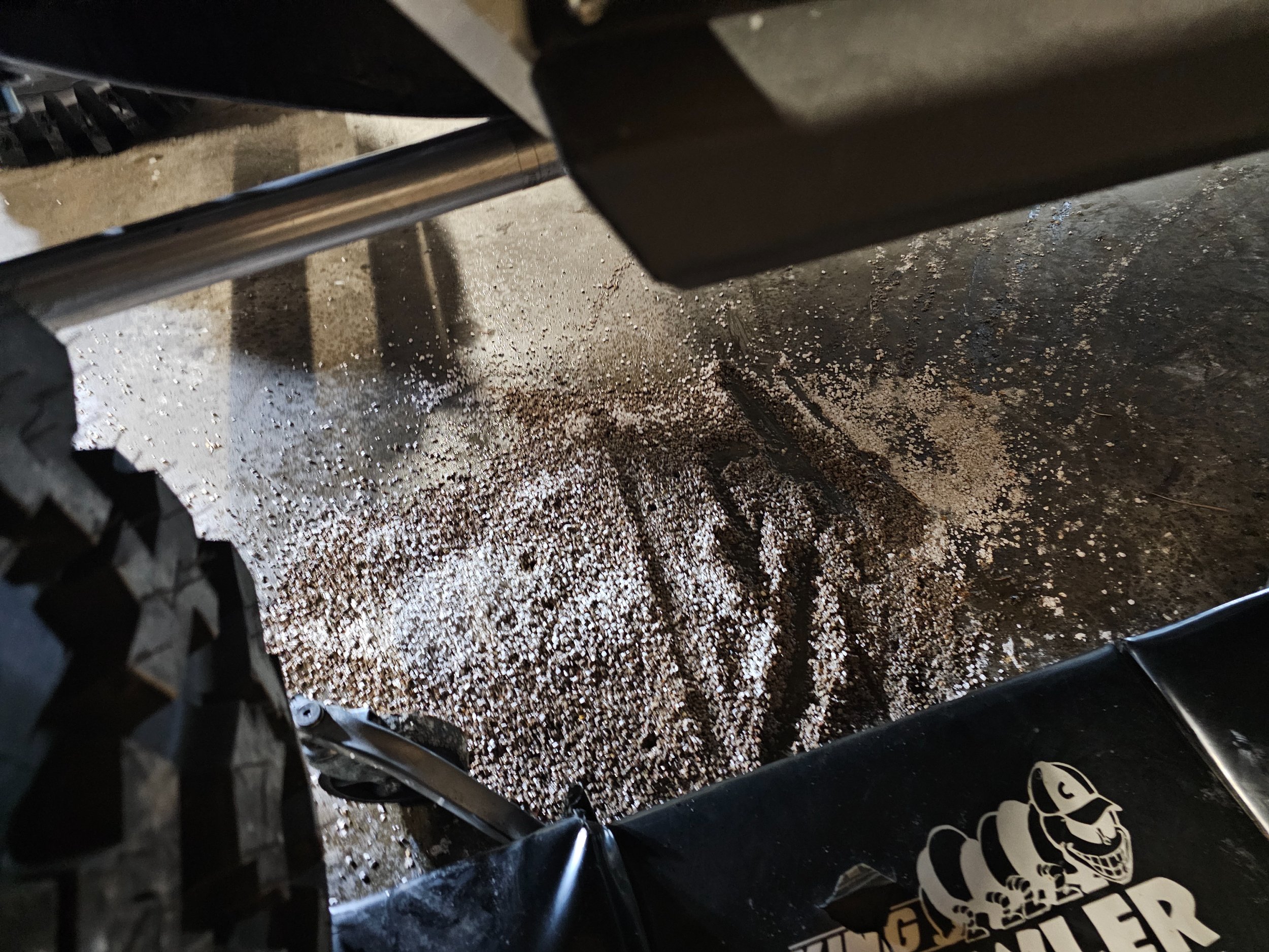

And have brake fluid all down the side of the Jeep.
So it's going back to Amazon.
Going Off & ON plus when I was bleeding the brakes it seemed like I wasn't getting as much fluid out of the rear calipers as I was the front.
Same exact problems I was having. I bought the BMB tool and bled them again. Problems solved.
The shuttle valve moves when there is a pressure differnce between the front and rear systems, shutting off flow to the system with less pressure, and setting off the light. If the light is going on and off, the shuttle valve is likely working properly. That may point to air in the rear lines.
To properly bleed, you need to “disengage” the shuttle valve using a tool like Blaine’s.
It’s well worth the small price tag. Solved my rear caliper bleeding issues.

I pressurized mine and left it for a day to confirm it held pressure. You only pump it to 15 psi.
And you pump it as needed after bleeding each caliper which isn’t needed after each caliper unless you let a lot of fluid out.
