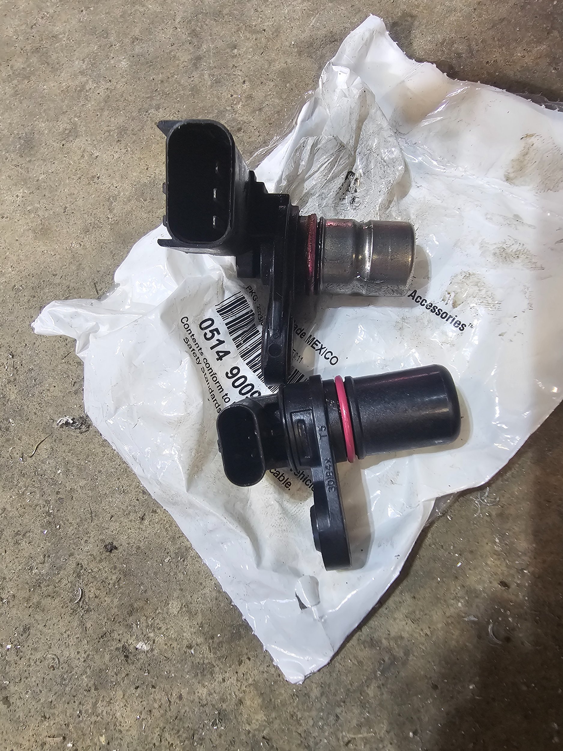

Really want to get this done. New sensors will be here tomorrow afternoon. So should be taking it for a road test Wednesday.

The camshaft position sensor is going to be fun getting at. It's down under the York mount.
The crankshaft position sensor is behind the starter on the passenger side. Since I was pulling the exhaust to install the heat shielding it's easier to pull the starter with the exhaust removed.
