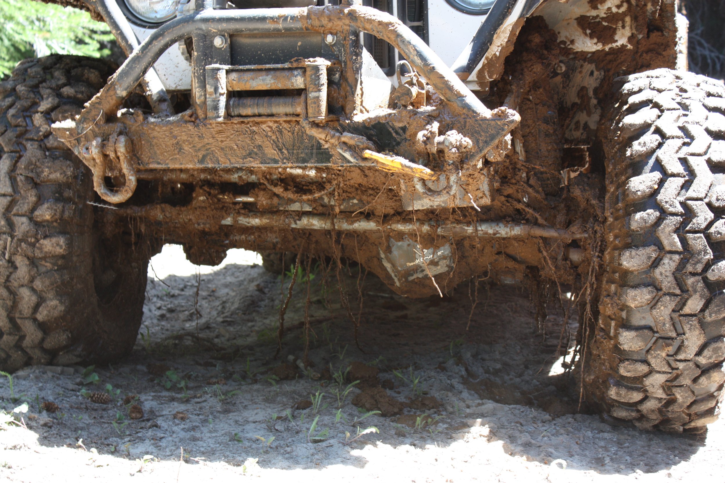

I really dislike the cleanup afterwards... But it's the dried mud falling in your face for the next 10+ years that really gets to me. When I just replace the door seal on my drivers door I was vacuuming and blowing mud out of it that's been there for 12+ years.

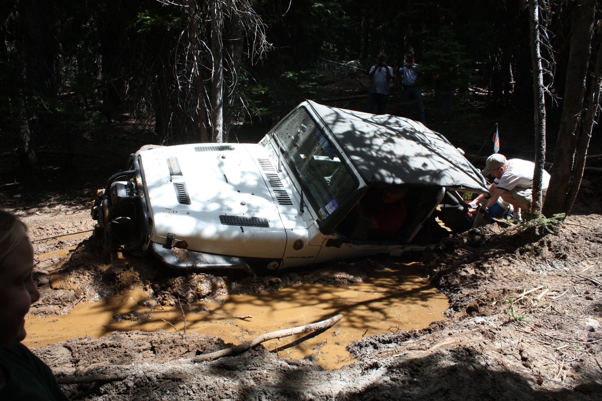

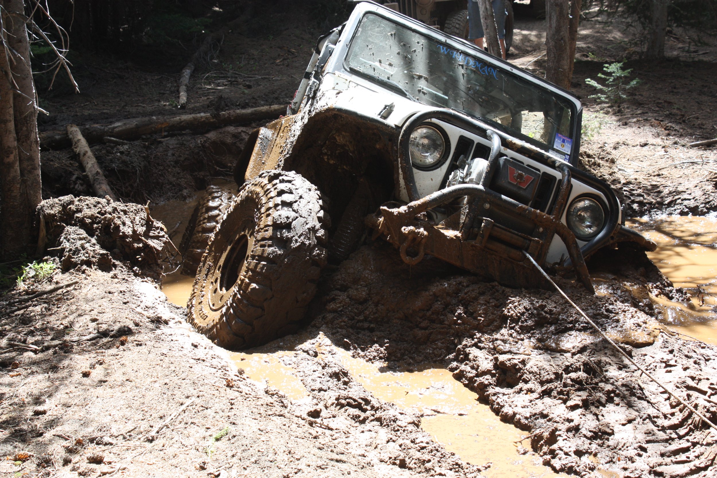

I got plenty of muddy pics of my own… Mud is a part of life, wheeling up here.

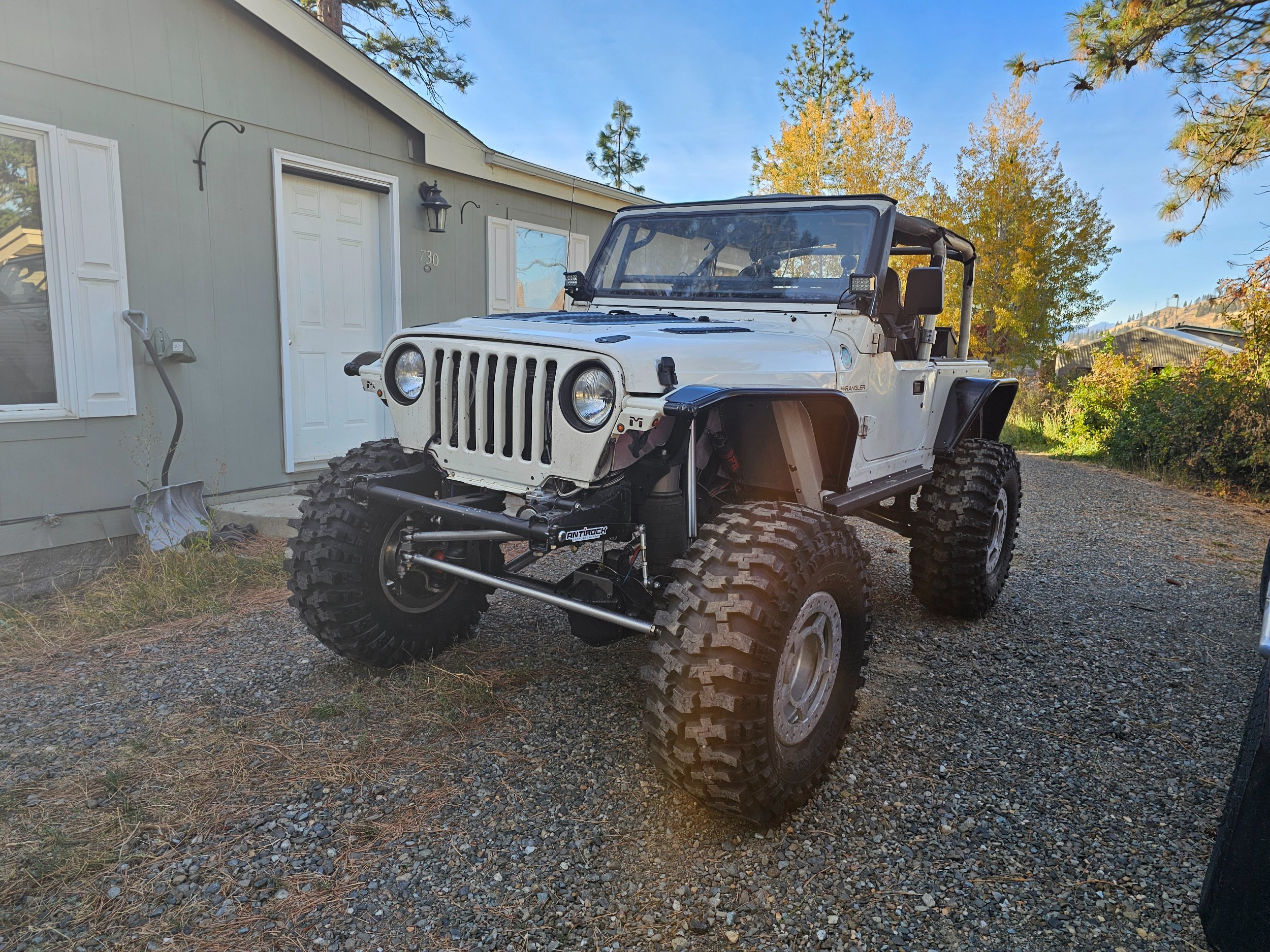

Oops got a little too close to the doorway yesterday when I was pulling out of the garage.

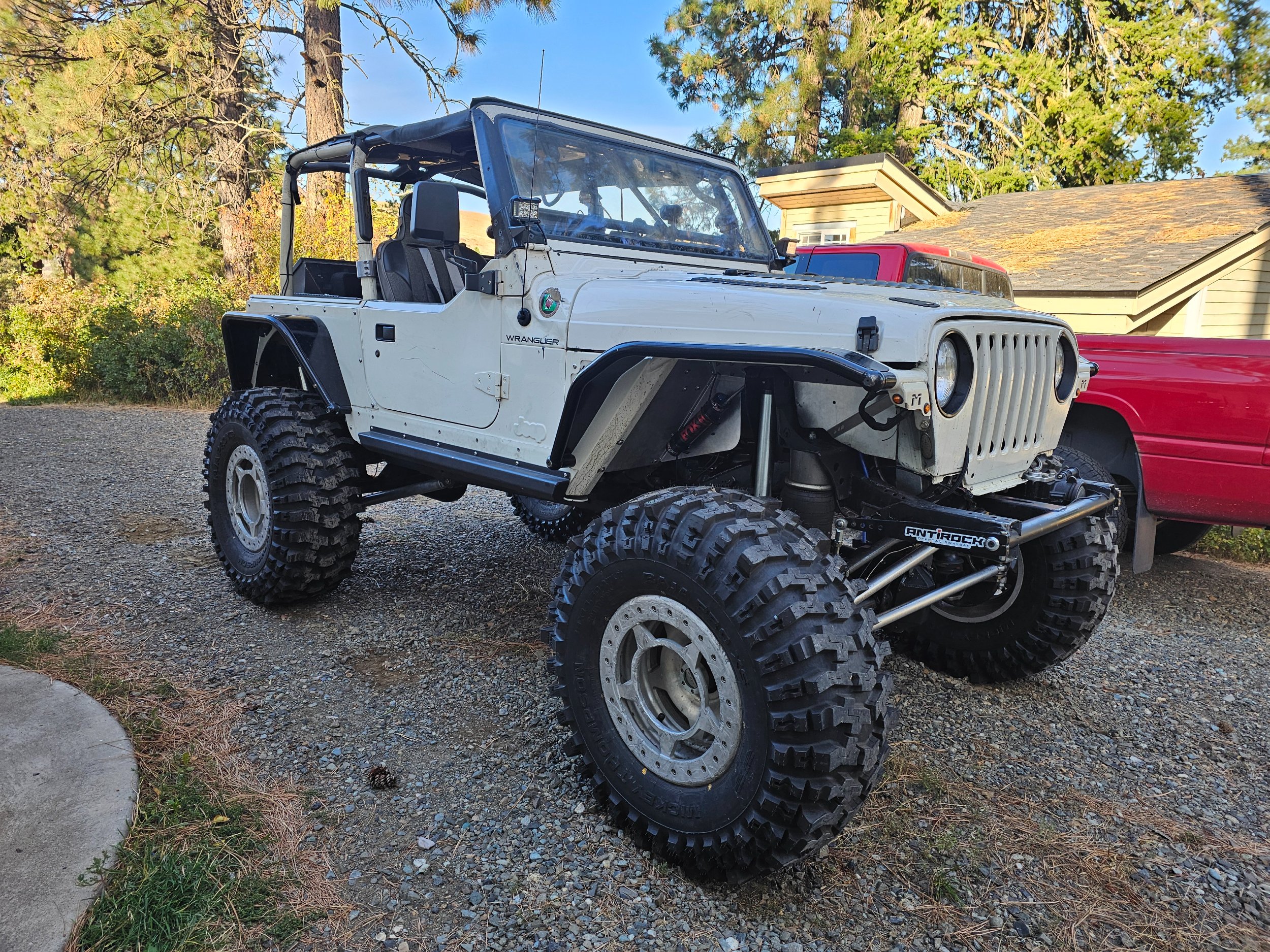

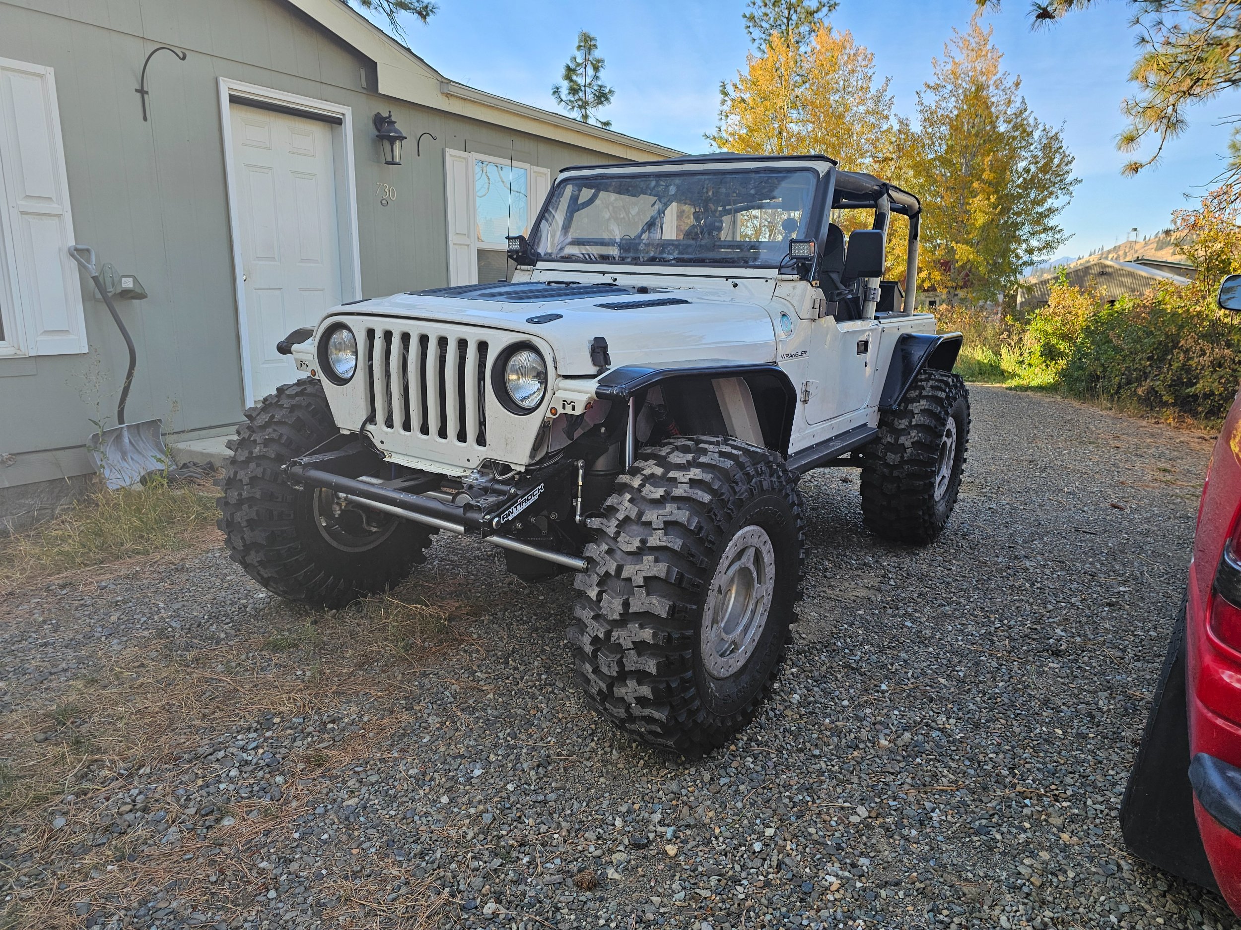

That thing looks so good and super mean. You must feel pretty darn excited to get that thing on the trail. I've been watching this thread religiously for years. Nice work, I can't wait to see wheeling posts! The hemi also sounds killer
Thanks and yes it feel good to finally be getting close. If I can just get these pesky little issues fixed I'd be ready for that shakedown run.
How do you like the sidewinder shifter and the console layout so far?
So far it's not bad. It does take some getting used to since I was used to the stock shifter. I love the console other than losing the center storage & the arm rest. But well see once I've spent a day on the trail what it think.
The clicking thru the gates takes a bit of getting used to. But I like it once it's in each gear. You know it's there and it's not going anywhere.
I'm not sure if I could have put the O/D switch somewhere else that would have been better or not. Maybe should have spent a little more time sitting in the drivers seat prior to drilling the hole for it. But I can find it fairly easy now that I've drive it a few times.
