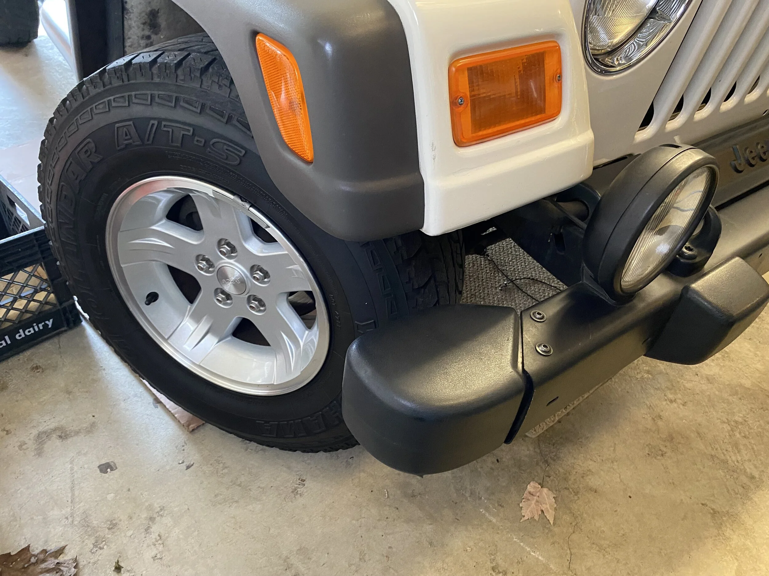

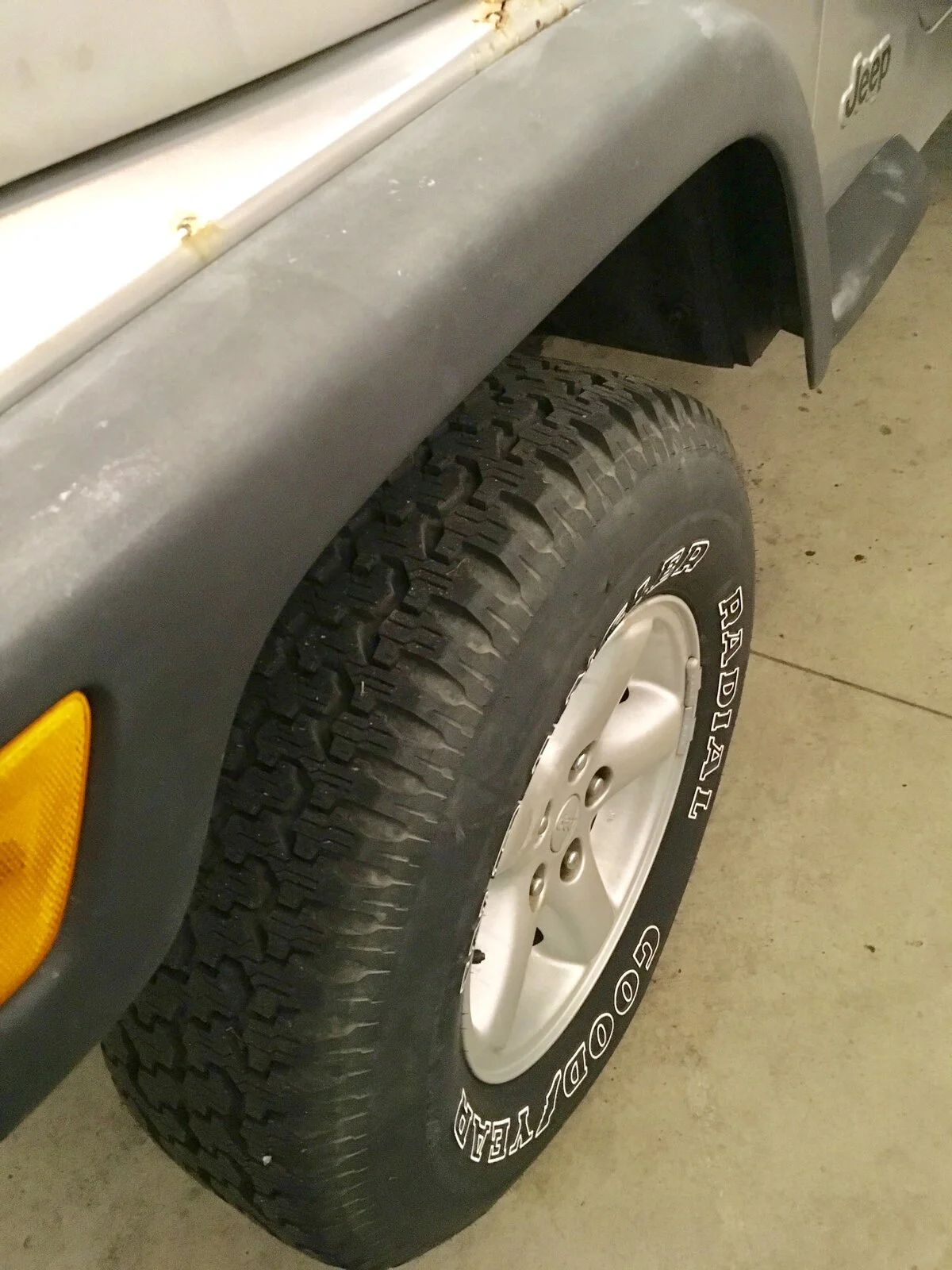

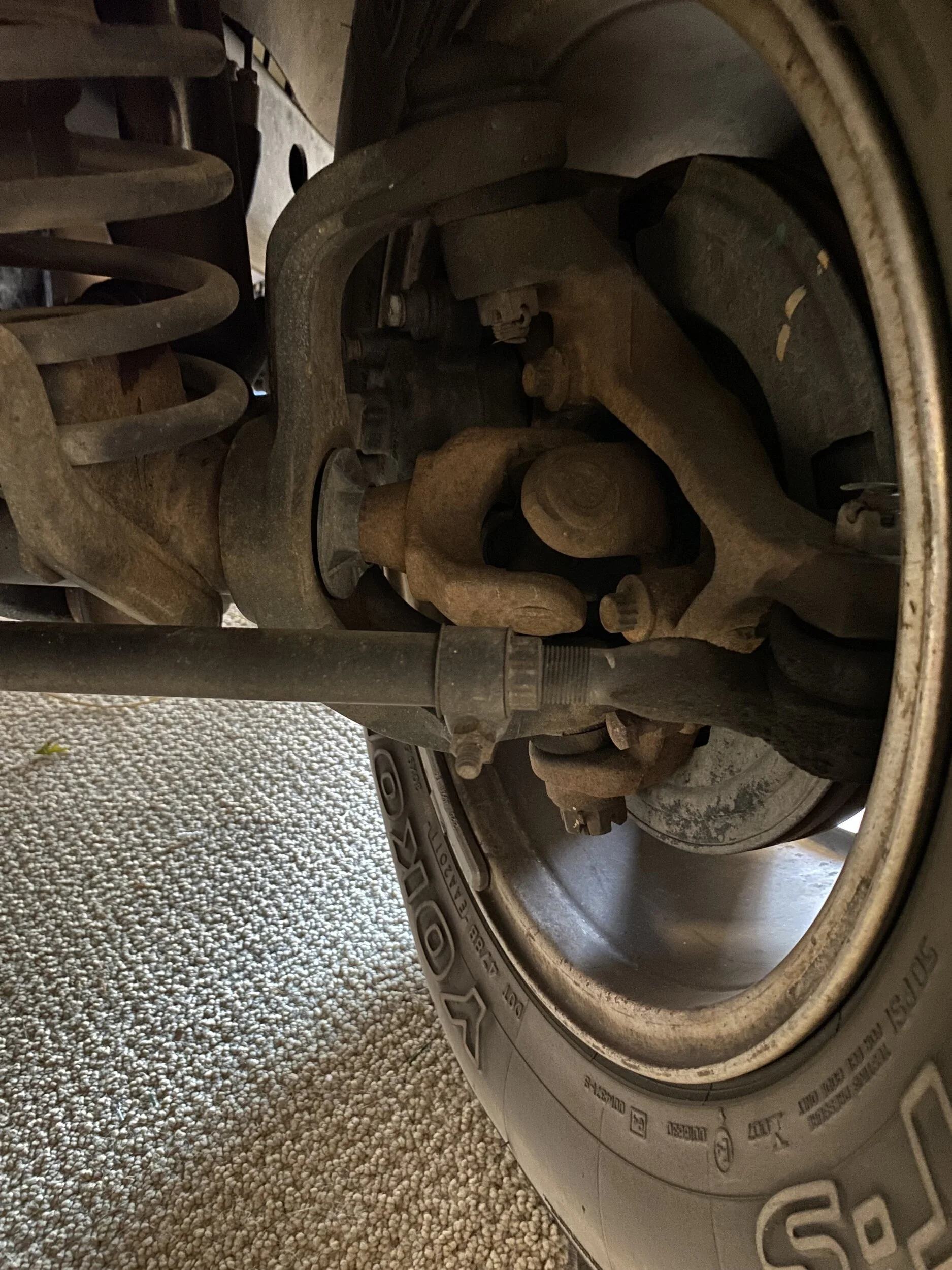

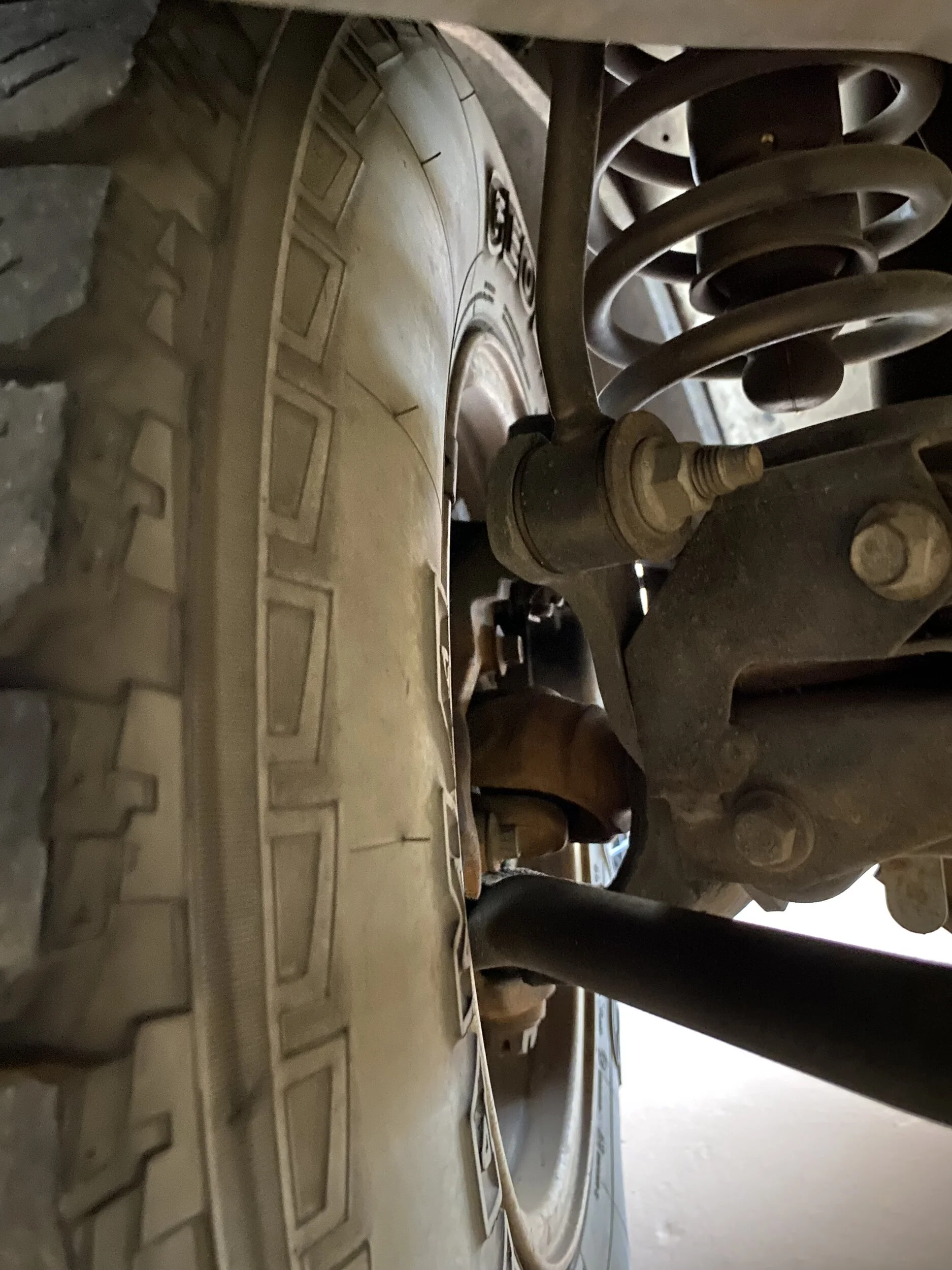

Sure ,the stock tires were the 30 inch 9.50 x 15 on the ravine rims. It’s got 225/75/15 on it now. With geolander Ht on it. With about 1/2 clearance on steering at full lock.
Ravines.

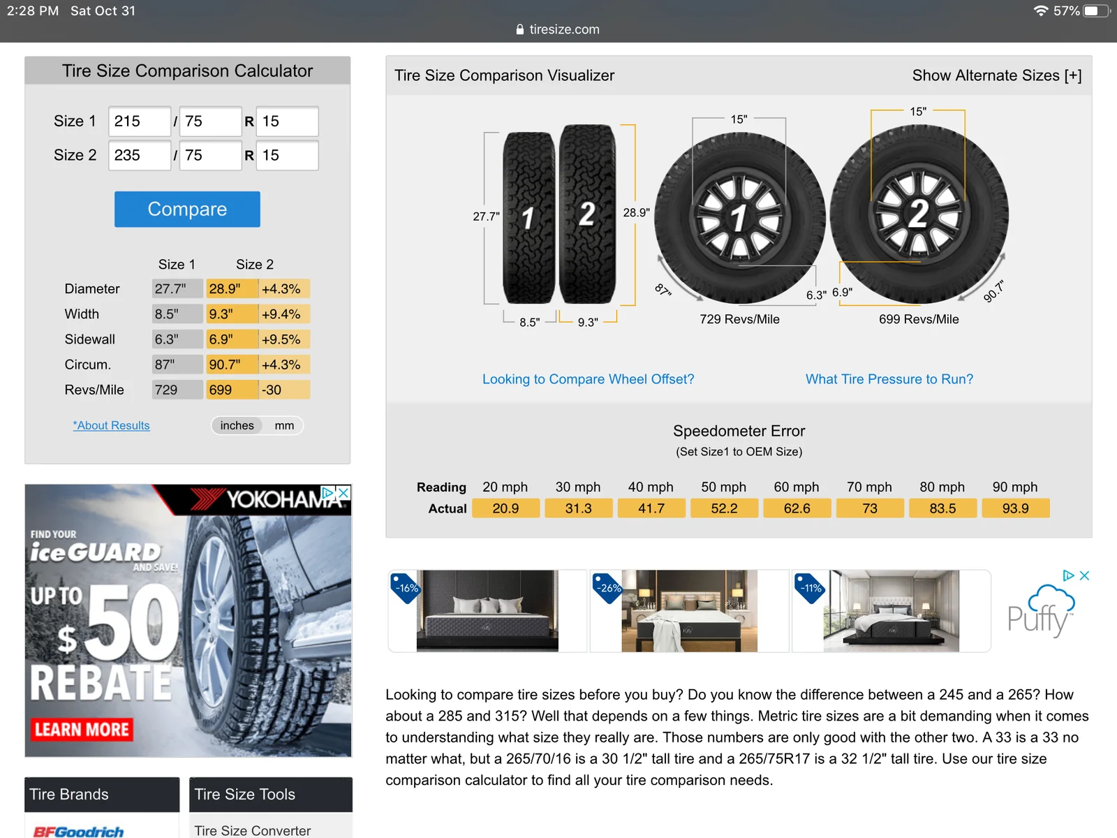

https://tiresize.com/tiresizes/235-75R15.htm
