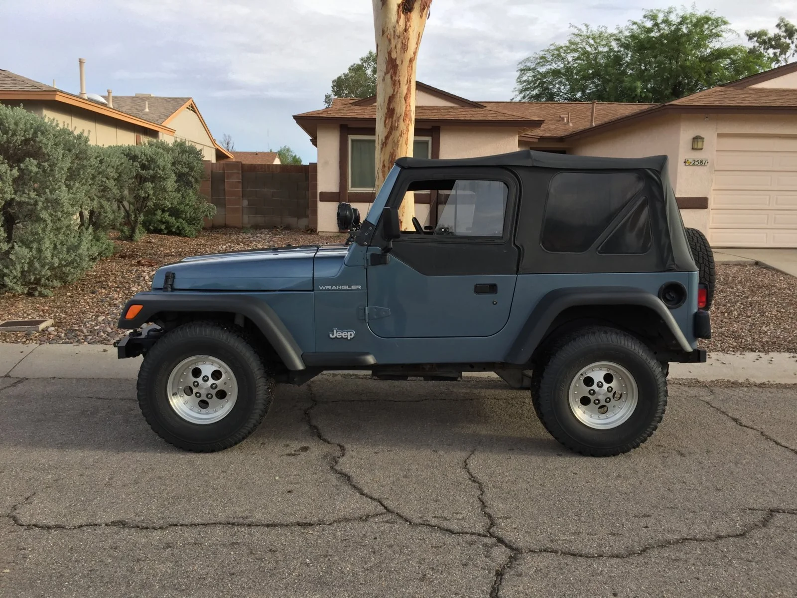

Thanks for all the help. The rear actually has a 2" suspension lift on it, so I'm not worried about the rear end. But the front end seems not much higher than stock. I may go and get a leveling kit to lift just the front end up by 2". That way, no rubbing and it will sit nicer.

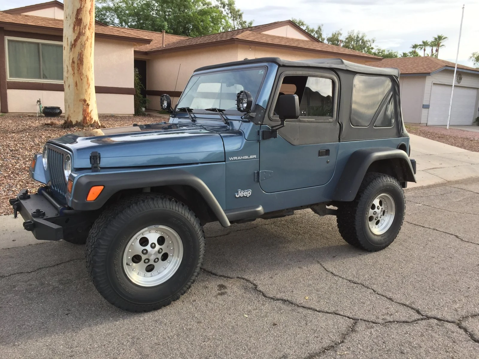

I went through with the purchase last night and got the set of 4 wheels with 32x11.50r15 tires mounted. I put the new tires on and have tested them out. Even at full turn, there is no rubbing! I doubt I will be able to do any kind of serious off-roading. But I have plans in the very near future to get a 2-3 inch lift installed.

Turn the white letters out!! Looks good with the new shoes tho. I like the color of your Jeep. I had an oppurtunity to buy a similar color JK (2007) but I passed on it. because I really wanted a TJ.
