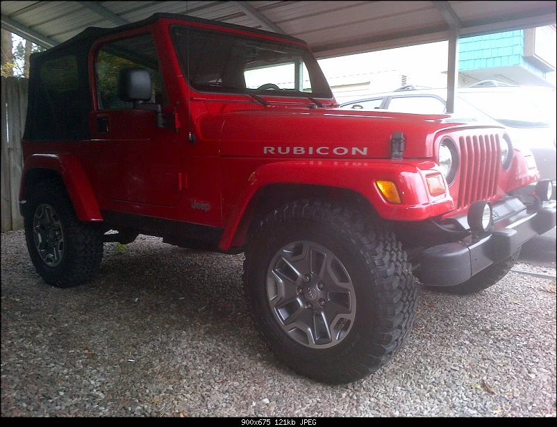

This is what it would look like with no lift.
