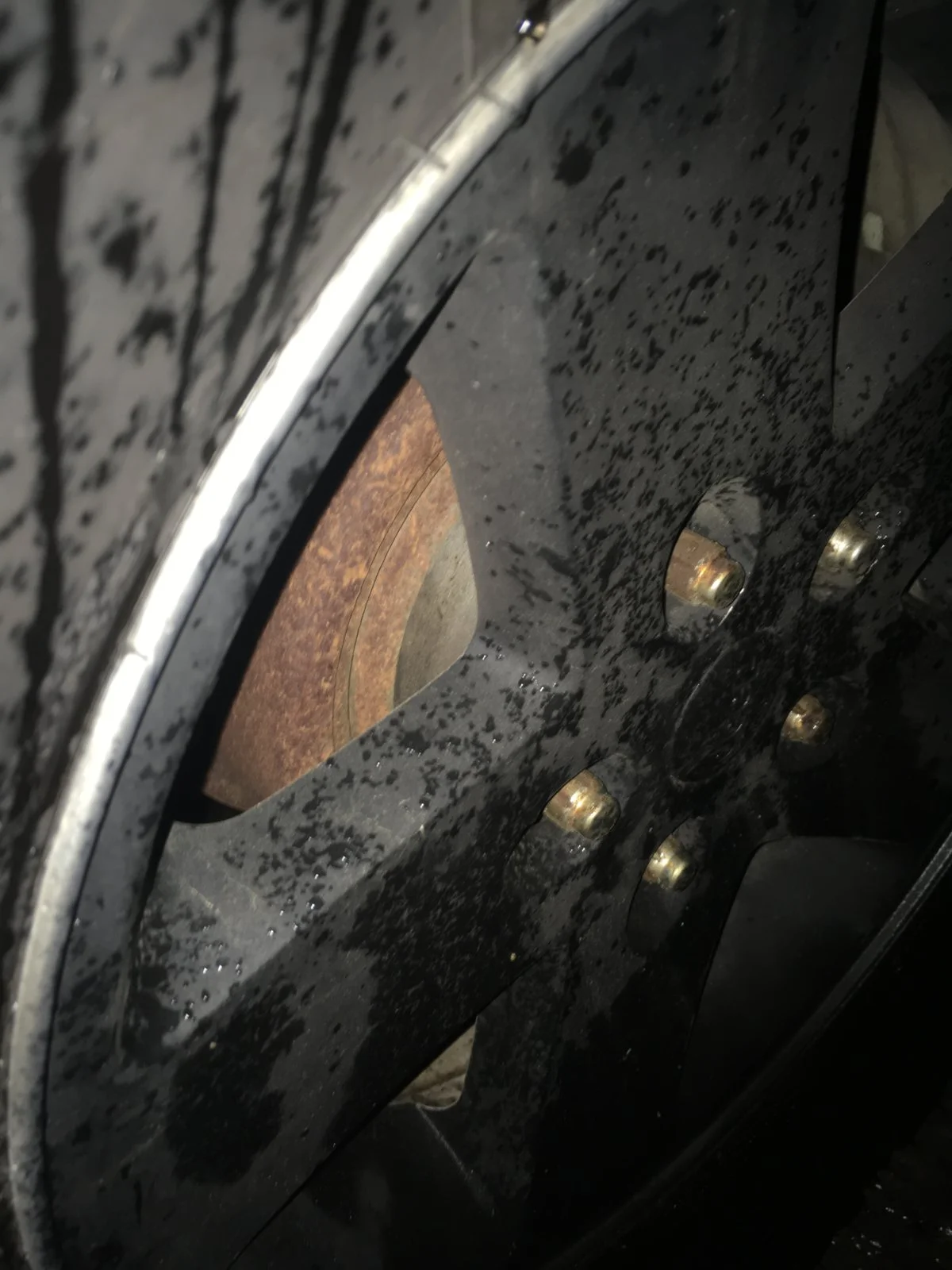

I know that the previous owner put a 1 1/2 in lift and then put the 17s. Not sure how to check if she put 5x5 adapters
I have this adapters on my jeep, in the picture I posted, the rusty part is the drum, and the rim is black, but that silver section between them is the spacer/adapter.
Kind of hard to see.
Reactions: JMT
Cool! Welcome to the Jeep family. THe wheel adapter/spacer going from 5x5 bolt patter to a 5x4.5 pattern will definitely make them work! Tires would work too without a problem
Thank you guys! The adapters work and I got newer stock rims on my baby!
